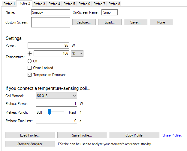

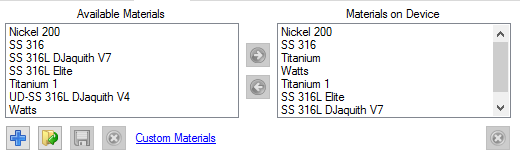

Right ... been a busy bunny.. Built a dual coil build exactly the same as the Snapdragon but for the dual coil deck of my Merlin - 2.5id .50 7 wraps SS316L Switched to Merlin profile - no TC - kept saying "OFF" on screen. But I noticed that it wasn't displaying "Merl" where the profile name should be (on the mod) So switched to the Snapdragon profile, which is in effect exactly the same, and TC is working, and displaying "Snap" on screen. So seemed as if the Merlin profile was corrupt or something. So I saved all the profile settings and did a re-install of the service pack. Re-did the materials list, and added back my 3 atty profiles. And it all seemed to be working correctly ! First thing I noticed is that after having a puff, the mod is flashing up "Temperature Protected" never seen that before !! After vaping it for an hour or so, I decided to test it properly, so I removed the Merlin, switched the profile to the Goblin profile and gave it a go ... all working fine .. Removed the Goblin, switched profile back to the Merlin ... nope, back to "OFF" and not showing "Merl" on screen ! Pulled a battery, left it for a minute, re-inserted said battery, and then the profile name is displayed ? Vaped it, and immediately noticed that the vapour output was a lot more "powerful" at the same temp. To get it back to the same output, I had to reduce the temp down to 127c from 170c So apart from all of the other oddities, it seems that the TC is all over the place ! I don't mind too much having to re-adjust the temp, but I'm guessing this shouldn't be happening ? On a positive note, since doing the service pack re-flash, I no longer get the "Battery Check" message when connected to my PC and using the Device Monitor" ! So there must have been something a bit fubar with the factory firmware ? Anyway .. I'm 80% happier now, and as I only swap atties twice a day (work\home) I can live with these little quirks. Thanks to all for your suggestions and help, I can't make my mind up if I need to raise this with Lost Vape or not ? what's your thoughts ? Many thanks Damian Update: Arrrgh !! left it alone for 20mins, went to vape it .. nothing coming out, had to put the temp up to 222c !! what the flock is going on with this SS I'm not getting this with titanium !

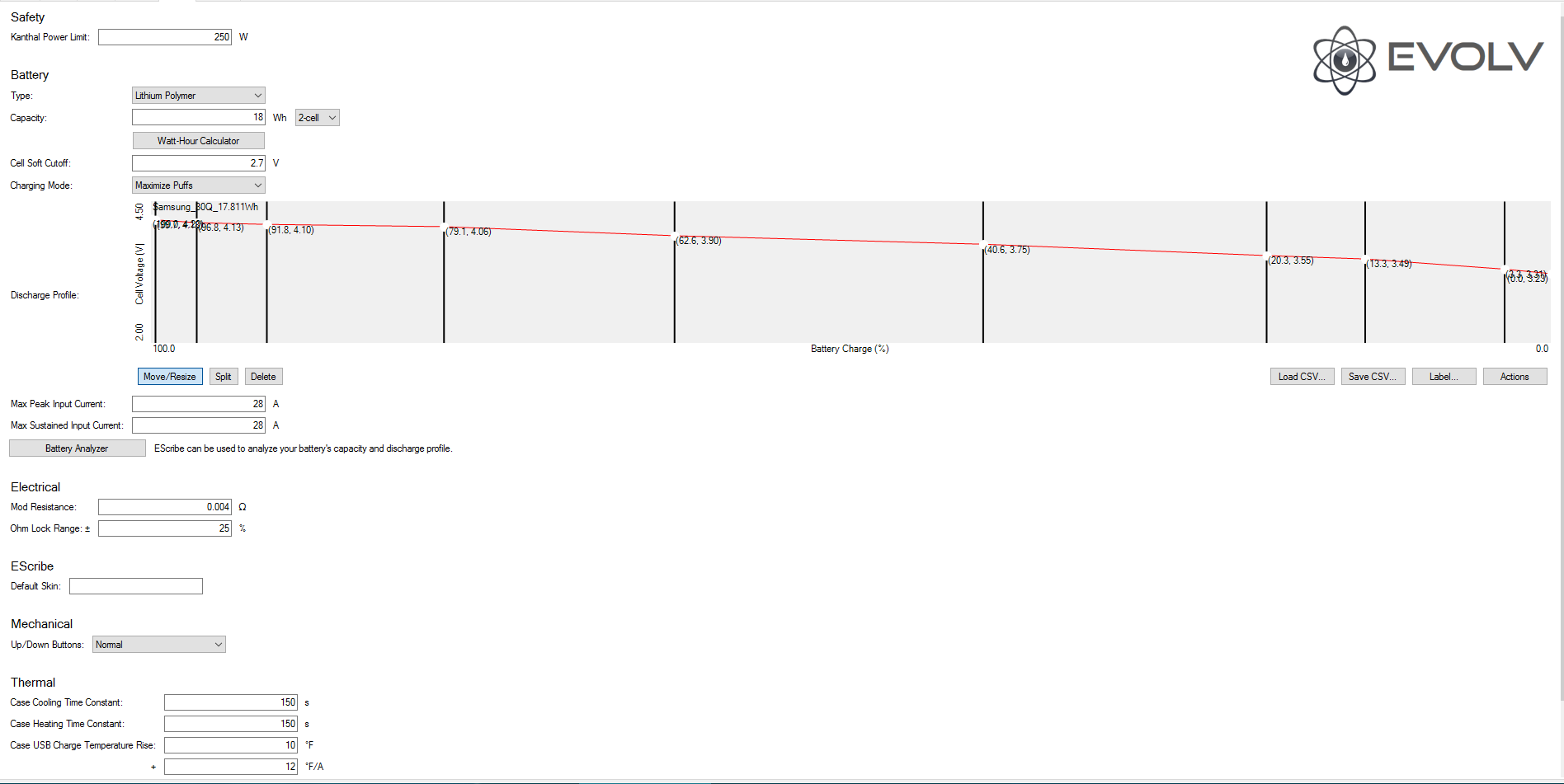

Is that the "Max peak input current" & "Max sustained input current" ? it won't accept zero, goes to 1 only, this would still be a 1amp charge wouldn't it ? I don't see USB current mentioned anywhere. Cheers Damian
OK thanks agian guys, I've now done the case analyser and got some device specific settings in there. going to do a few different types of build tomorrow and raise the power up as suggested. won't do it now got blurry eye syndrome (may be cause by a bottle of wine !! ) Still getting the Check Battery msg at the mo, but will see what happens when i limit the charge rate and with different builds. Cheers all Damian

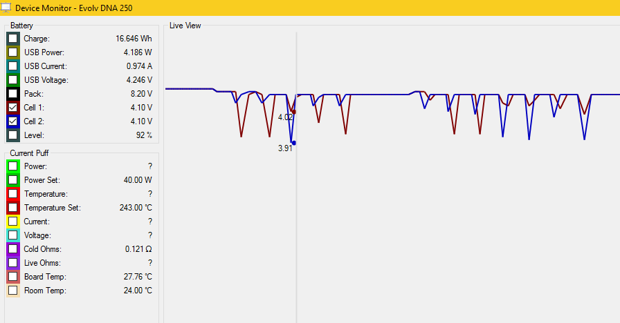

Thanks Guys for the responses. I'll answer to all: @retird Yes pretty much, disconnected from USB,pulled out the 30Q's and put a set of HE 2's LG ? - the brown ones ! .. plugged USB back in, fired up EScribe & Dev Mon , same result. @giz_60 - OK cool i'll drop them an email .. I don't do FaceBook (don't get me started on that!) Thanks @dwcraig1 - hmm hadn't thought of that ! I'm at work now, so will have a dig around to find a decent one, I have one in my draw but it's only 750 mA And yes it's displaying an error when plugged into a USB cable - PC Cheers Damian Update: So tried dwcraig1's suggestion, found an Apple USB charger with 2.3A output, plugged in the Therion with the Merlin tank with a newly built single SS316L coil, 0.31ohms, fired 6-7 times correctly with only 1 instance of the "Check Battery" error ! Plugged it back into my laptop, and ran EScribe - Dev Mon .. all good ! Had to nip off for ten mins, came back tried it again .... "Check Battery" grr , plugged it back into the Apple charger ... "Check Battery" So the only conclusion I can make is that no conclusions can be made from any of these tests !! Which I suppose does point more towards an iffy connection or something in the device. I will email Lost Vape and see what they say. Cheers Damian
Hi ChunkyButt200, I've done a bit more playing :- see my other post about SS316 TC /topic/65876-topic/?do=findComment&comment=891797 But on top of trying a different coil\atty setup, I have also tried a set of LG batteries to rule out the Samsung's. Things got even weirder, I got the temp reading back on the device monitor, but only after repeated presses, but the temp reading shot down to minus 50 or so when the mod actually fired up ! Also after I disconnected the mod, it was totally unresponsive until I removed the batteries and re-inserted them. From what your saying and my test, it does sound like something is very wrong which is a shame since i've only had the Therion for about 2 weeks. It looks like the Lost Vape Repair centre is for US customers only, so I guess I'll have to contact the company i bought it from. Thanks for all of your help. Cheers Damian
OK so done some more testing .. Did a single coil build on my Merlin .. 2.5mm id 7 wraps .50 SS316L came out at .27 ohms. Used the same profile as the Snapdragon, and TC works correctly. Reduced the temp down to 170c - barely any production, upped it to 222c and it's producing just what I want. So .. is it my Snappy .. I don't think so as it was working well with titanium. The only thing that's really changes is the resistance .27 rather that .19 .. would that really make this much of a difference ? I'll build a dual 9 wraps that should come out at .2 ish - see what that does Onwards and downwards !

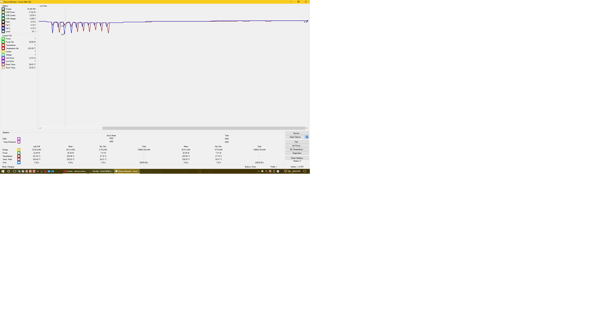

Here ya go giz_60 & Wayneo I've tried all 4 SS material versions I have, all do the same. Just looking for another USB cable to try, once found I'll try to do a dump of the monitor. Cheers Damian

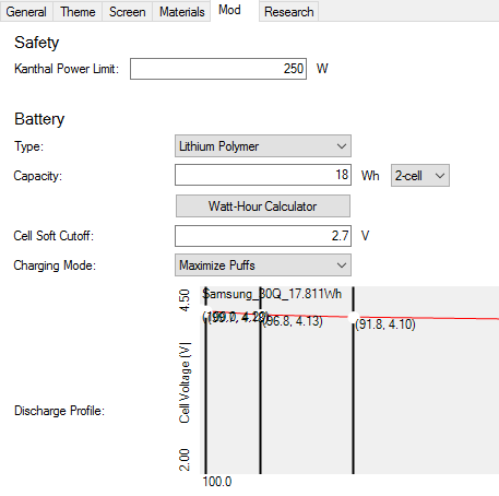

Hi ChunkyB, CSC is set at 2.7 The only batteries I use with the Therion are Samsung 30Q 3000mah - 2 sets of. psb Thanks for your help on this btw Damian Sorry that pic of the monitor is rubbish, i'll do another one !
