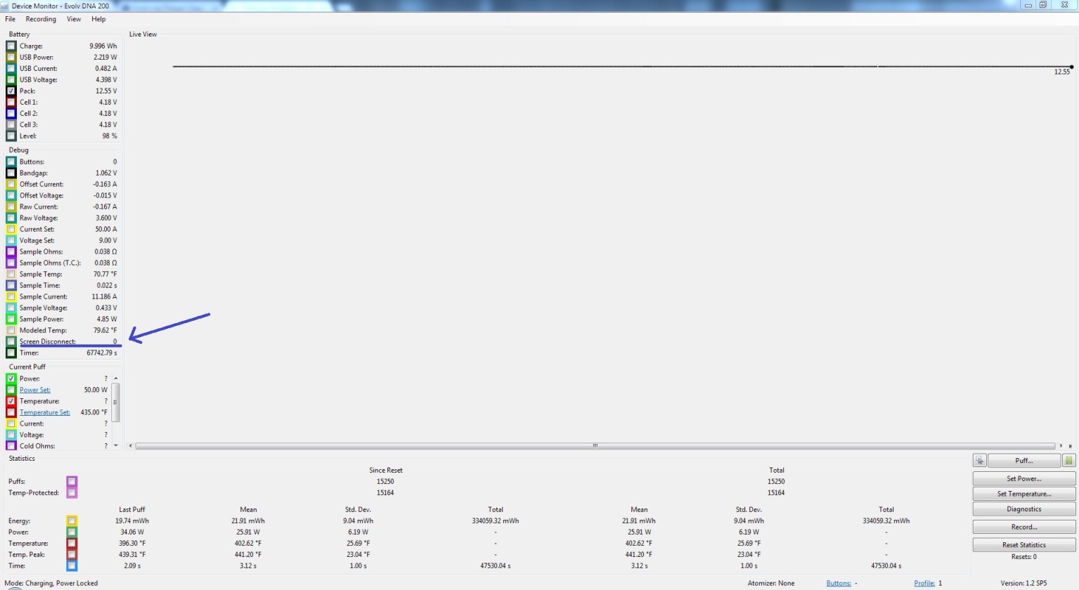

Willy Posted February 9, 2018 Report Posted February 9, 2018 51 minutes ago, WickedJack said: Yep ! Here you go Let me know if you would like anything else checked off Thank You EDIT: These are the only 2 things that were already checked when I opened Escribe. I'm still figuring out how to use it obviously but if I may ask what is the option under Tool/Diagnostics, Perform USB Recovery Charging ? What does this do..? Your screen shot shows the screen disconnected 163 times, likely the power button has pinched the flat screen cable. Below is a screen shot of one of mine, I used the windows "paint" program to point out the screen disconnect.
