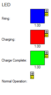

Hello,
How to set the normal operation of the diode (blue), which is only lit when compressed Fire.
How to adjust to shine even for longer after leaving the fire?
Edit: I figured it out.There's one hidden field. :crazy:

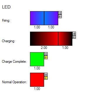

I've got an SMY sdna75 I've got colours set for fire, charging, charged and normal but for some reason it glows a weird purple colour for a couple of seconds after I've taken my finger off a button. I thought this was when the "normal" colour was supposed to come on.... Normal is set to blue; none of my colours are set to purple. Any ideas why it might be doing this please? Thanks folks
Share this post
Link to post
Share on other sites
Fire... blue
Charging... red
Charged.... green
Normal.... (not set)
Those are the setting on my DNA75.... (not a SMY device)
When not plugged in to charge I get no led color until firing...
Upon firing I get blue.
When plugged into charge and I fire I get momentary purple (millseconds) as it turns blue. Charge and charged colors are as set... only time I get purple is when plugged to charge...
You get purple for several seconds???

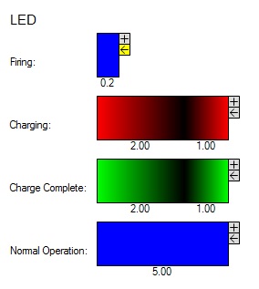

My settings:
Red and blue make purple...
Share this post
Link to post
yep, for a couple of secondsand even if it's not charging (the only option set to red)
I get the purple if I let it go into standby and then press + or - rather than fire
charging is red/black
charging is green/black
firing and normal are the same blue
it's confusing me
Share this post
Link to post
hmmmm
fixed it but I don't understand why.....
I had a feeling the purple is the led's attempt at doing white, so I set normal to this setting:
it worked, the purple light disappeared.
I then removed the 1 second gradient - and still no purple.
Like I said, no idea why this worked.  but it did
Thanks for your input retird, it's appreciated.:thumb:

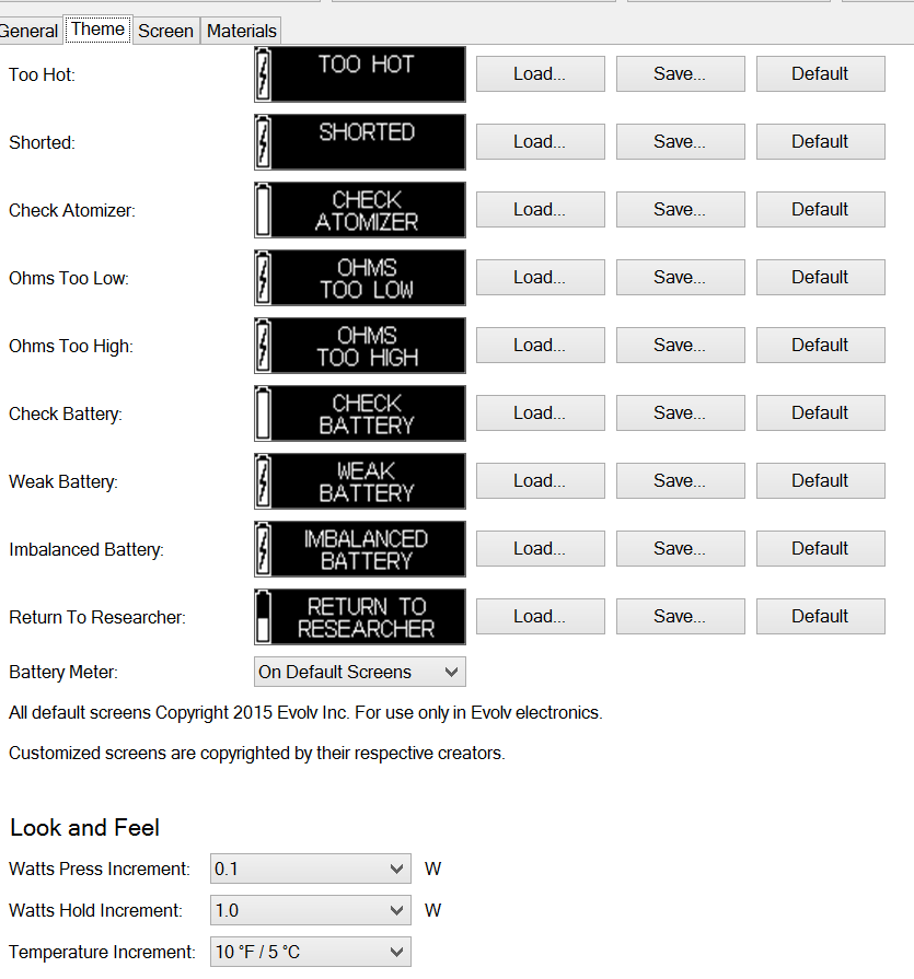

Hi, How does one access this hidden field? I've been trying to find it all day. The very bottom of my theme panel is the field to set temperature increments. Give me the cheat codes (so to speak), please!
Share this post
Link to post

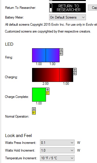

txmonkey.....
this is how my themes tab looks - you've got nothing like this at all?
are you using the latest version of escribe?
Share this post
Link to post
The LED setting are for the DNA75.  If I recall you have a DNA200...
Share this post
Link to post
Yes, I have a DNA 200. Thank you for the clarification. I would love to have this option also available for 200's, 60's, and 250's, at some future point. I'm sure both James and Brandon could use a break, for a while.

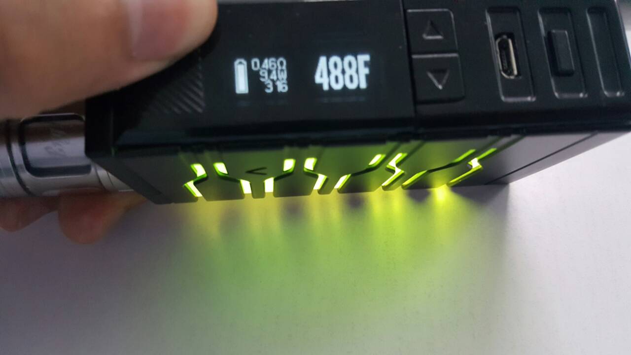

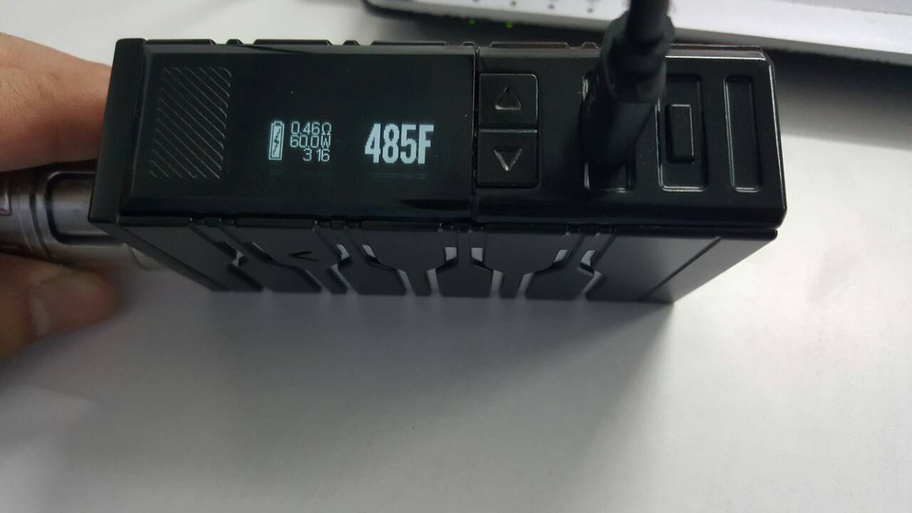

Hi guys,
I have a PUFF Avatar RS DNA75. It has LED on its' body.
In Escribe there is a setting there for changing the color of the LED when: firing, charging, fully charged, and normal operation.
It does not reflect on my mod when I upload it.
I'll upload the image of the setting of my mod in Escribe here and also images of LED light when charging and firing.
Any ideas how to make this work?
Share this post
Link to post
@Dunby .....My best guess (and as the video below shows) is.that device has an external LED for the fire button of which you can change colors with the extra auxillary button on the device.  The external led (not the led of the dna board) cannot be programmed thru EScribe (as stated in the video) as the device maker chose to design his mod that way. He is probably not using the on-board DNA 75 LED for the fire button.  Here is a video about this device.
