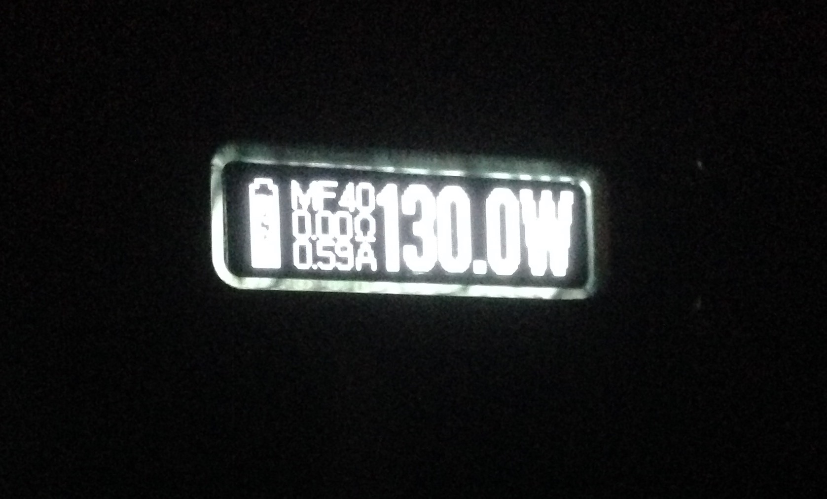

Recently built a DNA 250 with a 5200mah lipo and the board is only allowing .59a input.

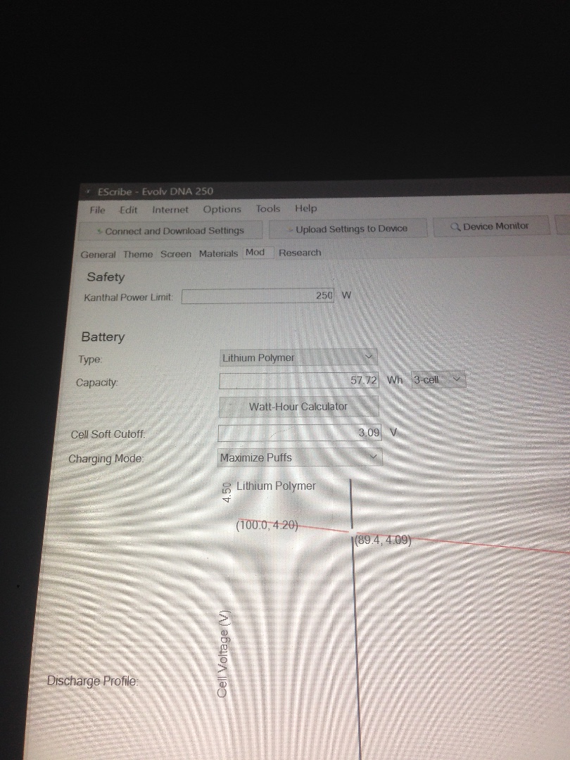

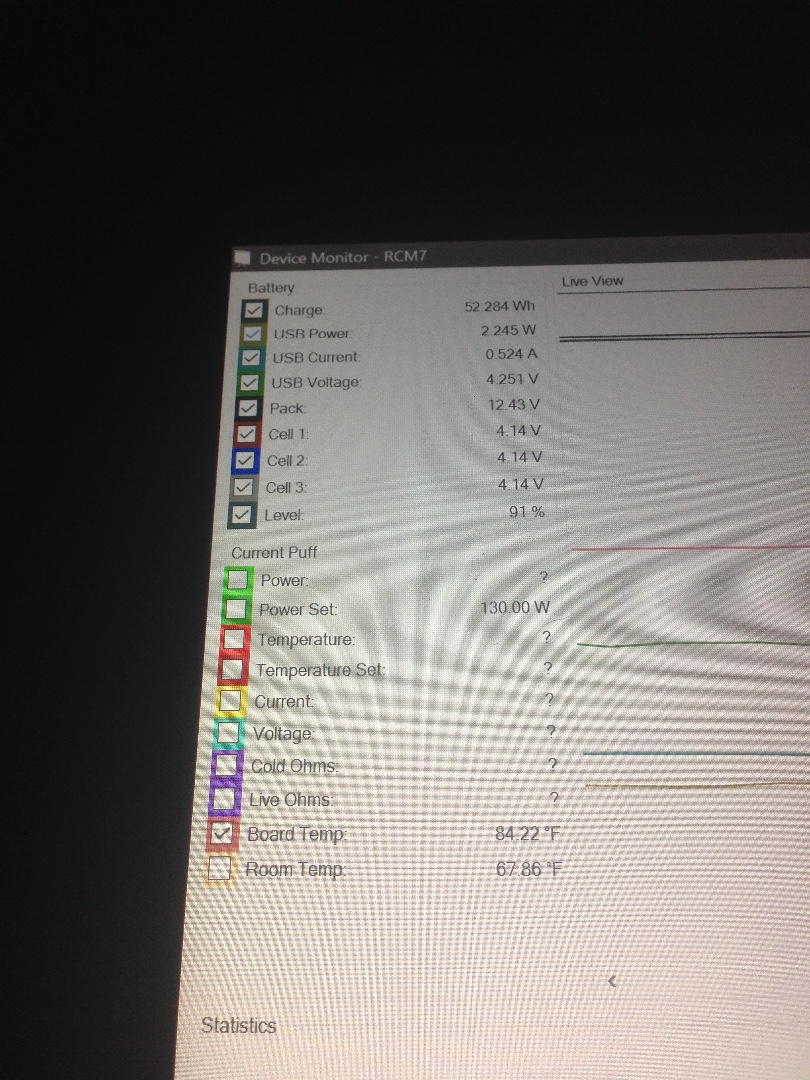

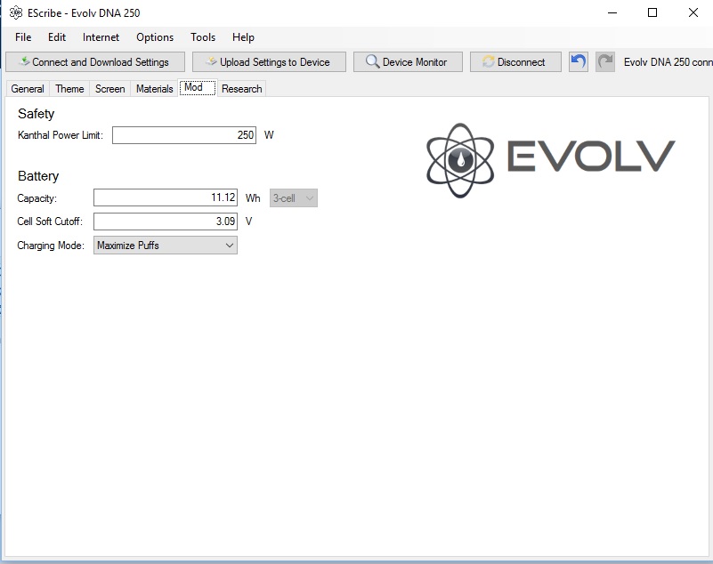

can you post a screenshot of device monitor with the battery options and board temp boxes ticked? also a screenshot of your battery settings. what version firmware are you running?

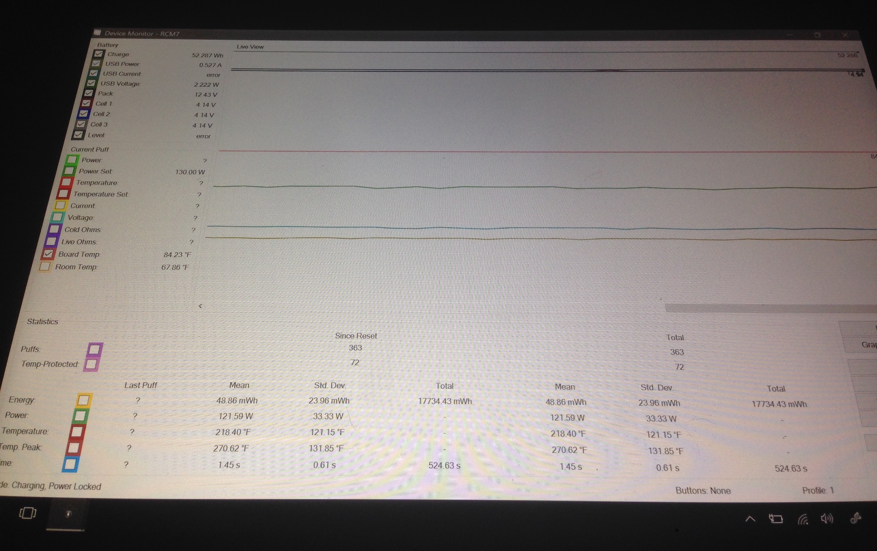

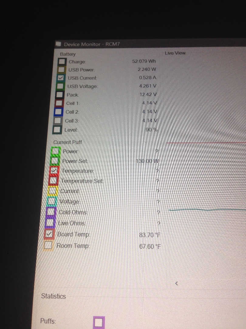

First picture is of board screen when attached to wall charger that has verified output of 1.97a on another DNA 250. Second picture is of battery settings. Third picture is of device monitor with USB current and device board temp checked. Fourth and fifth picture with all battery settings checked. Firmware version 1.2 SP5

RCM Vapes......you lipo settings look fine. your board temp seems OK. your cells appear to be balanced. however, your USB voltage is sagging severely down to 4.26v. when the DNA board sees the USB voltage drop down to 4.27v and below, it limits it's current draw. basically your not supplying enough power to the board. this can be a crappy USB cable, a USB port incapable of providing the necessary power. you should set, through EScribe, to see USB VOLTAGE on your DNA mod's screen and notice the voltage during charging. this will help you pick a good setup (charger + USB cable).

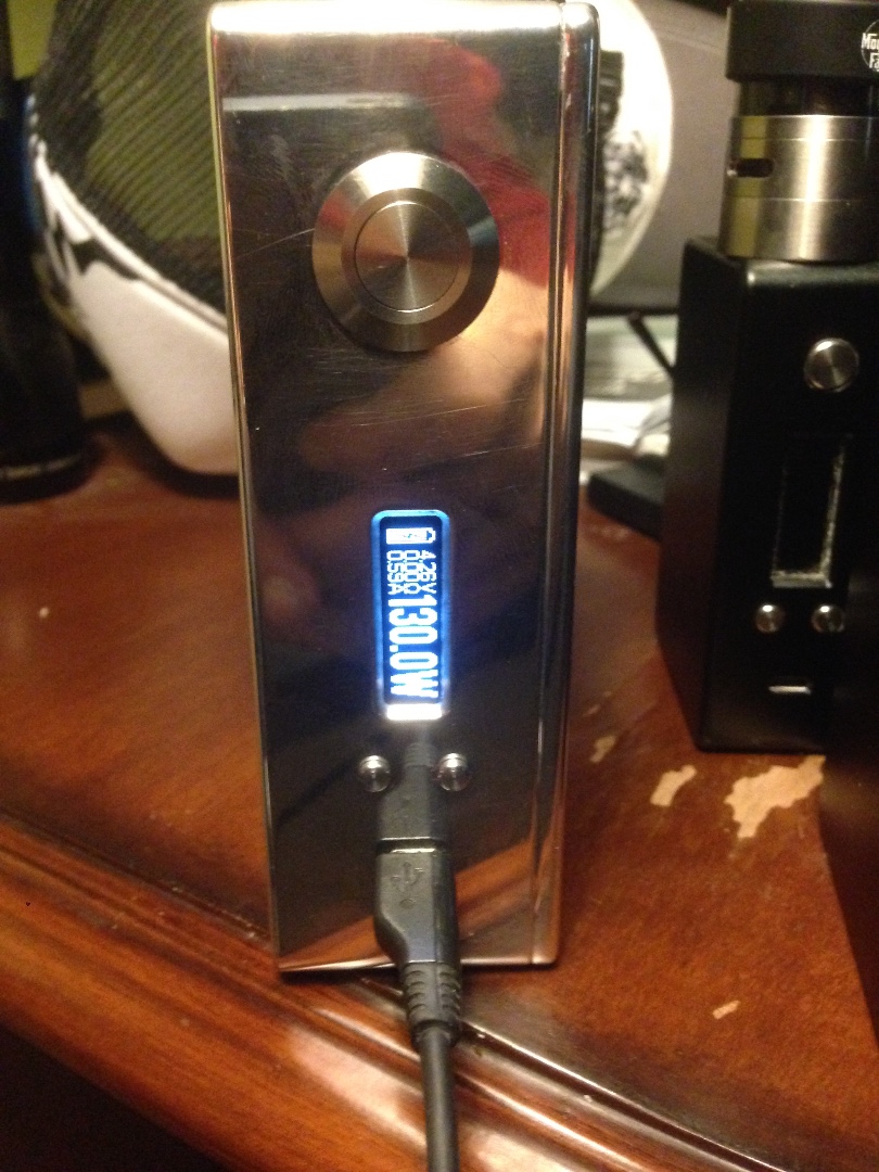

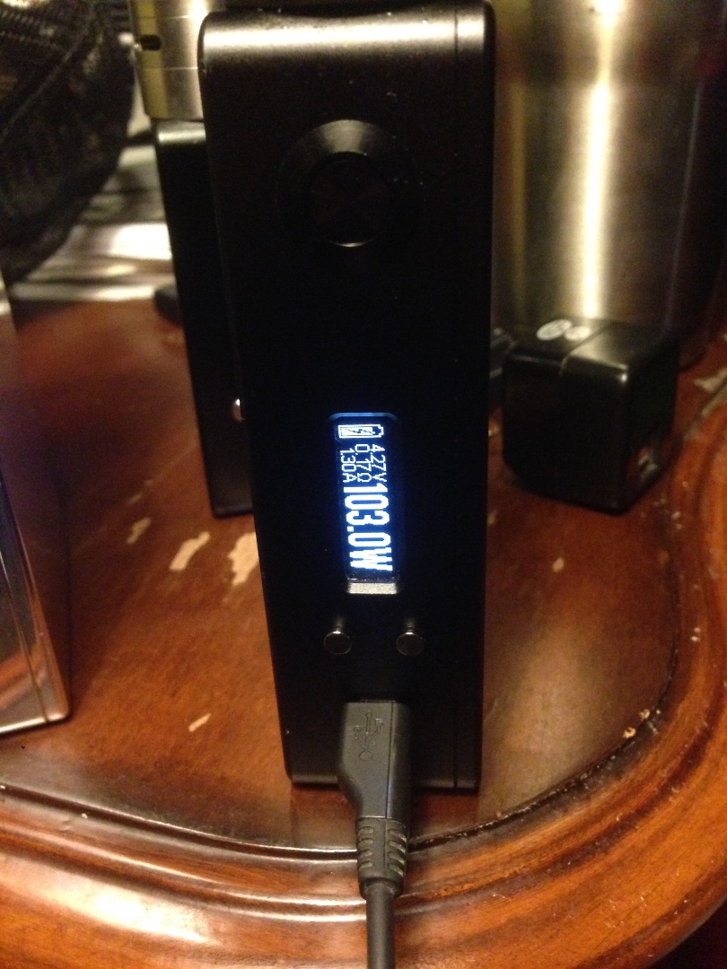

I would understand if this were the case on all mods but it is this mod in particular. The same USB block and cable provide 2a (1.97a) charging on other mods without issue. I will set USB voltage on screen of two different mods and use various cables. Same block with the same cable produces same charging voltage and different amp. First picture is mod in question Second picture is another mod with same block and cable.

not really the same USB voltage, as you can see at 4.27v the black mod is limiting the current down to 1.3a. that .01v DOES make a difference. on all of my DNA 250 mods the USB voltage rarely goes below 4.65v. this insures enough head room and proper charging. i use USB cables that are charge only, when charging. this style USB cable allows more room for larger gauge charging wires. it could be a bad charging circuit on the silver mod but i would invest in a good USB cable that doesn't let the USB voltage sag so much. whenever you see the USB voltage sagging down to 4.2X, it's time to get a good USB cable or wall wart (USB power source). we need to provide the board enough USB voltage head room before condemning the board.

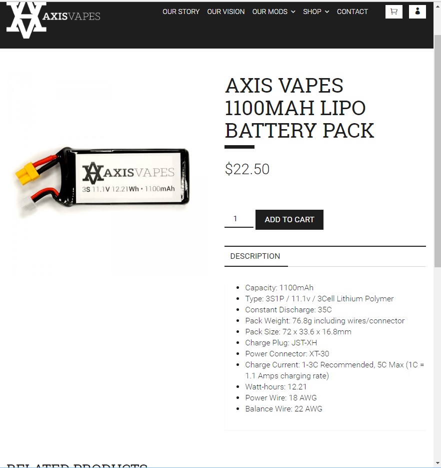

I am having the exact same issue with my Axis M17, DNA 250. Charged fine at 2a up until recently. I have a Therion 166 and it will charge at 2a using the same cable and wall plug. I have contacted Axis about this and they tell me that it should only charge at 1a and that that was why it wasn't charging at 2a. According to their website the lipo they sell can charge up to 5a and the dna250 can charge at 2a. I'm not really sure why they are telling me I can't charge past 1a. But even if it could only charge at 1A, why is it not charging at 1a? I have also noticed that when left plugged in for an hour or two it will say it's only partially charged then after using it for a bit the battery percentage will shoot up to near 100%. I set the watt hours in escribe to match the description of their battery when I first got it and it worked fine for a month until it started acting up. I have changed the watt hours now to what it was charged at when it was showing 100% but that didn't remedy the battery percentage jumping.

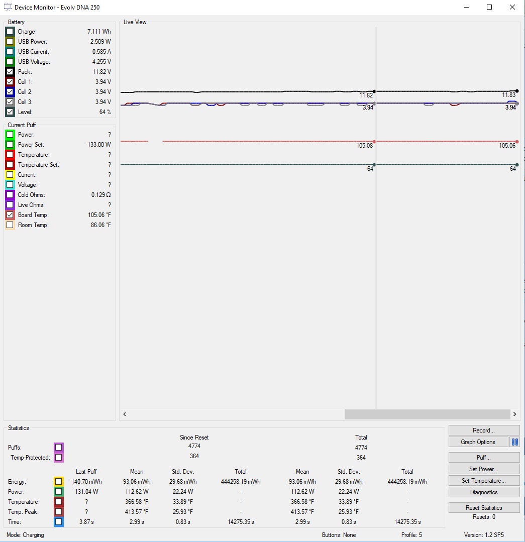

the dna 250 will charge at 2 amps when not connected to a PC (given you have a USB cable and charger that can provide 2 amps). it will however, throttle down to 1 amp when using EScribe.
can you post a screenshot of your battery settings, your actual battery specs and a shot of device monitor with all of the battery boxes and board temp box ticked.
Link to comment
Share on other sites
you notice how your USB voltage is 4.25v? when the USB voltage drops to around 4.27-4.28v the board will start current limiting the charge cycle. does this same USB cable and charger work fine on your other DNA 250 devices? do they charge at 2 amps? what is their USB voltage while charging at 2 amps (not the 1 amp in EScribe)?  i'm trying to figure out if you have a weak USB cable/charger, something metallic inside your USB port, or a bum board. to test this, you can set up through EScribe to see your USB voltage on the mod's screen. i would do that on your other DNA 250's to get an average of the voltage drop using your USB cable/charger setup. then post back.

Axis has repaired it and sent it back without informing me of how they resolved the issue. I did try to call and ask but didnt get a hold of anyone and have forgotten about it til now. I did notice they set my watt hours to 9. I'm wondering, but not sure at all, if the issue was because I set the watt hours to 12.2, which is what they advertise their lipos at, was the cause of the issue. That was one of the first things I did. According to their site adjusting the wh voids the warranty but they handled it without grief after I explained the issues I was having. I also noticed the chip was set back to factory. Wish I would of thought to write down my serial to find out if it's a new chip. If escribe keeps track of that I could find out for you.

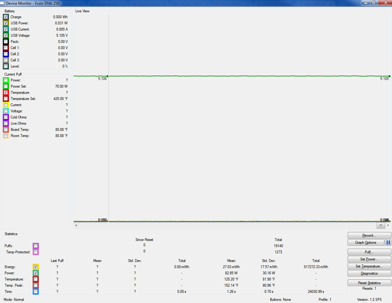

@davidealda Device monitor is not showing ANY cells present. Do you have the lipo removed? 0.00 volts for pack and cells 1/2/3 could be a sign the board is bad. Even without cells, when looking in Device Monitor on any DNA 250, there should be some voltage present (around 1 - 2 volts - from the board being powered by the computer's USB). ...
I would contact Vapecige and/or Evolv. Evolv's help ticket link is in the bottom of my signature..........
