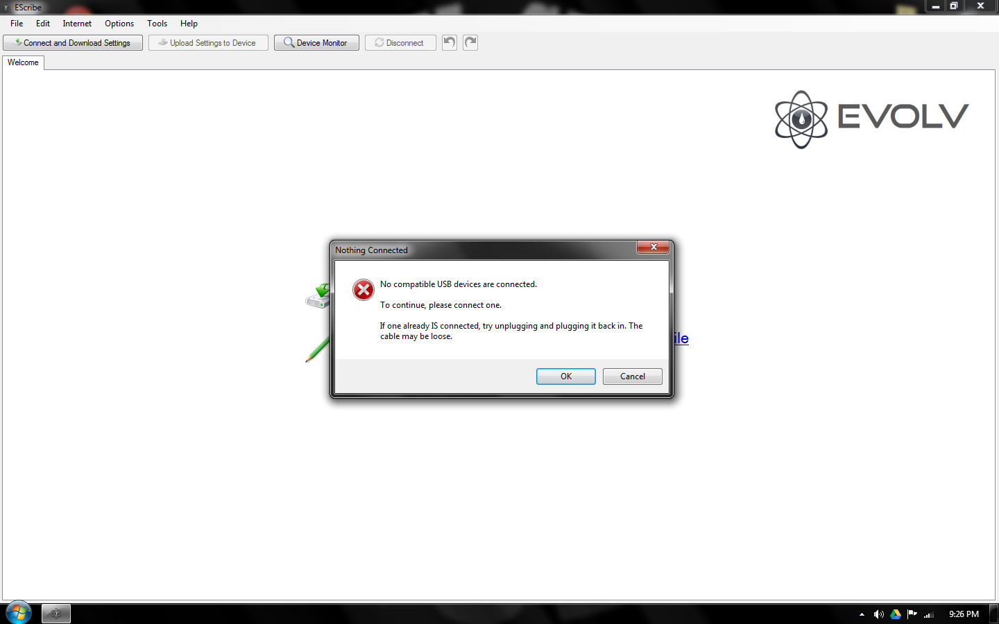

  2. I have 2 brand new boards that are not recognized by any of my Windows systems that recognize other devices. I have uninstalled and reinstalled escribe numerous times trying to resolve the issue. I have also sent a RMA request and have not gotten a response in over a week. Attached are screens of the error message from each board.
