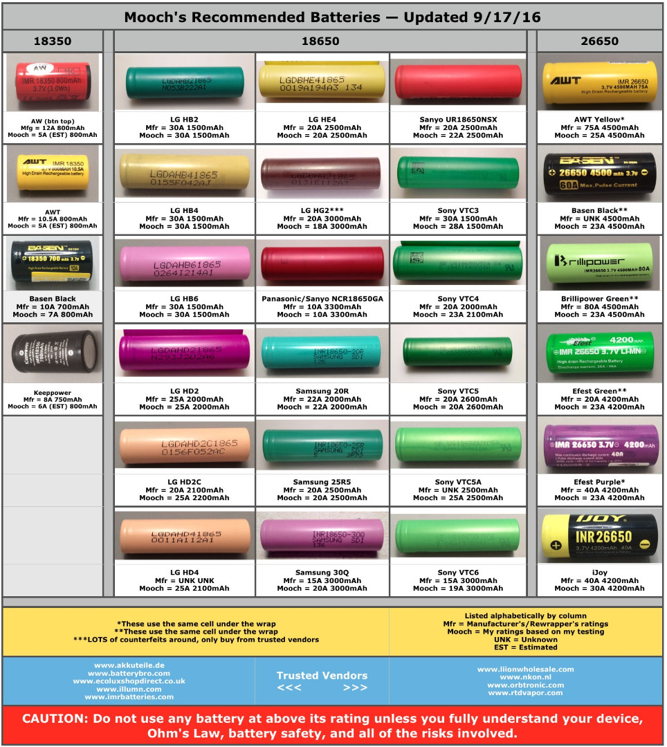

Wayneo Posted March 12, 2017 Report Posted March 12, 2017 Considering there are no true 3000 mAh 35A 18650's, or ANY Efest batteries on Mooch's approved list, I'd really suggest you run your own battery analyzer for your batteries. Easy to do, and guaranteed accuracy for your mod only.
giz_60 Posted March 12, 2017 Report Posted March 12, 2017 Wayneo said:Considering there are no true 3000 mAh 35A 18650's, or ANY Efest batteries on Mooch's approved list, I'd really suggest you run your own battery analyzer for your batteries. Easy to do, and guaranteed accuracy for your mod only. Agreed!! With the extensive test that Mooch performs on batteries, for the purpose of vaping, I would not even consider anything not on his recommended list..https://batterybro.com/collections/moochs-recommended.
