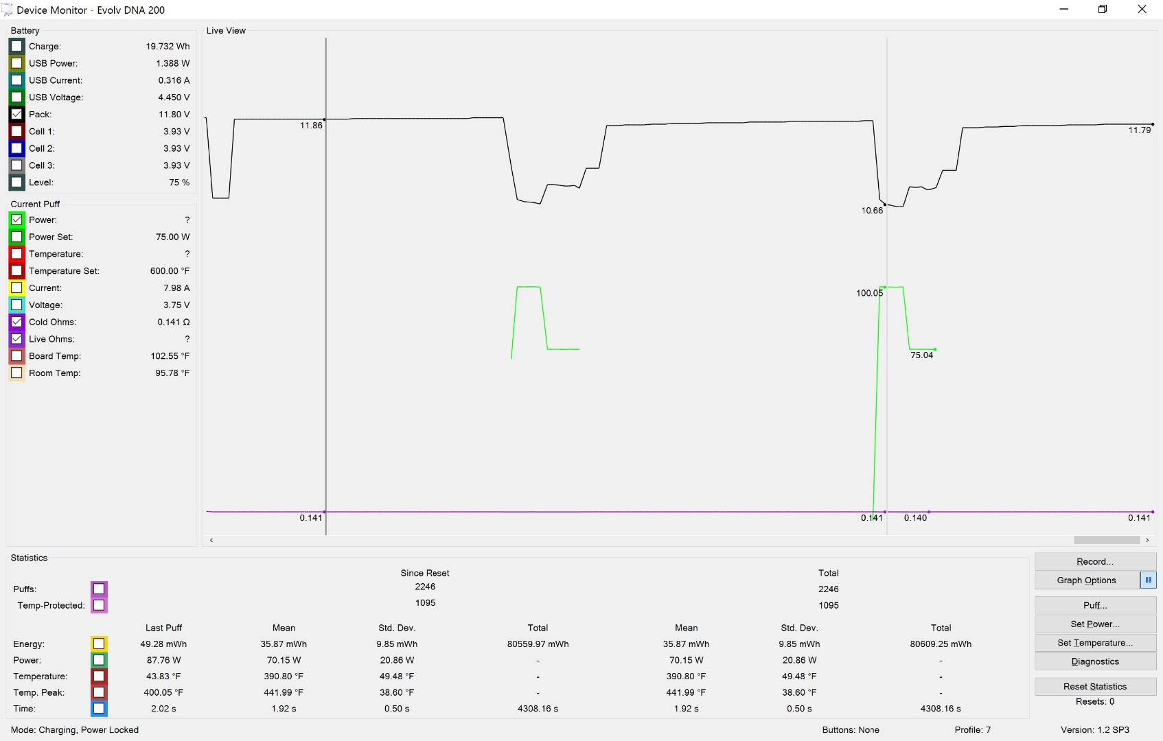

bmclaurin Posted September 16, 2016 Report Posted September 16, 2016 Anyone tried this with nicrome 80? Most of my non-TC builds are nichrome, which has an ever so slightly larger TFR than kanthal. Wondering what I should change the coefficients by to make it work.
bmclaurin Posted September 16, 2016 Report Posted September 16, 2016 bmclaurin said:Anyone tried this with nicrome 80? Most of my non-TC builds are nichrome, which has an ever so slightly larger TFR than kanthal. Wondering what I should change the coefficients by to make it work.I answered my own question. It works! I just used the same method of adding .1 to each point after 382F.Device monitor results are below. And my .csv file is attached if anyone is interested.Nichrome_N80.csv
