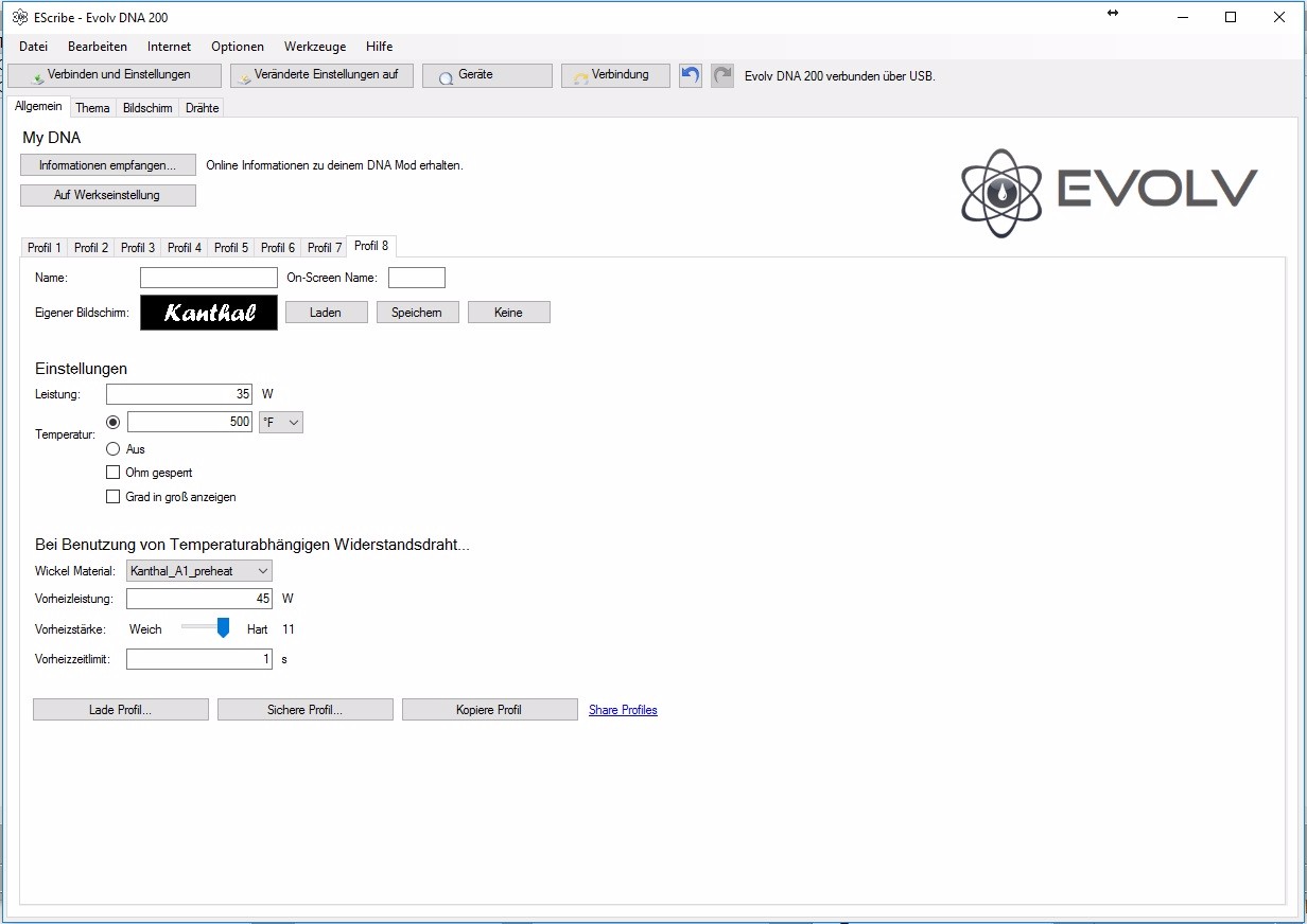

to add to what @retird is suggesting. two tricks that work for me when the kanthal preheat csv won't work for me........ take note of base resistance and lower it a smidgen in atomizer analyzer, then lock it in (i keep lowering till it works, little by little). turn the punch up to 11. fwiw, this isn't real TC for Kanthal/nichrome. it's intended use is just for a preheat spike at the beginning of your vape.

This workaround is allowing you to enable and customise (since the Evolv software allows it) Preheat in Kanthal.

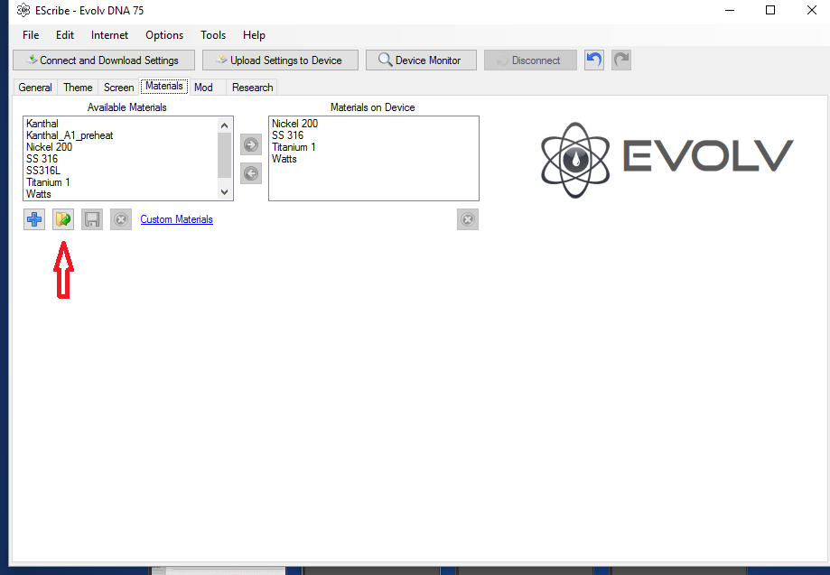

I'm downloading the CSV file without problems, for anyone having issues though (many people in this thread seem to) -- the original post by @gorman explains simply how to easily implement it on your own device using only the Escribe software. You just need to create a flat temperature curve and change the point values by the minimum possible.
