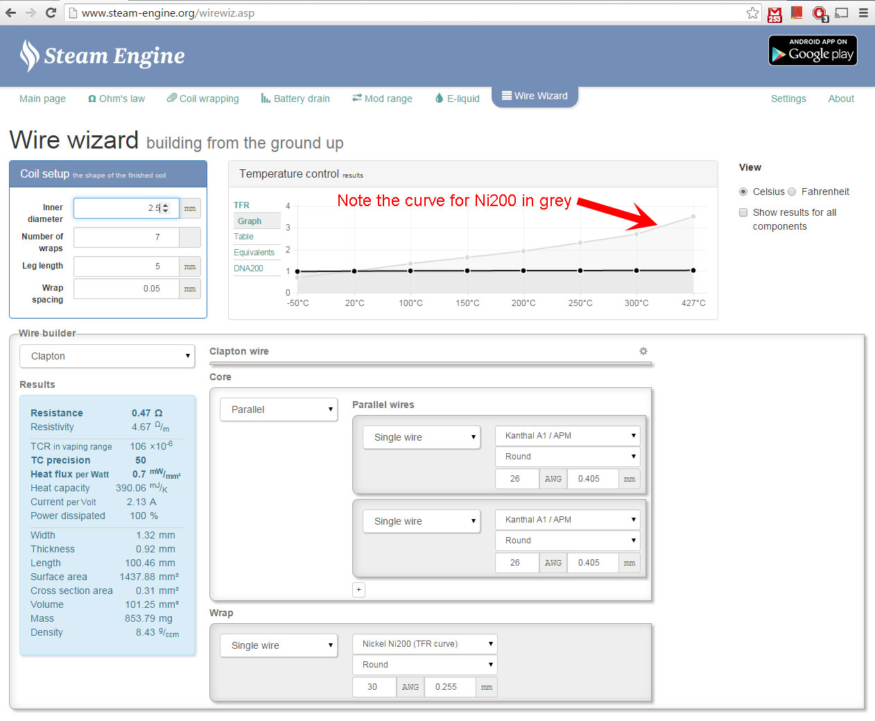

What exact wire? (please post link) What exact TFR CSV file are your loading in Escribe? By default only Ni200 is installed into the DNA's firmware, and most Titanium will create 'burning / burnt taste' around 250° F ~320° F. You need to select the correct Titanium from - http://www.steam-engine.org/wirewiz.asp Titanium Grade 1 is listed as 'Titanium 1' in the Wire Builder section. Here's a good interactive Tutorial - http://www.evolvapor.com/guide/story.html scroll down to the bottom section 'Custom TCR's.'

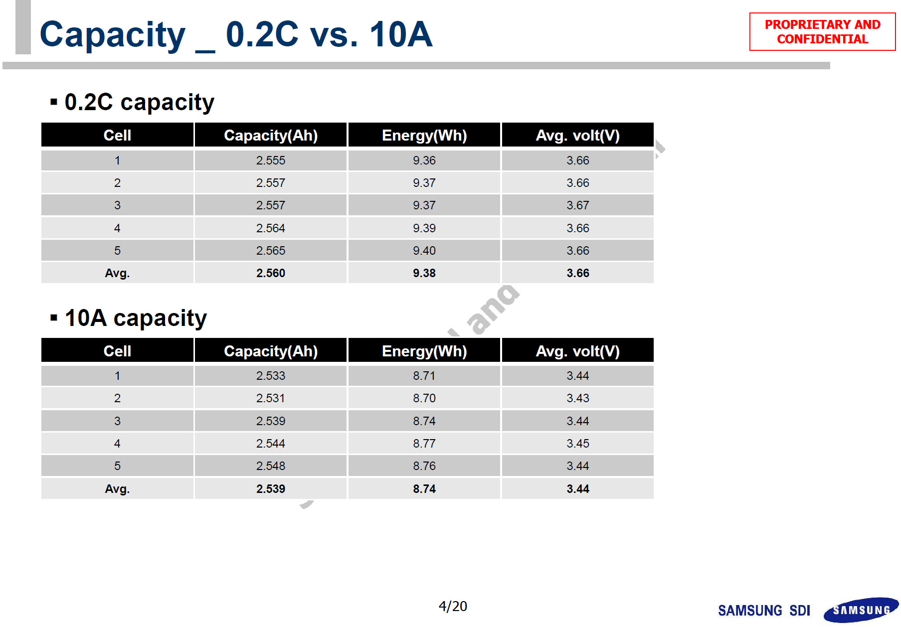

Here's Samsung's own Capacity tests, 0.5A (3S ~28.4 Wh) vs 10A (3S ~26.2 Wh). Never mind that Samsung allowed the batteries to drain to 2.5V cutoff vs Evlov's 3.0V, nor the cutoff the Evlov's Analyzer imposes as it detects an unstable power delivery. So you think a cutoff of 3.0V~3.1V vs 2.5V and high or low Load has absolutely no effect on the total battery capacity!?

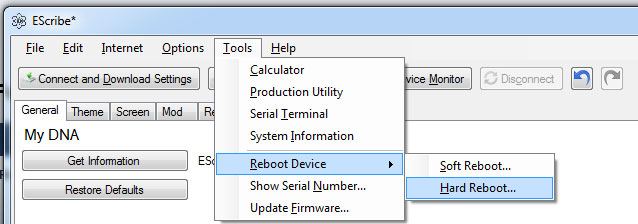

Remove all 3 batteries, connect to Escribe and perform a Hard Reboot (see below). IF you cannot connect without batteries then you've probably got a dead DNA 200 board. IF it reboots without batteries then chances are the 'positive' isn't connecting properly or you put a battery in backwards.

When you 'mix' metals (Kanthal is an alloy of FeCrAl) and Ni200 you no longer have an accurate (Temperature, Resistance) as with a pure Ni200 coil. I've built Twisted 30/30, 28/28 gauge of Ni200 / Kanthal, and a Clapton of 26 Ni200 with both 30 and 34 gauge Kanthal. They work'ish but require temperature (TCR) adjustment. Adding some Ni200 doesn't make it a magical TC Ni200 coil. What you have is some odd coil with a near flat TCR that I really don't recommend, but here's the info: Calculated TFR - http://www.filedropper.com/dna200-clapton-steamengine Flat curve (Fused 2x26 Kanthal, 1x30 Ni200); the FLAT one is your calculated 'curve': -
