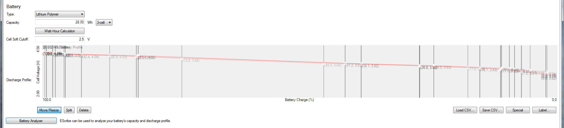

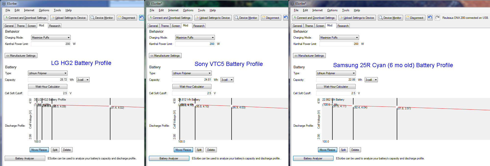

Well I ran a Profile for the (aka my old) Samsung 25R's and the following Battery Profile is from a set + 1, same batch, batteries; the set have been paired for several; months in a Sigeli 150W Mod and the +1 from an old IPV 4 Mod. Ideally I'd much, much, prefer to use a brand new set of 25R's or any batteries. When I came home the test had completed, but I noted 3.30V, 3.35V, and a 3.41V .. that's not a 'good' example however the 3.07V test cutoff is good. Under a 'Rated' 10A load 8.74 Wh*3 = 26.22 Wh vs 'Observed' 22.86 Wh or 3.36 Wh which is good but a new set probably would have been a tad better. Battery Profile Samsung 25R http://www.filedropper.com/samsung25rprofile Here's an overlay comparing the 3 batteries (pretty close over all): Side-by-Side Wh, Cutoff, Profile:

Sorry it took so long, we're moving. Linked below are the Sony VTC5 Battery Profiles for both the 2S 133W and 3S 200W. The noticeable differences are the Sony VTC5 loses about 4 Wh over the LG HG2's and cutoff at 3.1xV whereas the LG HG2 cutoff is around 3.0xV. My Sony VTC5's are not brand new but they're about 2-3 months old and of the VTC5 're-release type' but are indeed authentic. I entered the standard Sony VTC5 settings (Nominal 3.6V*3=10.8V, Capacity 2600 mAh, Cutoff 2.5V) and ran the tests. Per spec the 'Rated' @ 10A is 8.8 Wh*3= 26.4 vs 'Observed' 24.8 Wh or a difference of 1.6 Wh which is actually very good since the DNA 200 doesn't drain to rated cutoff voltage. Profiles http://www.filedropper.com/sonyvtc5profilesdna200 Here's an overlay comparing the 2 batteries: Side-by-Side Wh, Cutoff, Profile:

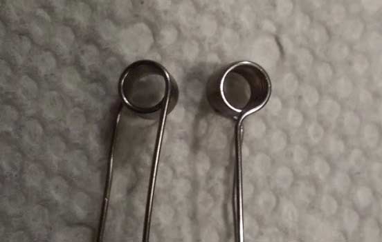

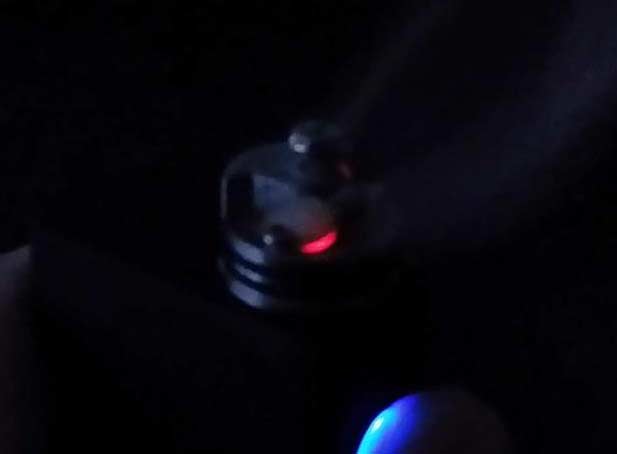

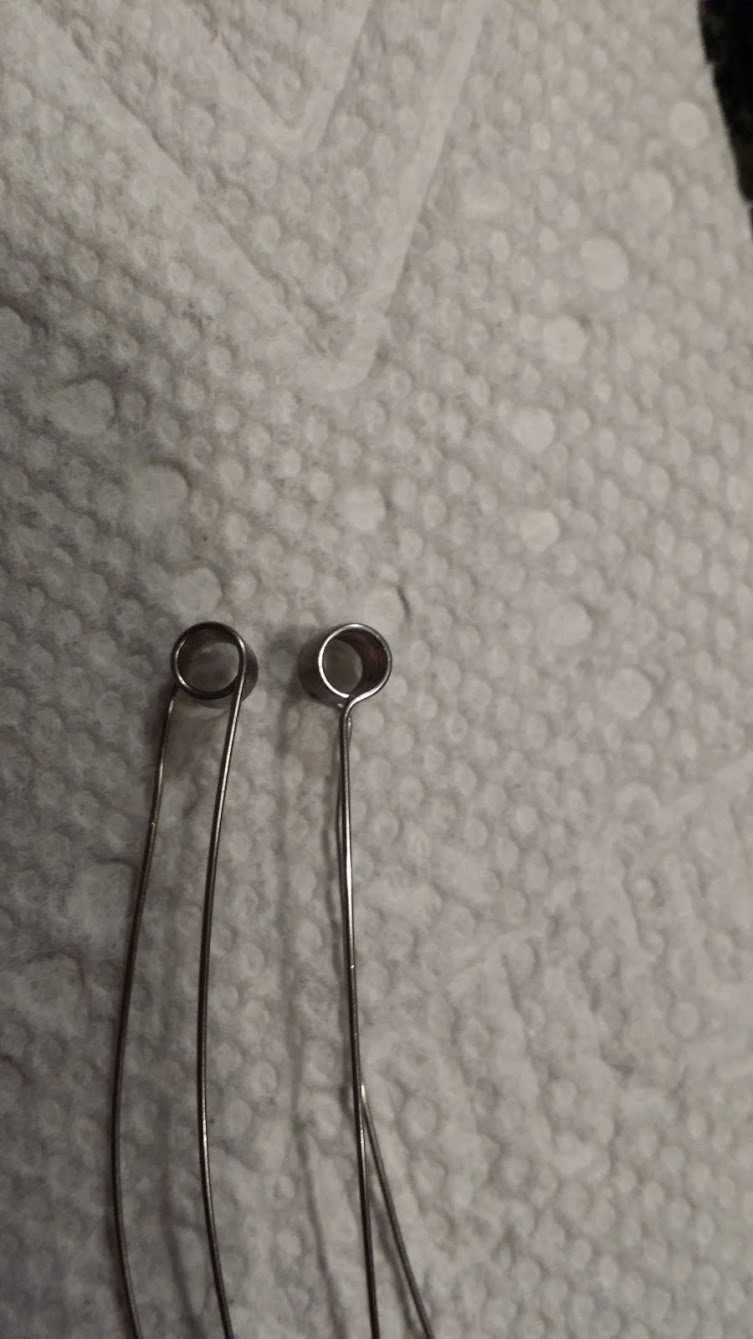

I find Sweet Spot (Titanium alloy, it's not pure Ti) you can get red hot leads especially if they're >3 mm in length. Also most of the polished Titanium lost ~1 gauge from being polished. A 5.5 suggests 6 out and 5 in as a 'U' shape .. try making the coil a pure 6 warp with 90-degree bends (quick and dirty example): Hot legs from Sweet Spot Titanium (alloy of TiFe; note grade 1-5):

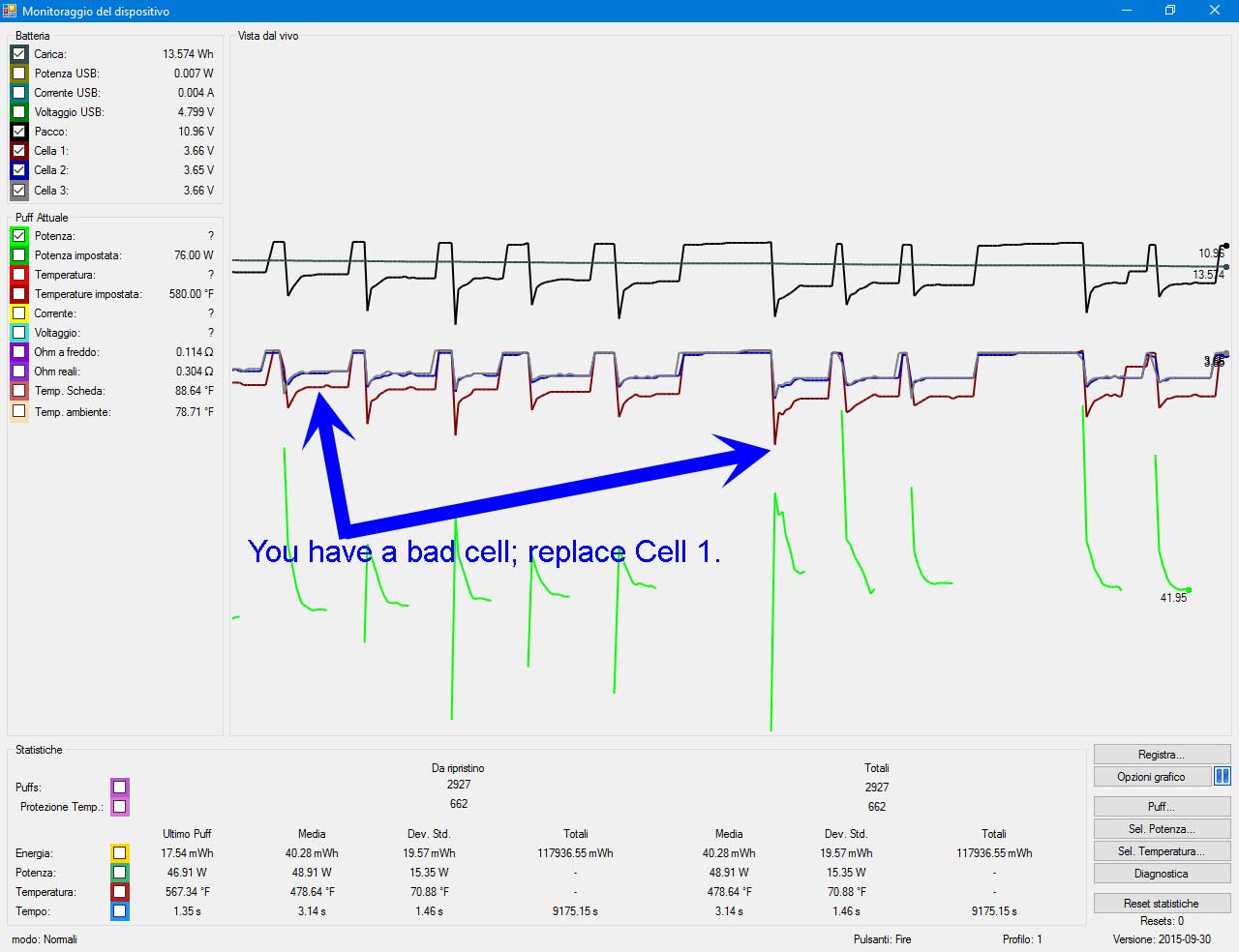

The no change is disturbing, as mentioned not all USB cables are the same but connection, charging rate (Amps), Battery Profile and cell condition all can play a role. Ideally you want to see 0.9X Amps, and >4.X Volt charging. In the Screen tab of Escribe, note the original settings, and for now I'd recommend: Battery Charge %, USB Voltage, and USB Current plus Charging Brightness of >25%. Before charging more, connect and run Escribe, attach an Atty; click Device Monitor and in the bottom right click on the 'Puff' and run it for a few seconds as shown below. All 3 Cells 'should' have very close Voltage changes with no apparent big gaps. Example of all good cells: Example of a bad Cell, Cell 1:
Looking at your graph, if you have one cell that's so far off compared to the rest it will trigger the DNA 200 to throttle / cutoff prematurely compared to the remaining 'stable' cells. I would not recommend 'sanding-off' bits of plastic on your Mod. If the battery casing is damaged then either re-wrap or replace the effected cell. The problem is the cell (battery) if by changing the position of the cell the voltage drop changes from eg. Cell 1 to Cell 2, etc.
