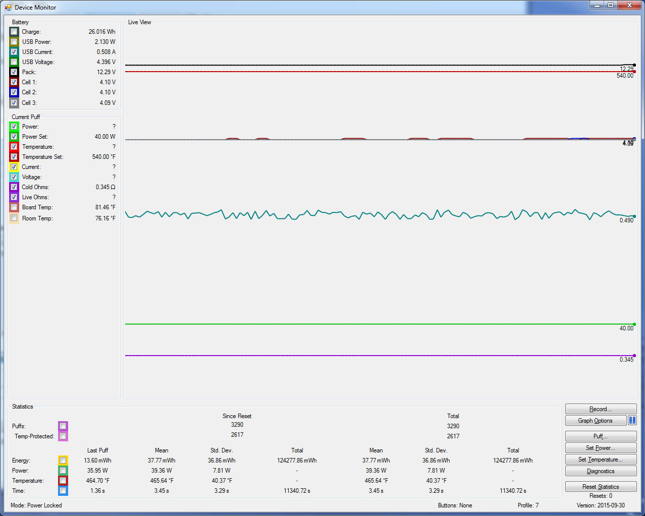

First Eciggity is a very good company so worst case simply arrange an RMA if needed. First, let's try to fix it. Connect your Efusion to EScribe and try a Hard Reboot: Next look at the Device Monitor and see the charge on Cells 1,2 & 3. Full (max) is 4.2V per Cell and minimum (empty) is approximately 3.0~3.1V per Cell, and Unbalanced is > 0.2V~0.3V between highest and lowest: Also, I'd recommend downloading the latest version of EScribe and if required update the firmware. Latest version of EScribe (2015-10-21 EScribe 1.0.35.2) - /topic/66731-topic/

I think I just replied to you, download your Battery Profile and look at the CSV file. Full 100% should be 4.2V and empty 0% around 3.1V. If you run the Device Monitor look and compare Cell 1, 2 and 3 they should be the same or within ~0.1-0.2V while charging. If it's much more than you have a LiPo that's out if balance. Here are some user tested numbers that I'd use over the Evolv's defaults. HCigar does not properly setup their Mods and uses IMO cheap inferior LiPo's. Settings: Wh = 11.09 Battery Profile (CSV) http://www.filedropper.com/hcigarvt200battery Cutoff (V) = 3.09
Look at your Battery Profile, download the file and it should be 100% at 4.2V with 0% somewhere around 3.1V. Here's a user VT200 Battery Profile and info: Wh = 11.09 Battery Profile (CSV) http://www.filedropper.com/hcigarvt200battery Cutoff (V) = 3.09
DANGER WILL ROBINSON .. DANGER!!!! Holy cow your batteries are WAY, WAY overcharged!!!!!! Take the battery out and IF possible connect it to something to DISCHARGE. You're at a CrAzy 5.82V per cell, normal full is 4.2V per cell. Your LiPo is dangerously overcharged!

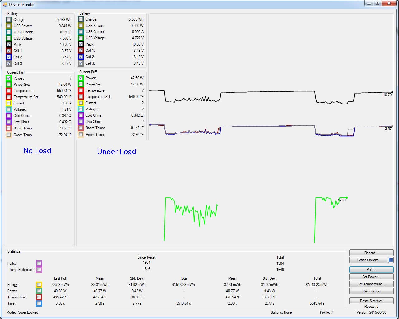

Post a screenshot of your Device Monitor; see attached. I assume on your PC that you can charge, read live data, and obviously update your Mod. Further, I assume that your Mod is fully functioning when used for vaping.

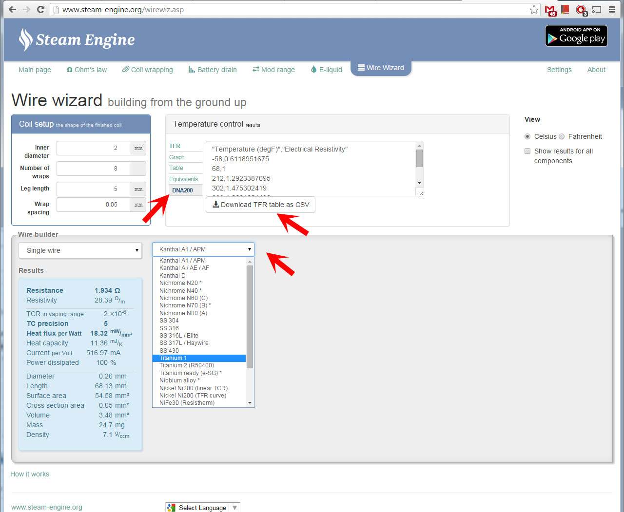

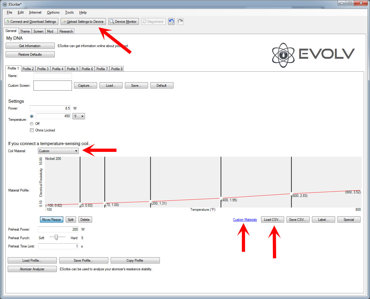

There's an Escribe simulator - http://www.evolvapor.com/guide/story.html and on the bottom left there's a Custom TCR's section. Once you have your DNA 200 Mod connected your change the wire type on a Profile from Ni200 to Custom, you'll see a link for Custom Materials, click on the Calculator link, under Wire Builder select your wire type, under Temperature Control results click on DNA 200, click Download TFR table as CSV. Go back to Enscribe and the Profile, click Load CSV... and lastly click the button towards the top Upload Settings to Device. Escribe Profiles: Creating / Selecting custom TCR's

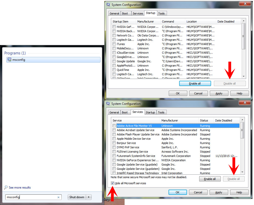

I'm still thinking this is an issue with your PC, you skipped over the MSCONFIG changes. Click on the Start menu and type in MSCONFIG, apply the following changes and then restart your PC. edit: If you have selectively Disabled any items manually before then make note of them otherwise to undo these changes click Enable All and restart. Question - what PC do you have?
That's why it seems more like a PC issue. You could try MSCONFIG and disable both Startup and non Microsoft items. In Escribe perform a Hard Reboot of your DNA Mod. I assume you're using the most current version of Escribe /topic/66731-topic/ and the firmware has been updated.
