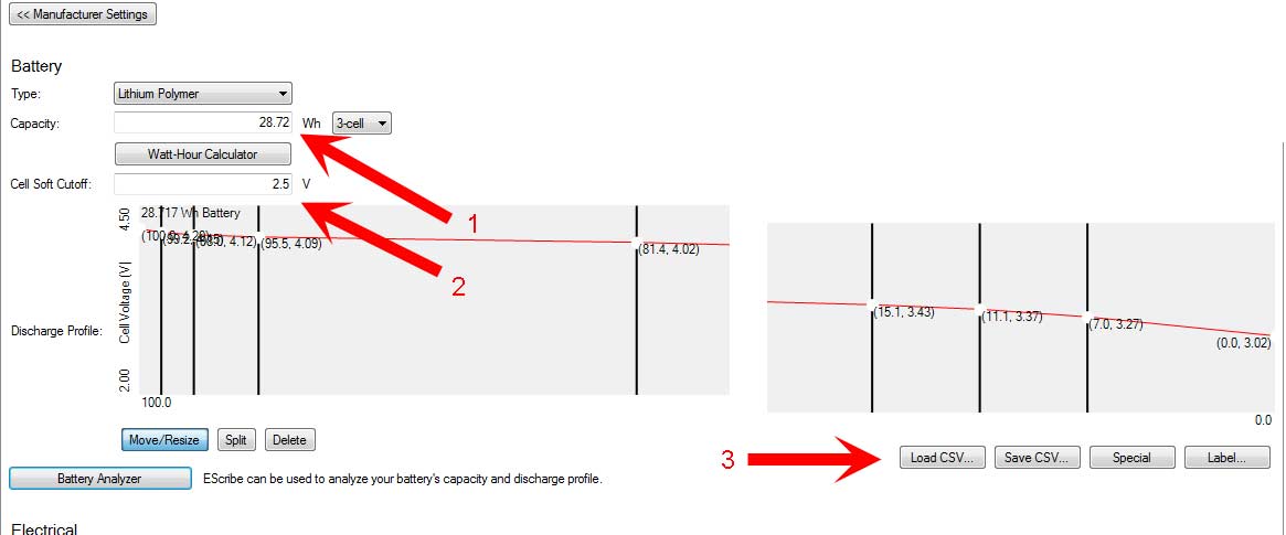

  2. Okay, interesting 'stacked' suggests 'series' so 1st you need to make certain you have the latest firmware, next you need to properly wire you Balance charger, lastly that your Mod is in 133W and 2S mode. 1. Wiring the 4-Pin Balancer (my guess this is your problem); see https://s3.amazonaws.com/files.websitetoolbox.com/186396/2411946 from thread from /topic/66226-topic/ 2. Latest Escribe - /topic/66731-topic/ 3. Settings; example from one of my Mods: Load this 2S Battery Profile to get yourself started - http://www.filedropper.com/lghe22s18650 Good Luck!

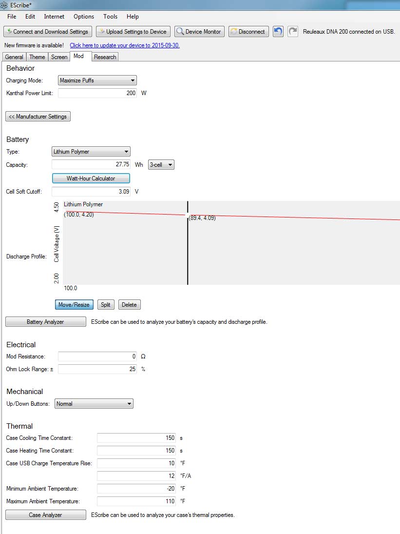

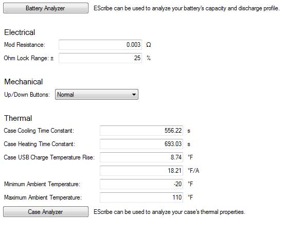

  6. To all, Reuleaux just posted their 'official' standardized settings http://www.wismec.com/product/reuleaux-dna200 NOTE: It will completely erase all of your settings if you Upload to device. If your Mod is setup how you like it then I'd probably use these settings plus the appropriate Battery Analyzer settings; theirs is some generic 3x18650's. At the minimum I would back yours up: File / Save .. name it. Official Battery and Case Analyzer numbers:

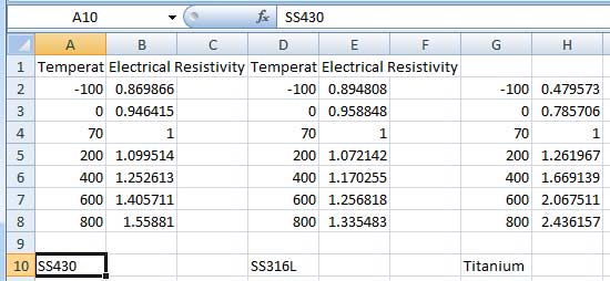

  7. SS430 should be 'more accurate' looking at the differences between 400F~800F, but I haven't a clue about its oxidation, leaching, etc characteristics. SS430 Fe, <0.12% C, 16-18% Cr, <0.75% Ni, <1.0% Mn, <1.0% Si, <0.040% P, <0.030% S Being straight up, I want to avoid Cr, Ni, Al, etc long-term. However, it's certainly a wire to play with in TC. I'm just having a hard time rationalizing Platinum wire because of its price. SS alloys in contrast appeal is it's cheap. Keep in mind, a Titanium coil will outlast the Atty itself... So price!?

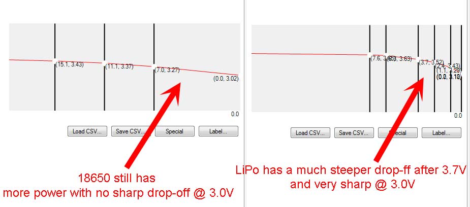

  8. I can only tell you what I see and the 18650's in series have a markedly different power drop-off. I'm not a battery expert but I'm observant. The 3.0V needs to be lowered to 2.5V~2.6V to accommodate 18650's .. they're clearly different drop-off's. Not to mention not every LiPo has the same specs nor cells. IDK allow an Expert mode to exceed especially lower limits.
  9. 2.85V doesn't work or it wasn't transfered to the current firmware. I've run these same tests on several LiPo's 900 mAh, 1300, and 2000 .. plus a LiFePO4 and they're all different. Each has their own cells with different discharging. Obviously, the 3S is for LiPo's but the 2S seems to have 18650's in mind .. so the 3S needs a revamped firmware.

  11. My 0% was 3.02V not the 3.1V that everyone else is getting .. because I did not use the 3.09V Default value. Oh yeah, the Default Battery Discharge certainly is the Fullymax FB900HP-3S Evolv sells here - http://www.evolvapor.com/dna200.php Evolv needs to allow <3.0V Cut-off's to accommodate 18650 cells, and no not all LiPo's are the same (Capacity, Nominal Voltage, or Cut-Off). Using made-up numbers simply gives you a 'garbage-in garbage-out' erroneous charging and discharging not to mention a 'meter' that is off and frankly may never see a eg 100% charged. I'm using my values. I do understand the cut-off of 3.0V vs battery's 2.5V reduces the (mAh) potential of the 18650's with a sub-3V cut-off's.
  12. LG HG2 Battery Profile (CSV) - http://www.filedropper.com/3slghg2batteryprofile I ran the tests twice using all of the correct LG HG2 values; Capacity 3000 mAh, Nominal Voltage 3*3.6V=10.8V, and the correct 2.5V Cut-off. Both tests were rather close the 28.72 Wh vs the theoretical 32.4 Wh was a little disappointing, and even 31.86 Wh (2950*10.8) would have been perhaps expected. The batteries are all new and married; initial charge, full discharge, recharged and then tested. The Default 3S (3 cell) are from Evolv's FullyMax FB900HP-3S: Capacity 900 mAh, Nominal Voltage 3*3.7V 11.1, and a 3.0V Cut-off. Specs - http://www.asaseletricas.com.br/loja/images/Data%20sheet%20for%20A0-FB900HP-1S%2030C.pdf It's a simple process, Input 3 numbers reverent to the specs of your batteries, and run the test .. then Save to your device.

  19. I've got to point something out here, just an observation, everyone seems to be using the standard LiPo Cut-Off (3.09 - 3.XX V) .. while I'm certain it works, most 18650's have a Cut-Off of 2.5~2.6V (refer to you battery's full specs). Example, under NO LOAD my low 18650 might be 3.5V but under LOAD 2.5~2.8V. Therefore, all of these posted TXT or CSV Battery files for 18650's as best as I understand batteries, are too high (off) and a shortened use cycle. Please enlighten me if I'm wrong here, but AFAIK I'm correct. It kinda defeats using a 3,000 mAh battery... Thanks!
  20. Being honest, I don't know, and as I mentioned before .. there are several different alloy mixes for SS316L, SS317L, SS304, etc all of which are SAE standards and China follows primarily GB standards; close not exact. Therefore, purchasing eg UD SS wire from China of some other than actual 'SS316L' or 'SS317L' is the reason I'm constantly modifying the CSV files. Conversion - http://www.iron-foundry.com/stainless-steel-grades.html To date, the only Steam Engine CSV file that worked 'out of the box' was their Titanium Grade 1. So will it matter .. chances are yes. I certainly would run the cotton test before finalizing any build with NEW wire! My opinion, I really doubt SS wire will be anything more than a 'fad' and I feel Titanium or some alloy of Titanium with a middle of the row TCR is going to be it for TC or at least the current approach of (Resistance, Temperature) TC. Now I've considered Platinum wire, it's a noble metal, it won't oxidize, and it has a high meting point similar to Titanium. HOWEVER, it's DAMN expensive! LOL people complain about the cost of Titanium. BTW .. by far Titanium is way better in every way over SS, I'm just messing around with SS out of curiosity and fun.
