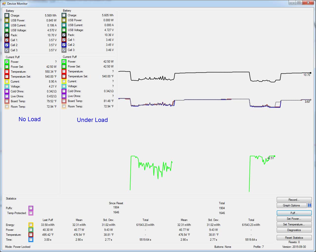

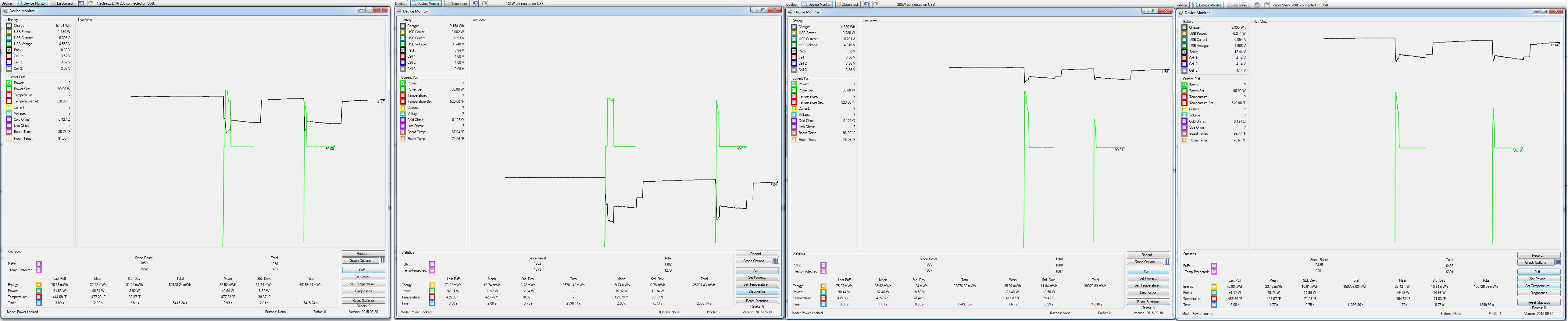

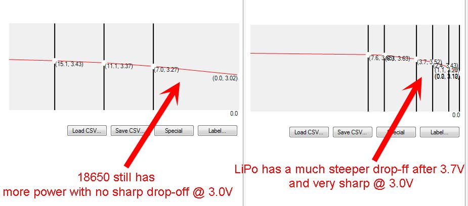

As I said It's 18650's vs LiPo's; copy/paste using IDENTICAL Atty and settings. [Identical ecig file and identical dual Ti/Kanthal Atty] Next 18650's sag (voltage drop) more than LiPo's. Here's a 18650's: Reuleaux with 3S and nearly depleted (~10%) vs 2S DNA 200 (133W) with fully charged batteries (2); vs LiPo's: a 2000 mAh LiPo 60% vs 900 mAh LiPo fully charged: Perhaps now folks will understand why I'd like to see for 18650's the Cell Soft Cutoff go down to 2.5V. LiPo's are essentially 'dead' at ~3.0V (load) and they drop-off a cliff whereas an 18650 is still pumping out power at 2.6V (load). 18650 on the Right .. LiPo on the Left:

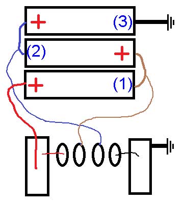

draw me up a diagram kid. im pickin up what yer layin down, but a diagram would make my night. thanks.[/QUOTE] Not very good, just lashed up in M$paint This is not a recommendation, but it could be how the Reueaux is wired, just saying don't shot the messenger.[/QUOTE] In your 'drawing' you'd take the 3rd negative off your 'ground.' [/QUOTE] I don't follow there are only 2 negatives the negative pad which is shown grounded and the negative balance connection shown connected to the negative pad. No extra wiring needed to complete the circuits all 4 balance connections are connected.[/QUOTE] I don't mean to be rude, but there's (1) positive AND (3) negatives! On the guy's drawing he shows a ground; he's missing aka FORGOT a wire. Look at this properly configured 3S:

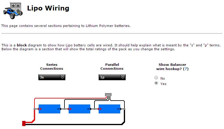

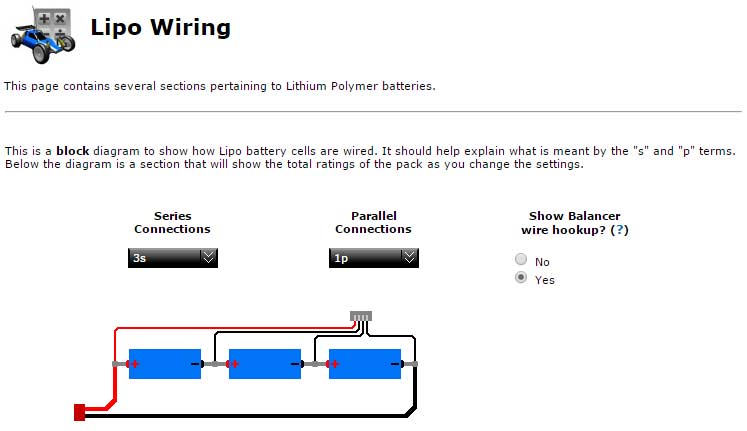

draw me up a diagram kid. im pickin up what yer layin down, but a diagram would make my night. thanks.[/QUOTE] Not very good, just lashed up in M$paint This is not a recommendation, but it could be how the Reueaux is wired, just saying don't shot the messenger.[/QUOTE] In your 'drawing' for a properly wired balancer you'd take the 3rd negative off your 'ground.' Look at my LiPo wiring schematic I posted, it's correct. My Reuleaux reads ALL three batteries correctly and separately. I mean wow run the Device Monitor and select cells 1,2 & 3; example: raw test file http://www.filedropper.com/volt
Wow look for the little wires (2) red + (2) black = 4. Two from the top and 2 on the bottom .. all 4 balance are there and accounted for. Yes on a 3S you need ALL 4 wires; positive and at the end of each negative: [Identical ecig file and identical dual Ti/Kanthal Atty] Next 18650's sag (voltage drop) more than LiPo's. Here's a 2S DNA 200 (133W) with fully charged batteries (2) vs Reuleaux with 3S and nearly depleted (~10%) vs a 2000 mAh LiPo 60% vs 900 mAh LiPo fully charged:
