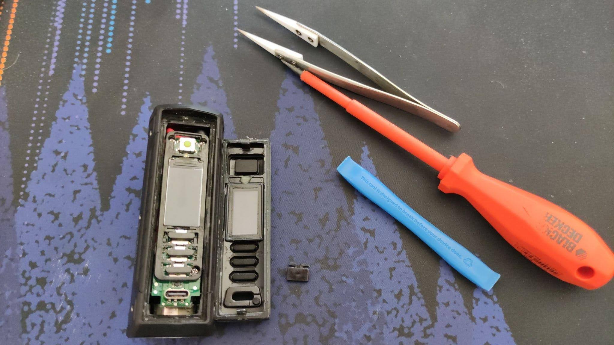

The firing pad in this pic is off on the right side on the table. They break off from the plastic frame. Why they used plastic arms to act as a spring, I'll never know. Some have just glued the arms back on. But I would guess it would just break again. It might work by tossing the pad away and just using it without.

That is odd @pasha_bog. As long as everything works fine, it doesn't sound dangerous. What kind of mod is this DNA100C? EDIT: D'oh! An Hyperion, silly me. Does it make a noise when you shake it? I have a few Hyperions myself and the firing pad has a habit of breaking away from the plastic frame.
