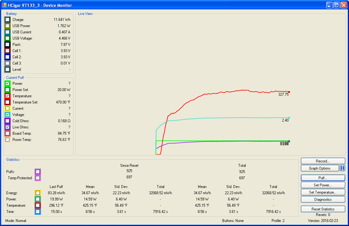

  6. The temp is set at 470ºF, the coil is Ni200 0.107 ohm and it is throwing 20 watts at it and it is only hitting 327ish... The same build in another VT133 does this.

  10. @dwcraig1: As I stated, it is a Ni200 0.092 ohm coil. Same one on both mods. Say I just saw your problem awhile back on one of mine. I solved it, but I don't recall what I did. I believe it was happening on a Crown RBA. What are you using for an atty?
