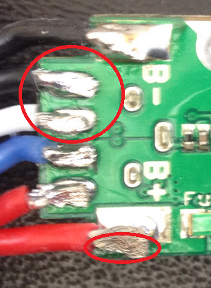

Whats the reason why the board becomes dead ?

These are the vias David, sorry I can't see from your picture. Have a look at this thread /topic/67186-topic/ -

I can see a couple of potential issues with the first picture, there loose strands from the black balance wire and the positive battery wire is over 3 vias (look like holes in the board, but connections that connect the different layers of circuit board) that are know to cause a problem if the solder here contacts them. -
