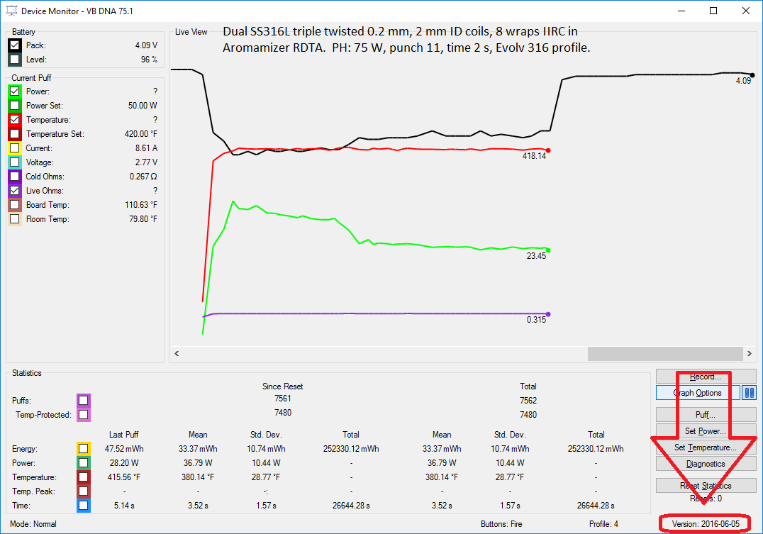

  20. Your fw is up to date then, the version of fw the device is running is shown in the bottom left of Device Monitor, this shows the latest version.

  23. The version of fw the device is running is shown in the bottom left of Device Monitor BTW. Enjoy your new mod!

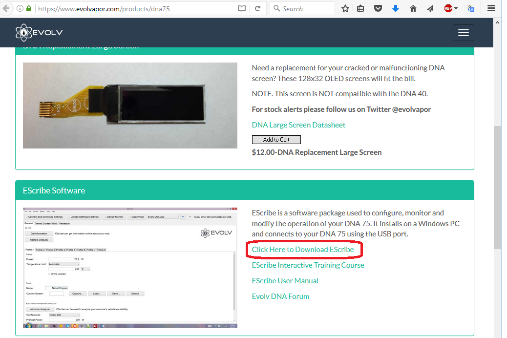

  24. Don't worry you can't brick them, the fw update process had been designed to be recoverable. 3rd section on the product page "Click Here to Download Escribe". Just install, connect your DNA (with or without batteries both work) and it should ask you if you want ot update the fw if it not already up to date, you can force it to update the fw by clicking apply service pack in the tools menu as well.
  25. The current release is on the DNA 75 product page https://www.evolvapor.com/products/dna75 or you can try early versions at the link in my footer, but both are the same fw version for the 75 at the moment.
