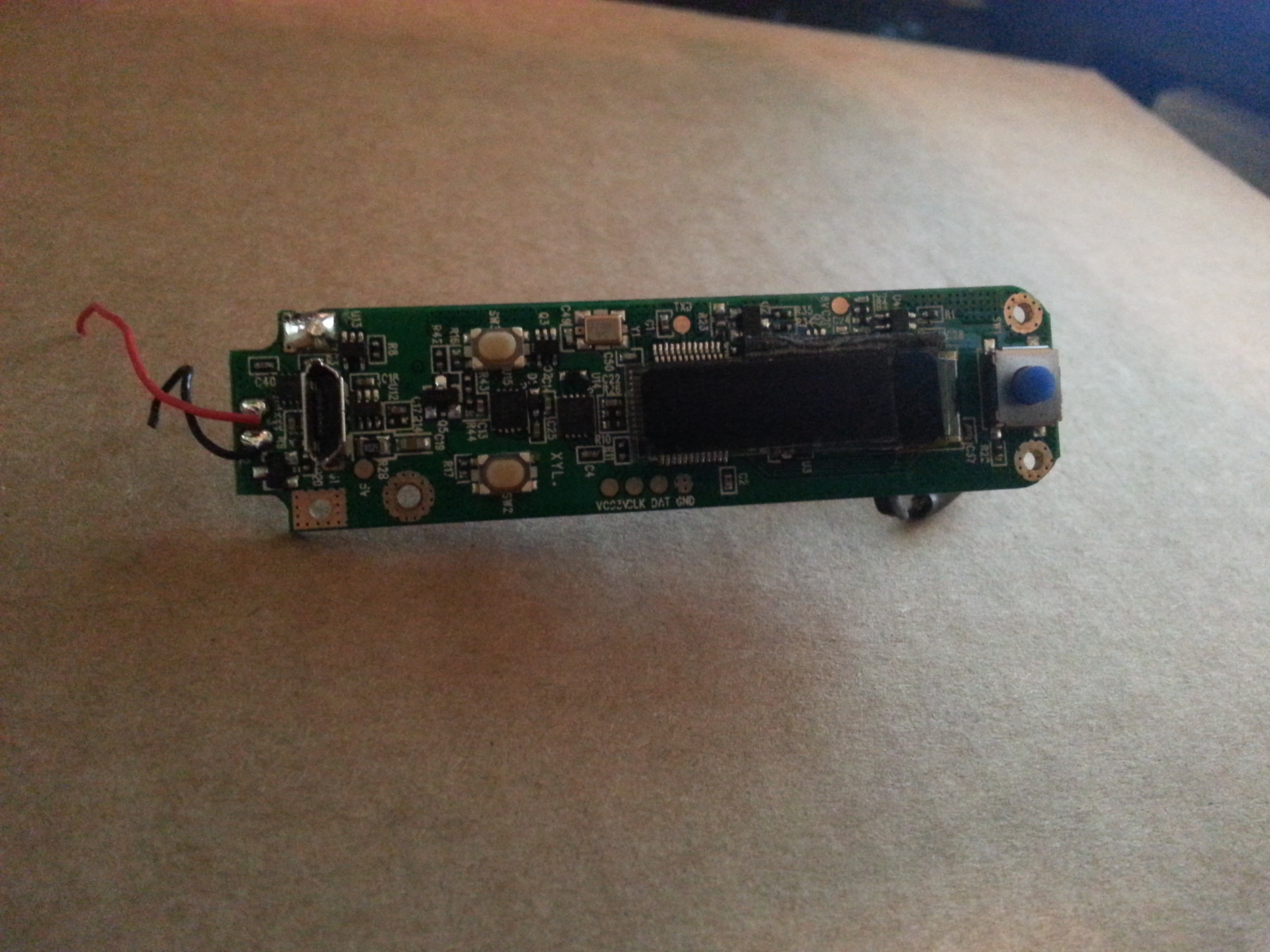

  1. your zif socket connector has most likely come open from lifting up the screen when doing the ribbon tuck. the sticky foam tape pulls up on the connector opening it, it happened to me. it's the black connector that holds the screen ribbon to the board. there's a tiny flap on top that opens and closes. make sure your ribbon cable is completely inserted and make sure it's snapped shut on both sides and report back. and it says on page 1 post 13 attempt at your own risk.

  16. the zif zocket latch latch will come open cause of the sticky side of the foam tape pulls it open when lifting the screen just snap it back down and see if yer screen is workin again.

  21. take your batts out. take out the four bottom most screws, that will release your face plate. usb IS TIGHT inside of face plate so wiggle the face plate to detatch. place screws and buttons in a safe place as not to lose them. gently pry screen up from board. it's held on with sticky foam tape. make sure your zif sockect locking flap did not come unlocked when prying up screen(foam tape sometimes pulls this open when lifting up on screen do to the adhesive side of foam). get a toothpick or similar sized tool and put a gentle s bend in ribbon, no sharp abrupt bends. reseat the screen making sure your bend has retained it's shape. test fit face plate to make sure everything lines up. re install face plate with buttons and replace screws followed by batts. done. ATTEMPT THIS AT YOUR OWN RISK! IF YOU ARE NOT COMFORTABLE TAKING APART YOUR $160 DEVICE, THEN DO NOT DO IT! THAT IS WHAT YOUR WARRANTY IS FOR. IF DONE INCORRECTLY YOU WILL SEND YOUR SCREEN STRAIGHT TO HELL. KEEP IN MIND, WITH THE CHINESE OLED FACTORY EXPLOSION/SHORTAGE, THESE SPECIFIC OLED SCREENS ARE AN ENDANGERED SPECIES.
