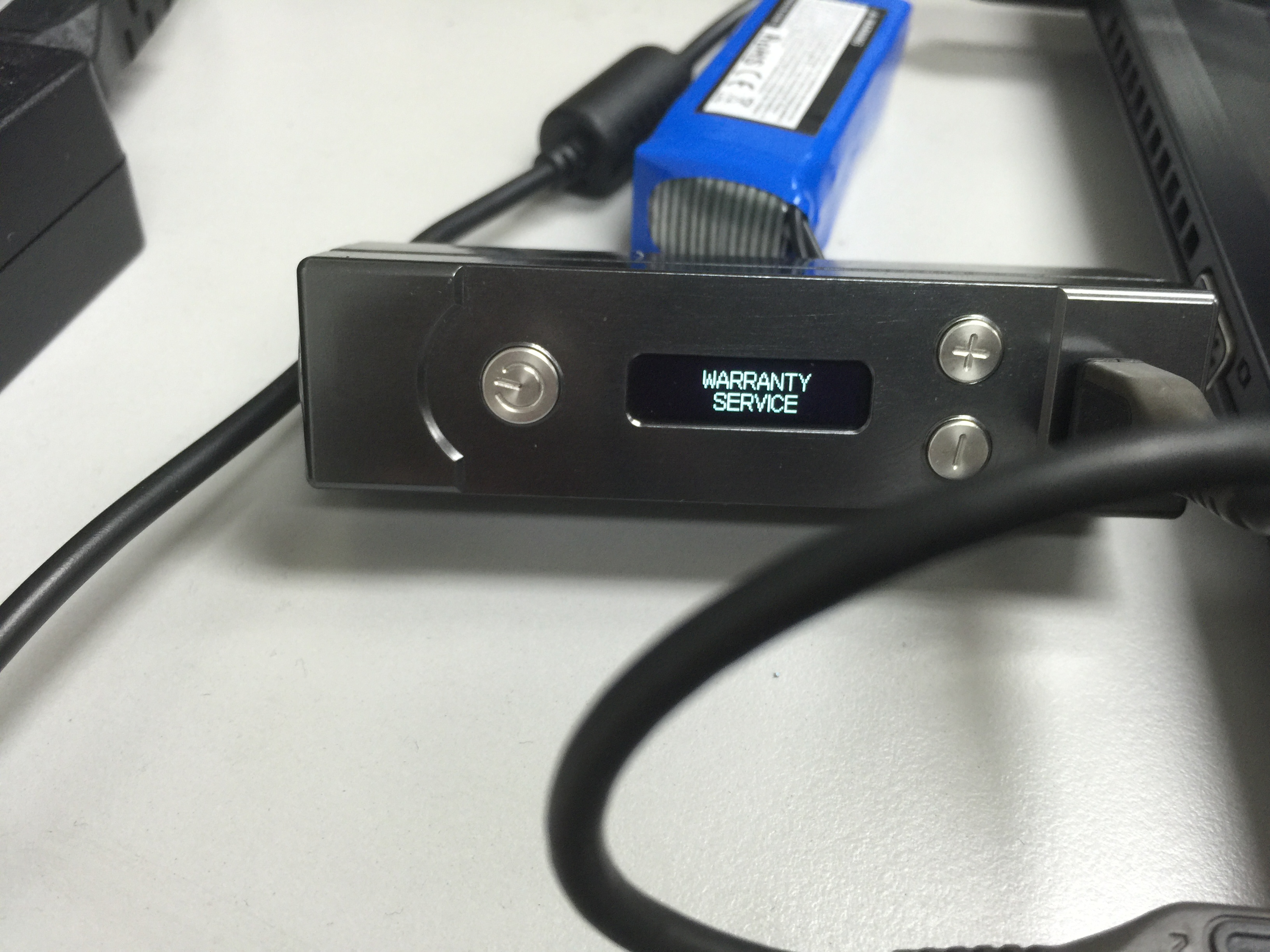

  2. I give up.. I remove the battery and connect to escribe it works, but when i install new battery the same thing happen. The board gets warm and when i try to reboot, screen from warranty service change to "welcome screen" blinking non stop with ticking sound.
  3. Change battery, everything still the same. Remove the battery and try to connect to escribe, everything is okay but put in battery the same problem occur

  5. screen manage to last little longer now after welcome screen and it show "warranty service" before it died again..

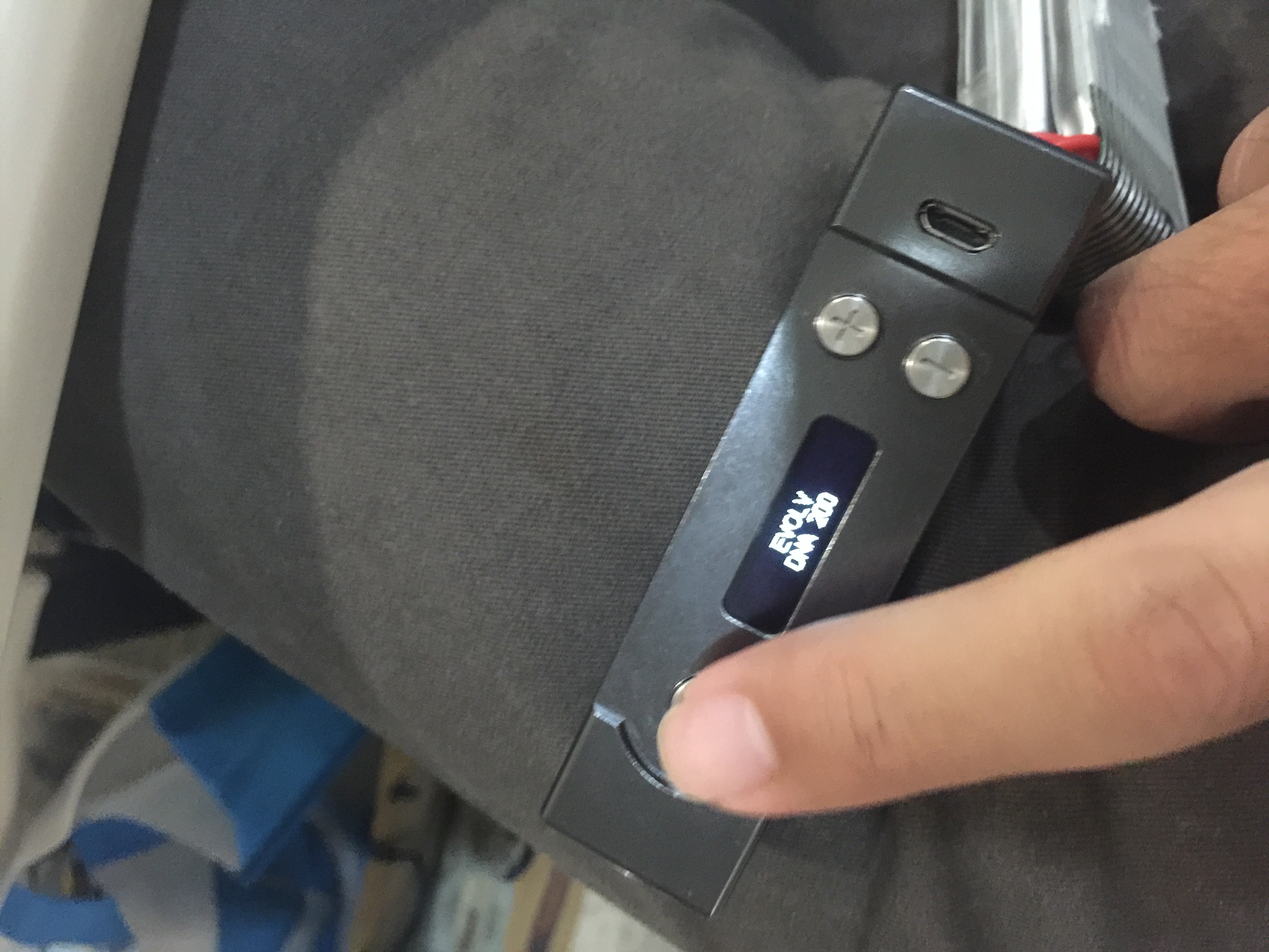

  6. Today I decide to use Ni200 coil after so long using kanthal on my Hana V200, suddenly my screen went blank, press any button and its not doing anything, mod gets warm. Decide to connect to escribe but its not detecting my mod. I remove the battery connection (the white connector only, not removing the left and right solder) for few minutes. Then I connect them back but this time the welcome screen appear for 1second and went blank again. (welcome screen will always appear 1second each time my first time pressing the fire button but thats all the screen will show).Connect to escribe but still not detecting anything, press fire button while connected to usb there is "ticking continuos sound". While in usb I try to put my atty it's auto fire by itself. Looking at the fuse I don't see any problem with it. Can't afford to send my mod back to states from malaysia due to bad currency exchange now, prefer to solve the matter myself due to such foreign exchange problem. Sorry for my bad english. Hoping evolve and any experienced friends in this forum to help me out.
