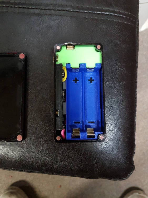

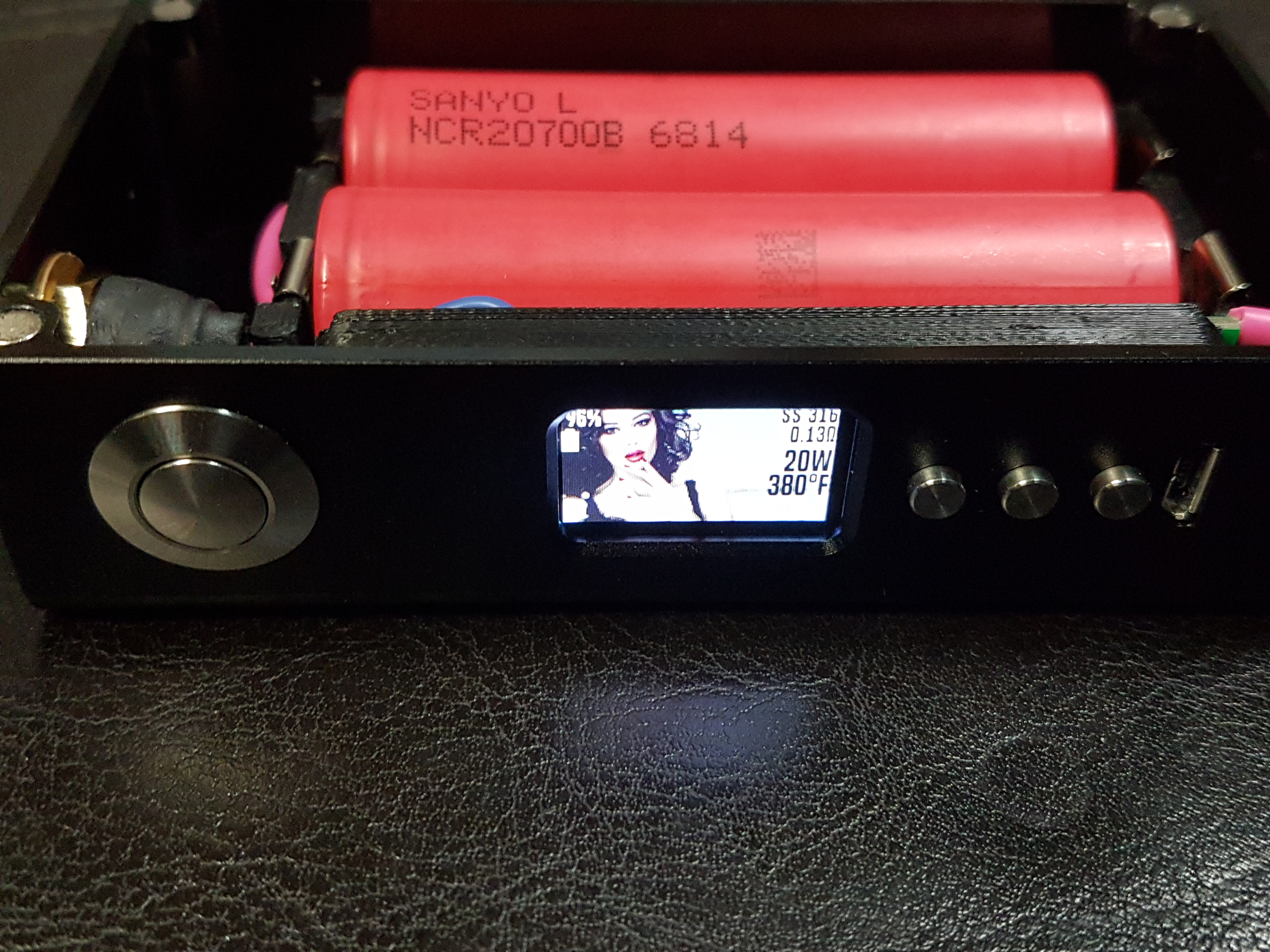

My new DNA 75c that i just finished building with dual sayno 20700b will not charge over 4.16v it keeps turning off the charging at 4.1657v so I decided to try the battery test for the first time and it said waiting to fully charge then started right away im guessing this is fine and that the two battery is just not that great? O and soft cell cutoff is 2.75 that's fine right? Have not used 20700 before

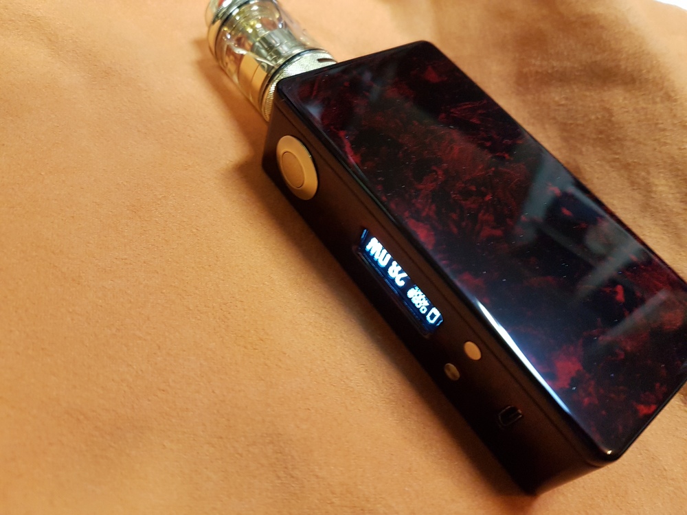

DNA 75 in a g+ alpinetech box way way better then the p box.you can only see the effect in the right light other wise it looks almost black.

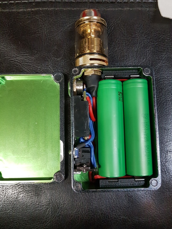

I'm about to start wiring mine up and I too can't get the wire to fit in there and I have a tone of turnigys fancy looking colour wire. 14 gauge no way 16 gauge i can but i have to trim some strands dont know if thats a good idea not a wire expert. Im thinking about just using 18 gauge(pins 7 8 9 10)and then 24 gauge (1 2 3 4 5 6 11 12 13 14 15)for the rest . 4 different evolve boards in the pic hahaha

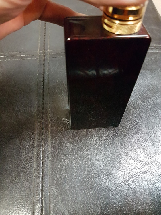

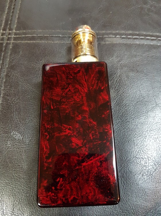

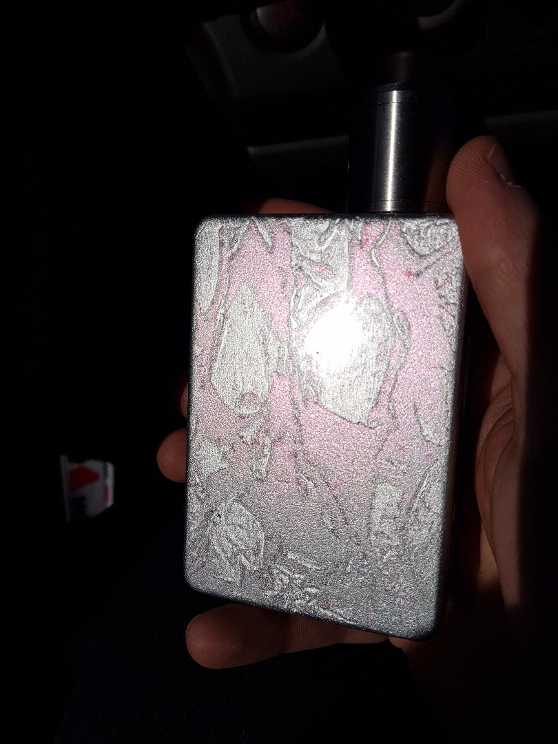

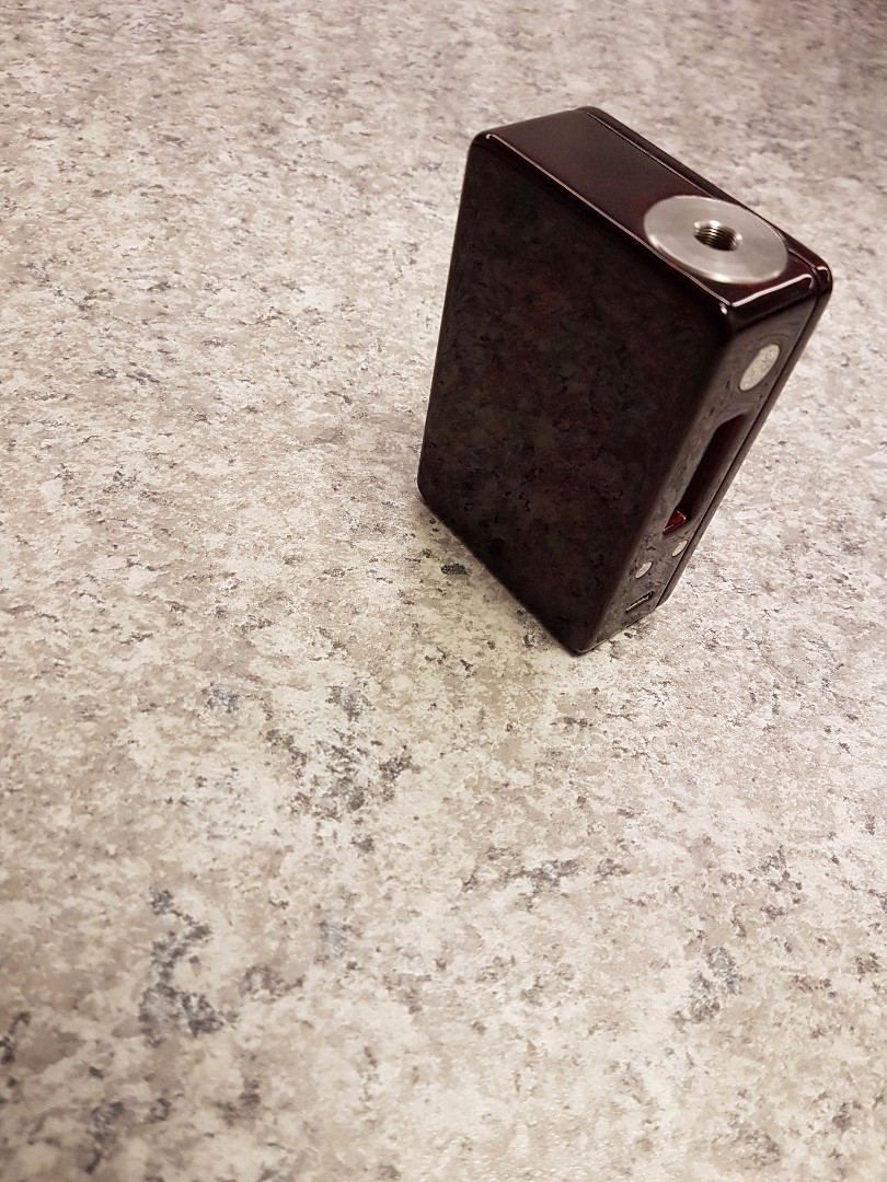

Thanks guy and the awnser your question Urethane automotive paint sprayed on in many layers black then silver then 7 layers of a candy clear coat to make it dark red like that it adds a nice depth to it
Here is my pbox after some improvements I have a silver one like this to but haven't taken any pics yet

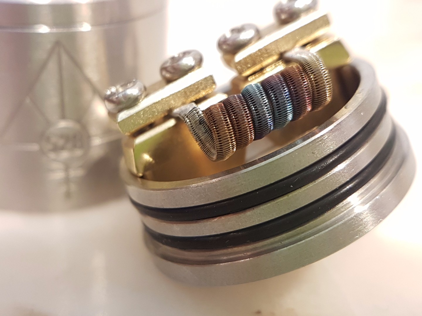

I use kidney puncher ss wire. The pics below are .4 ribbon wire ss with some 40g ss wire and some 28g ss. There are so many builds out there but I have been enjoying staggertons 6 wrap around a 3/32 drill bit ohms out at .14 for a single coil in the goon and I use djlsb smy dna75 profile for ss316L and everything works like a dream best vape that I have had -

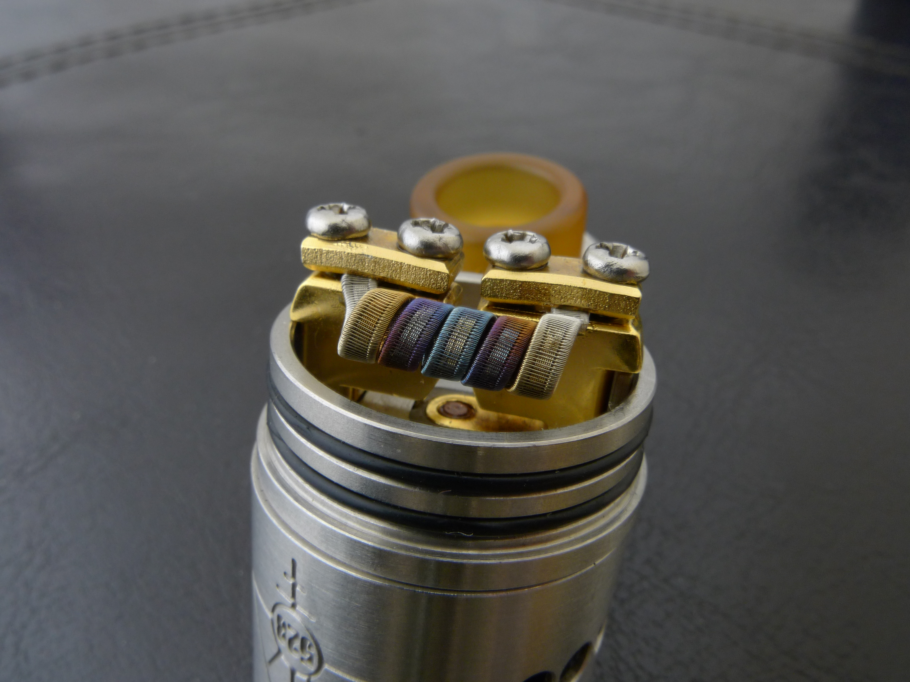

i used titanium for a while too but wont touch the stuff anymore. i have been using ss316L for about 8 months now and i could not see myself switching to another wire now. whatever you bought i would just toss it. I have no problems with any ss coils on my dna 200 or my dna 75. It usually depending on the coil im rocking but at 30 to 40 watts at 430 for temp preheats at 20w for 1 second i have a great tasting lots of clouds so a very satisfying vape click on the pic to see some of the coils i build using kidney punchers ss 316L so my wires used in this pic are 26g 28G 40g .4g ribbon all ss
