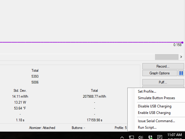

Soft / Hard reboot command issues
giz_60 replied to poornoob159's topic in EScribe, Software and Firmware
It's a reboot...not a reset..if you are wanting to reset to defaults, use the "Restore Defaults" under the General Tab
