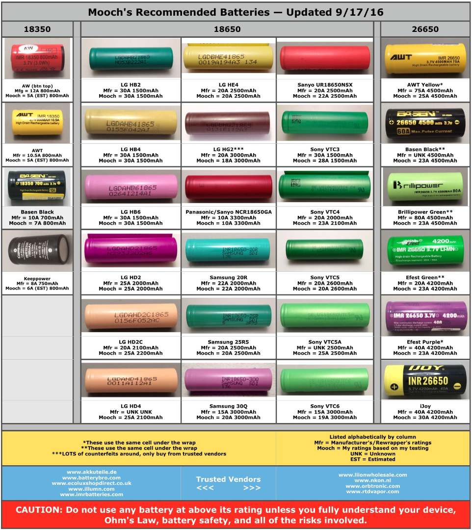

  6. Fakes would be ones that someone has re-wrapped a cheaper battery, but is selling as a name brand...they may work ok, but the ones on Mooch's list have been tested & those are the ones that are recommended for our purposes...I personally use LG HG2, VTC5, VTC5a, VTC6, 30q....If you find them really, really cheap...then they are probably fake..buy from a reputable supplier! A couple of extra dollars will go a long way!!!
  7. Yup...looks good...like I said, if the problems come back, it's probably because of the batteries...the ones you have are probably what are referred to a re-wraps...a battery that has been wrapped with a different cover...no telling what is underneath...
  8. Shouldn't matter, but you should always use the batteries as a married set....charge together...discharge together... The charger should be fine, but would recommend batteries that are on Mooch's list....and make sure you get them from a reputable source..lots of fakes out there
