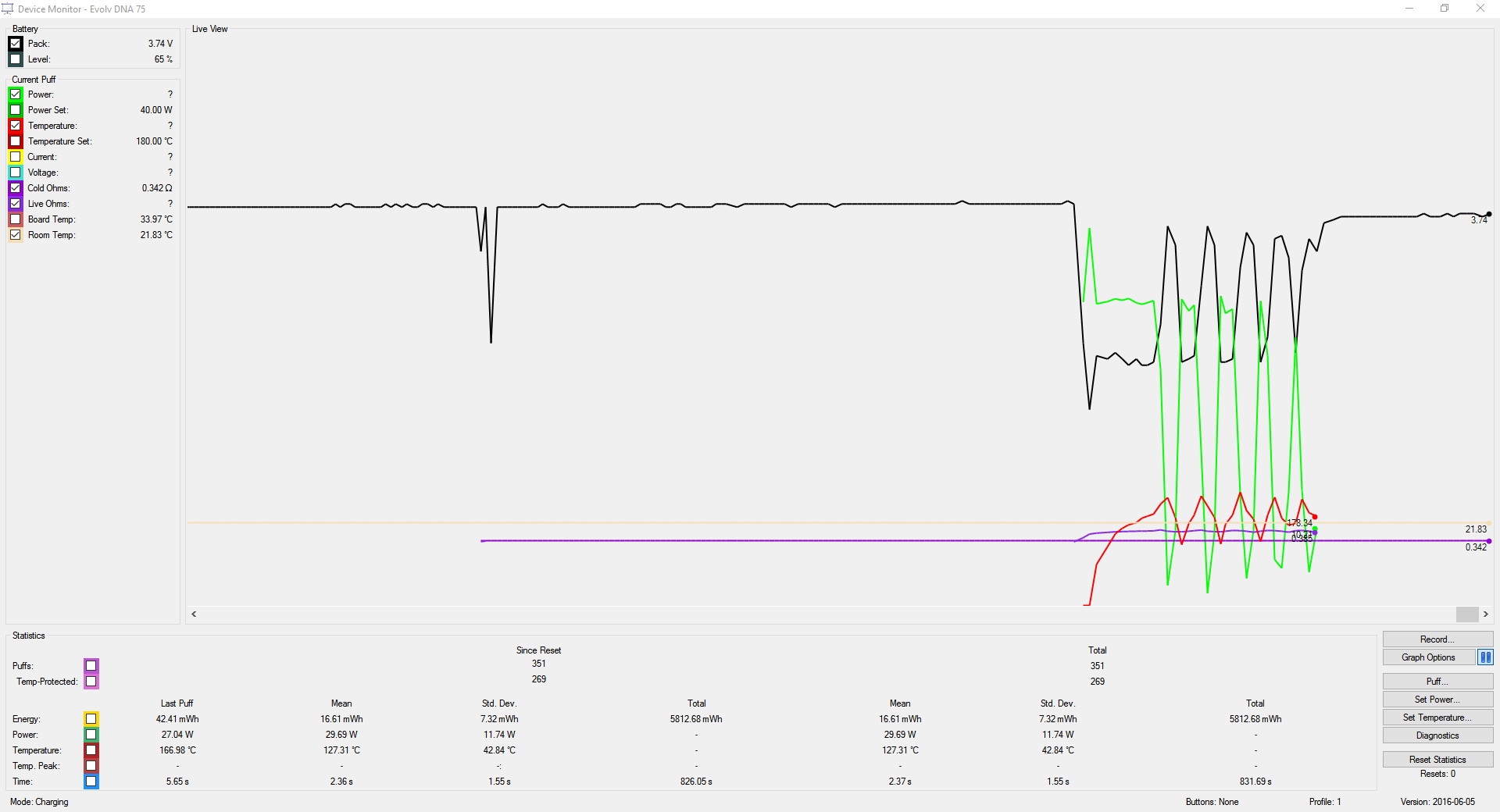

I'm using a Goblin v3 Mini with an spaced SS316L coil of 0.33 ohms. But the problem seems to be fixed thanks to VapingBad. I opened the mod today and tightened the ground screws, one of them was not tightened all the way. Thank you VapingBad and giz_60 for the great support!
I cleaned all the treads but it did not seem to solve my problem. Setting the temp higher also doesnt solve the problem. as soon as it reaches the temp it starts pulsing again. Thank you for your reply's
Hi, I recently bought a VT75 Nano. And i'm having some problems with it. It seems everything is working fine, the ohm reading is stable and i did try to lock the ohms at room temprature but is still seem to be pulsing to keep the temprature. Here is a picture of what I run into.
