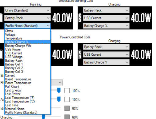

Depends on when you want to see it...all the time,1 setting in all 4 panels...if only while charging, the 1 setting in the right 2 panels (but raise the brightness)...if only while in normal operation Temp mode, 1 setting in the top left panel...if only in Power (watt) Mode, 1 setting in the bottom left panel...

If you look at the material profile, 'General Tab', that you are using, you probably have that profile set for Temperature Dominant. That will show the temp on the right side of the screen & will automatically change from temp on the left to wattage...if you uncheck the temperature dominant in the profile, you will see the wattage on the right & the temp on the left
In TC mode, the device is only going to use the wattage necessary to achieve the temp you have it set for...so, lower desired temp, less wattage...higher desired temp, higher wattage...if you have the material profile set for Temperature Dominant & on the 'Screen' tab in Escribe, if you set the field on the left to 'Temperature (standard)', then it will show the wattage you have it set for, but when firing, it will show the wattage actually being used to achieve the desired temp...after firing, it will go back to showing the wattage you have it set for...if you have the field to the left set for 'Last Power' , then you are going to see the actual wattage that was used to achieve the desired temp...hope this made sense...
