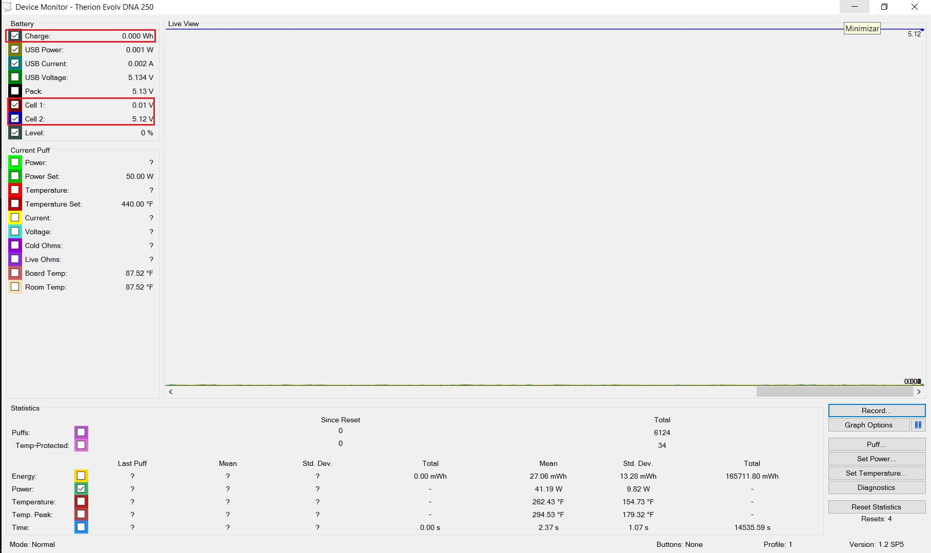

  1. Hello All / Evolv, I will describe the problems found in my new therion 166W DNA 250, Until today it has worked correctly without any problem.. but since yesterday, I'm observing on the screen that the battery indicates to be empty, when turns on the mod the screen shows check battery. Description of the problem (check battery): Investigating the problem... I am observing in the Device Monitor the cell 1 has only (0.01V) voltage constant and the cell 2 marks constant too 5.2V, I have checked the Batteries (2 sony vtc6) are correctly loaded in another mod. I tried to exchange them but without success, I have verified that the batteries are working correctly in other mod, When I disconnect the mod from usb / electrical grid it goes in the off state. Any ideas?, Someone has happened to this same ?, what can I do? Attached screenshots of state.
