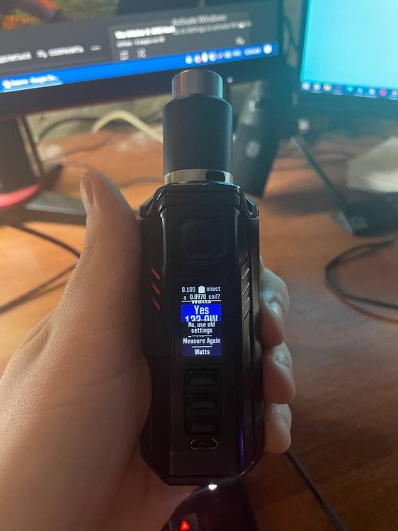

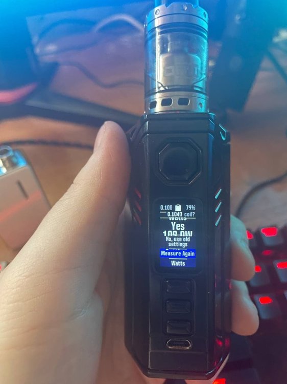

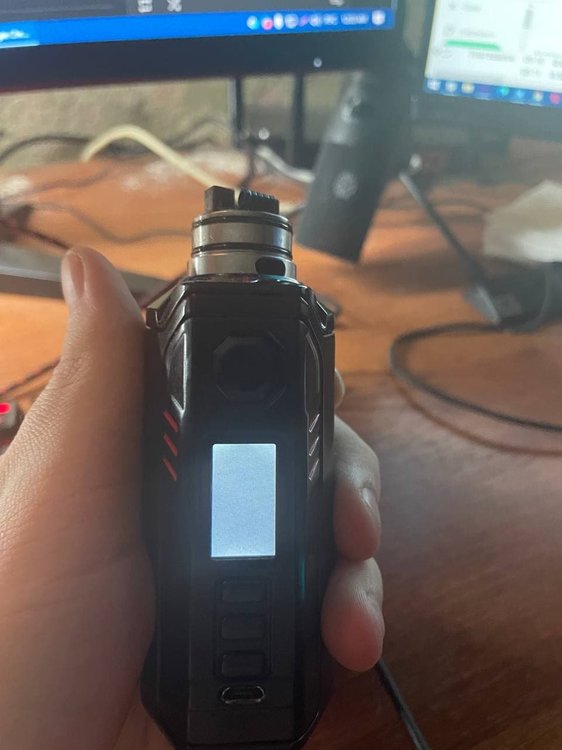

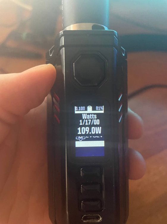

Alex999 Posted August 17, 2021 Report Posted August 17, 2021 Hello. A couple of months ago I bought a Think Vape Finder with DNA 250C. After a month, it became often did not turn on, I had to pull out the batteries many times, sometimes it took me 10 minutes to just turn it on (Then I found a way to turn it on faster, I need to turn on the micro USB into it and it will work immediately in 50% of cases). Two weeks ago, the screen stopped working normally, there is nothing to explain, I will just show the photo. I mean it works, but what happens to it is not normal. Is that a faulty board?

Wayneo Posted August 18, 2021 Report Posted August 18, 2021 @Alex999 you never did say what Service Pack is on your mod. Needing to plug into the mod was an issue long ago that was fixed. You can see that in Device Monitor, bottom right hand corner. That screen glitch, I think could be juice in/on the Zif connector that attaches the screen to the board. I'd remove it, then clean or reassemble. If that doesn't work I'd buy a new screen. Screens are not a warranty item. Good luck.
CMK Posted August 18, 2021 Report Posted August 18, 2021 vor einer Stunde schrieb Wayneo: That screen glitch, I think could be juice in/on the Zif connector that attaches the screen to the board. I'd remove it, then clean or reassemble. If that doesn't work I'd buy a new screen. Screens are not a warranty item. As far as I interpret the photos correctly, different fields, even different screens are displayed at the same time, which should not be displayed at the same time; It is therefore not a matter of a fault in the display, but of the control. The error can only be in the firmware, the theme, or directly in the chipset. You can actually exclude the connector from the board. 2
