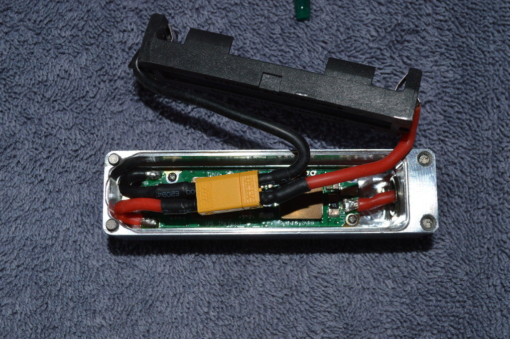

Wayneo Posted September 1, 2019 Report Posted September 1, 2019 @drewk1 Have you checked local UK stockists, and which ones? Edit: Easier than a 3D print you can check the respective datasheets here. https://www.evolvapor.com/ IIRC The 250, 200 and 75 share the same width and screw hole dimensions/location. The 75 is a tad shorter as there's no JST connection on the board.
awsum140 Posted September 1, 2019 Report Posted September 1, 2019 FWIW - I've installed DNA75 boards into ERM, DNA200/250, enclosures with no problems. Screen, fire, up, down, mounting holes all line up perfectly plus you have the extra space at the bottom since, as Wayneo says, there's no JST connection because it's a single cell device. ft
