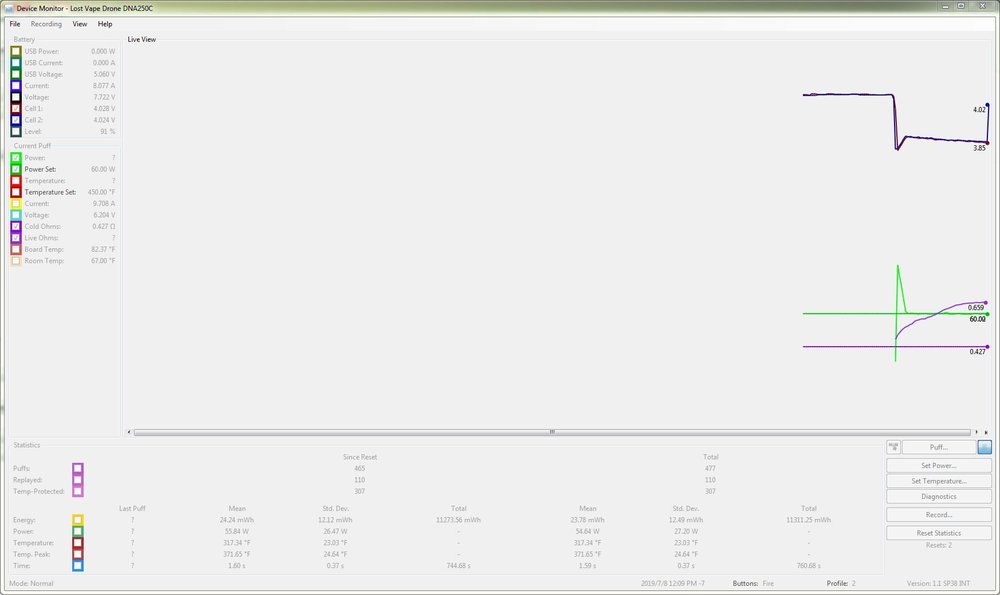

franticseven Posted July 7, 2019 Author Report Posted July 7, 2019 On 6/16/2019 at 1:23 PM, Wayneo said: YOU need to read and set the resistance in each profile you're using that coil. New coil, or not That alone might fix the majority of your issues. Expand as I said 'it reads under on resistance, constantly but won't register the correct res even if the atty is removed and re-set.' yes I get that bit, you have to confirm the resistance of each coil new or old; unlike the DNA200 which usually automatically reads and sets the base resistance if its within the pre-defined % perameter. Also if you fire-remove the atty, put the warm TC coil back on the DNA200 you're asked new/old. The TVF 250/300C doesn't appear to allow any deviation, burn and pinch in a Kanthal or NiChrome coil and when the resistance changes...it asks new or old resistance. Must be a PITFA nanny/safety feature for newbs who simply screw in a new throwaway coil and never learnt to check new builds for shorts on a tester? But my issue is that it lags, compared to other DNAs it reads a lower resistance AND appears to waver AS IF it cant differentiate between actual and displayed. A base resistance error? Escribe shows no atomiser instability, theres no unbalanced sag under load, coils are twisted .30 ( 0.23 ohm SS316 & 0.35 ohm NiCr ) so not super low or overly heavy. So ? Weak solder..loose earth.... iffy fire button.. 510?...software...board? A dismal mod?

Wayneo Posted July 8, 2019 Report Posted July 8, 2019 The colour boards operate differently compared to the non colour boards. After working out hotspots, etc. as I already said, re-read the atty while on the mod (Kanthal/NiCr). How much of a lower resistance and what kind of atty with that NiCr coil? I'm hoping you're checking stability using 'Atomizer Analyzer'? What do you mean it lags? What version of firmware is on your mod? PS It's hard to separate the wheat from the chaff in your posts. And that was four (4) questions I asked.

dwcraig1 Posted July 8, 2019 Report Posted July 8, 2019 Poor connections between the cells and board need to be ruled out. You should be able to get your full power setting in non TC until your cells sag to below the Cell Soft Cutoff. The misfiring , does that happen when using EScribe to fire it? Would you post a snippet like this one?
retird Posted July 9, 2019 Report Posted July 9, 2019 And I assume you have ran Case Analyzer on the 250C as you may have done on the 200's. Yep one should not carry bare batteries in one's pocket nor charge batteries while unattended....
