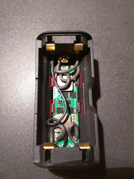

Baxter Posted July 30, 2019 Report Posted July 30, 2019 Am 25.2.2019 um 11:30 schrieb baher: hello everyone i wrote before about the screen problem with my paranormal as i have lost couple of screens till now, i bought a rebel mod dna250C 21700/20700 and i had the same problem, the screen started to shudder then it faded out and it only works while pressing the fire button (not on stealth mode) then it started to work again but as a white screen nothing appears on it, i sent rebel and esauce about my problem but the customer service their sucks they never replied and that is the usual action from them , i had another new screen so i replaced it and till now it is working fine but i hope it will continue, i guess evolv should try to find out what is happening with their screens have a nice day guys how did you manage to get the board out of the rebel mod? i don't know what to do with these "hooks" and am afraid they will break. mine is a rebel mod 200w with dna 250c. white screen/pixel errors since yesterday.
VapingBad Posted July 30, 2019 Report Posted July 30, 2019 Not got one, but looks like those tabs are the screen holder, try removing the 3 hex screws holding the board down I suspect it will lift easily after that and you will be able to change the screen easily. ETA You can see the lower screw in the bottom left of the photo, the other two are in the top corners of the board. 1
baher Posted July 31, 2019 Report Posted July 31, 2019 4 hours ago, Baxter said: how did you manage to get the board out of the rebel mod? i don't know what to do with these "hooks" and am afraid they will break. mine is a rebel mod 200w with dna 250c. white screen/pixel errors since yesterday. 1st you have unscrew the 3 screws then take out the battery connectors from their place and u will find the board coming out. those hooks are the screen holder hooks to attach it to the board. Don't worry after taking out the battery connectors and the screws it will be so easy . 1
Baxter Posted July 31, 2019 Report Posted July 31, 2019 Thanks for your answer and help. that sounds easy. will solve it on my own. thank god i haven't bought the extra warranty from esucks 😎

Baxter Posted July 31, 2019 Report Posted July 31, 2019 i have ordered the display and will report when i have changed it.
Baxter Posted August 13, 2019 Report Posted August 13, 2019 Thanks for your help. I just swapped the display.
