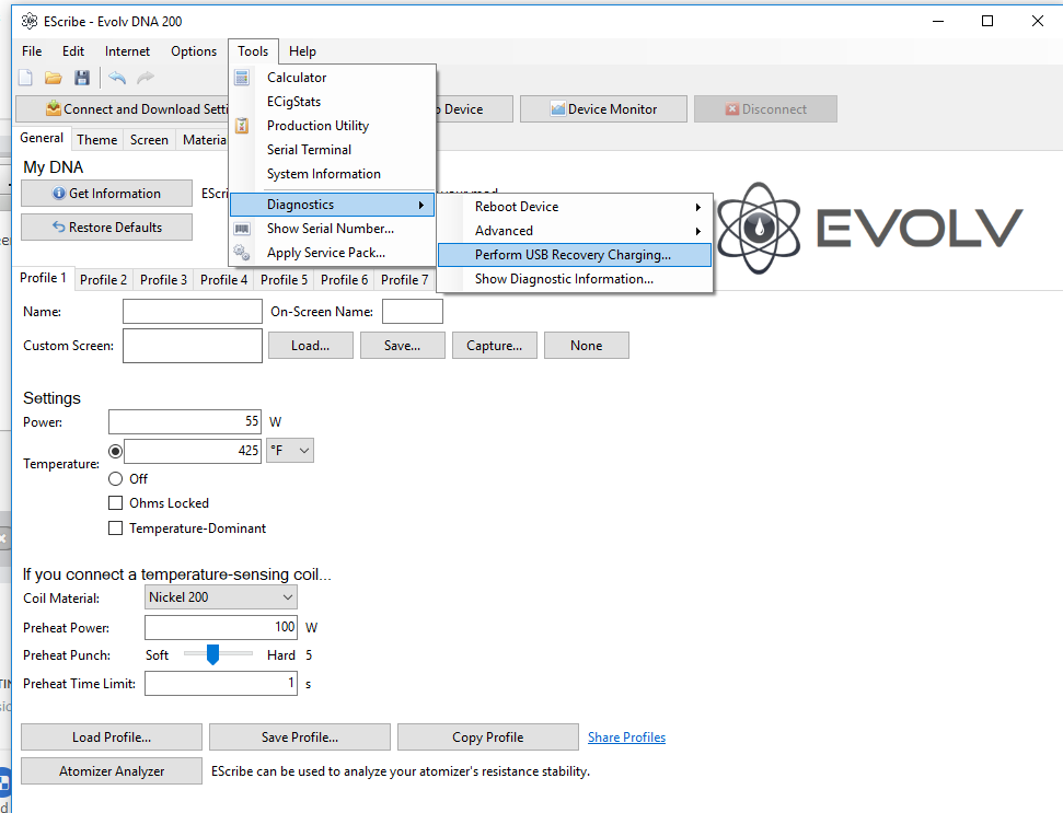

retird Posted May 23, 2018 Report Posted May 23, 2018 It seem that the common theme of the ones that don't charge is that all batteries are almost completely discharged.... setting on the shelf for extended times allows the batteries to drain as a very small current drains continuously but takes a long time to get to the point your's are at... when the voltage of the battery gets that low the charging circuit will not charge them.... you might try recovery... if that doesn't work replace the batteries...note that the recovery charging process takes a long time....
Conanthewarrior Posted May 23, 2018 Author Report Posted May 23, 2018 I have tried recovery charging, but it doesn't look like it is working- the Amps are at something like 0.020! Or is this really how long the recovery charge takes? I have 38 mods, so it is likely the batteries have become discharged as mentioned. I try to rotate my mods to use 5-10 each month, and wanted to use my DNA mods this month. I will keep recovery running and hope it works. I have a spare pack for the Efusion, but not for the Hotcig- the batteries are weird in a very small housing.
retird Posted May 23, 2018 Report Posted May 23, 2018 Recovery takes a LONG TIME and most times it isn't successful and sometimes you have to run it more than once.... hopefully your spare pack isn't discharged also....
Conanthewarrior Posted May 23, 2018 Author Report Posted May 23, 2018 Right it is working for cell 3, it is up to 3V now, but the other two are falling- is this normal, and they will balance out by the end of the recovery?
retird Posted May 23, 2018 Report Posted May 23, 2018 It should be balancing if the cells are able to be recovered......
