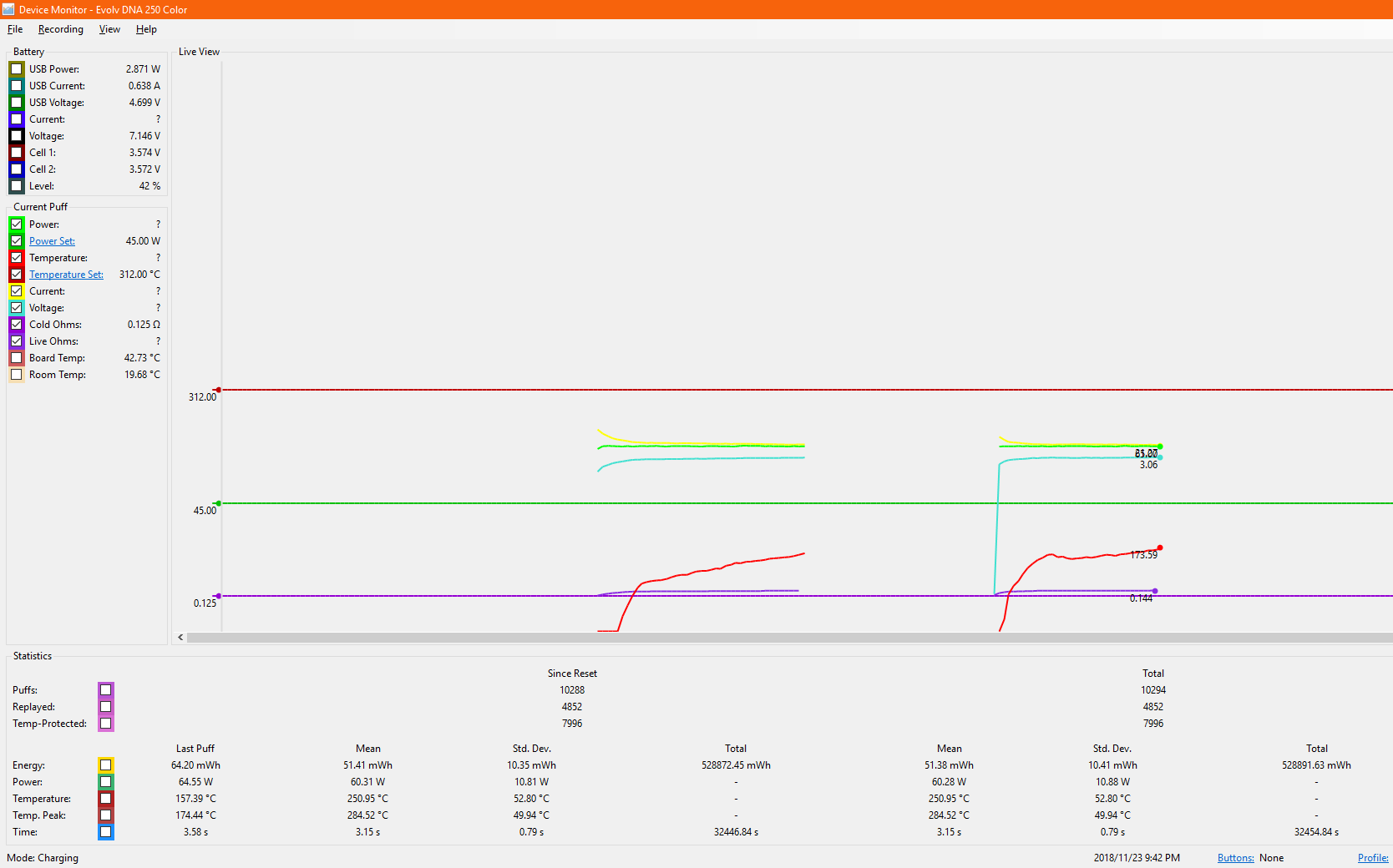

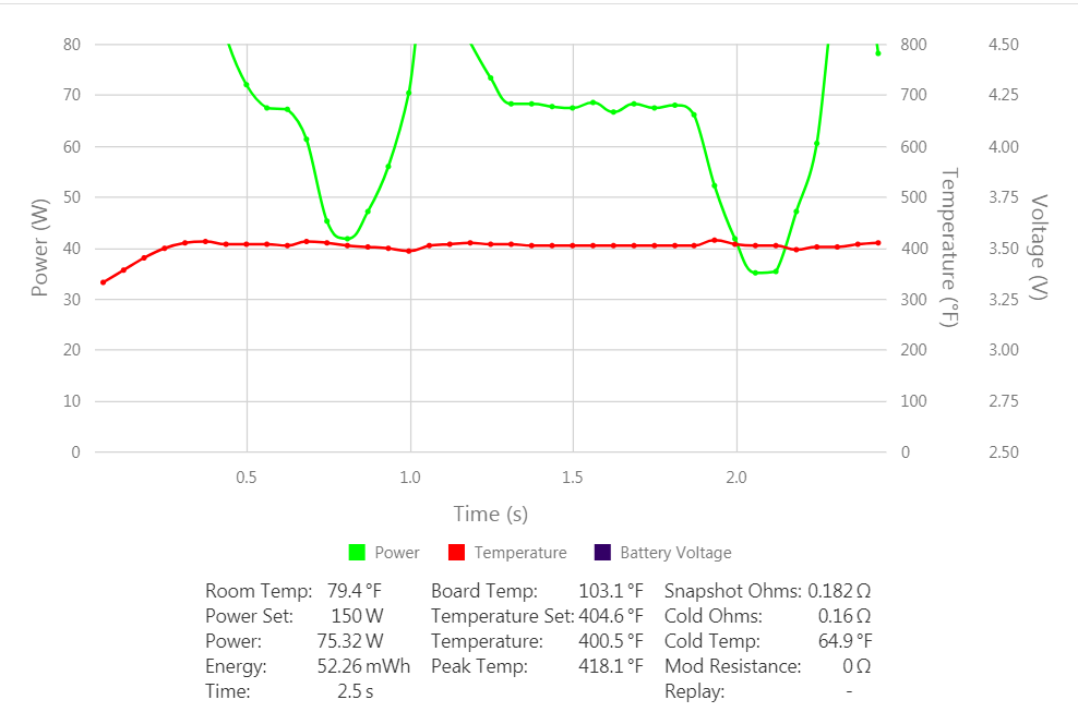

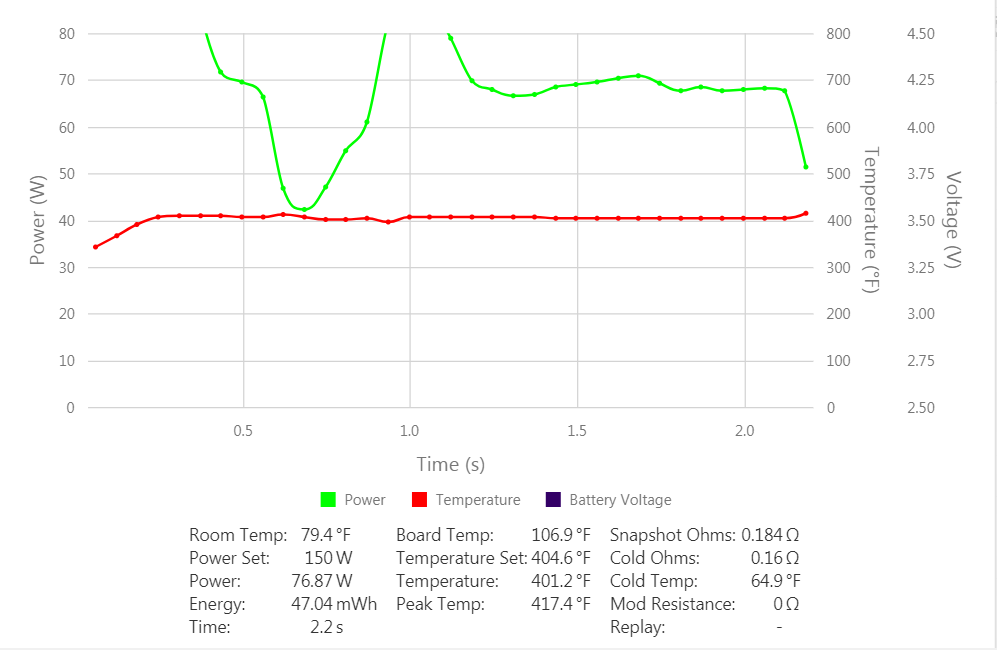

Darkstar_ Posted November 23, 2018 Report Posted November 23, 2018 (edited) Well, after using the other posted firmware I had no issues. Yet today as soon as I change my coil, it starts to happen again. No reason behind it. Tank can be full of juice or nearly empty. Be charging or not. I have no idea what causes it and it's really annoying as I paid (what I consider) a lot of money for this and I have to use it in wattage mode going forward. Here is a normal puff Here is "temp protect" Doesn't show me anything I can work off. Edited November 23, 2018 by Darkstar_ Images added

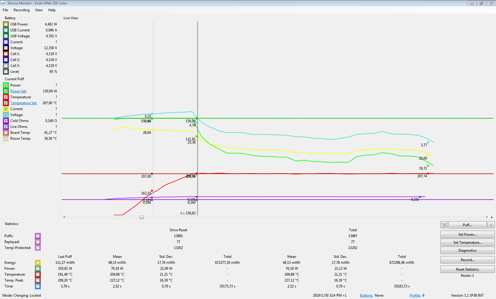

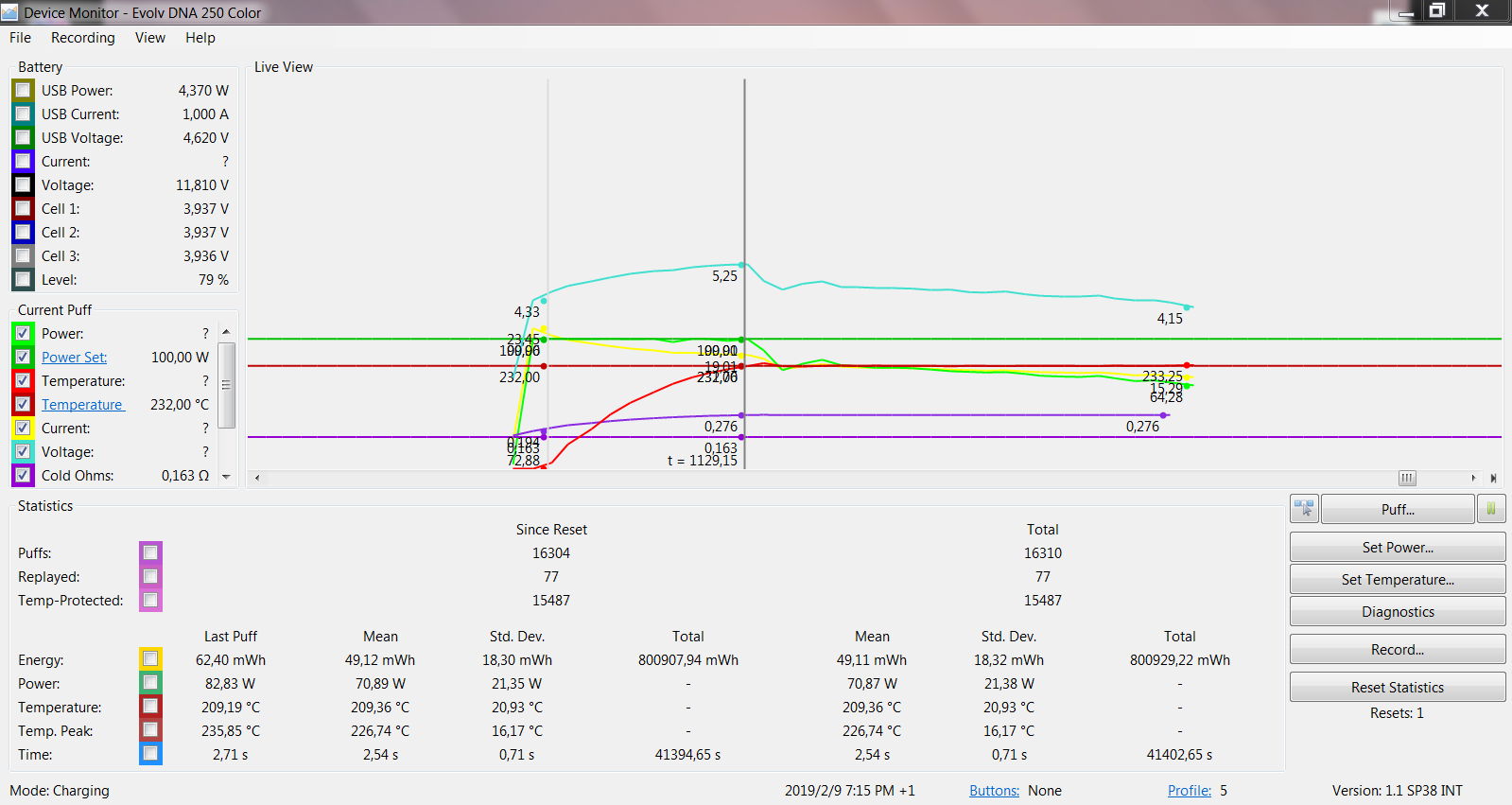

Quipu Posted January 30, 2019 Report Posted January 30, 2019 This Is a theme I modified a little bit. And on the monitor is no more cut off aka temp-protect, on the beginning of inhaling or middle of inhaling like was to be, random. On the monitor I see temp-protected 13202 times of 13961 puffs, I don't have so many cutoffs for sure, the board maintains the desired temp flawlessly when I changed to SP38 and checked tank connections. Maybe mod hit temp-protect but without cutoff, just maintaining the temp as it should. Firing without inhaling nothin just staying around 207*C until it finishes 10s. Evolv Default Enhanced 250C modified.ecigtheme

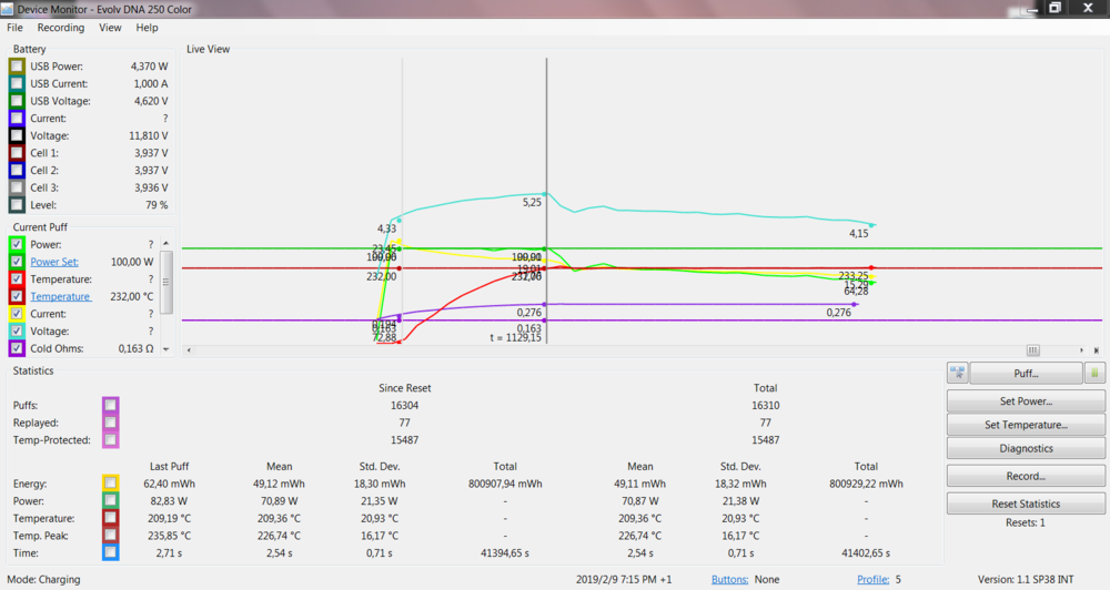

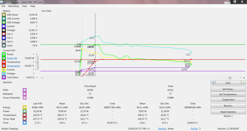

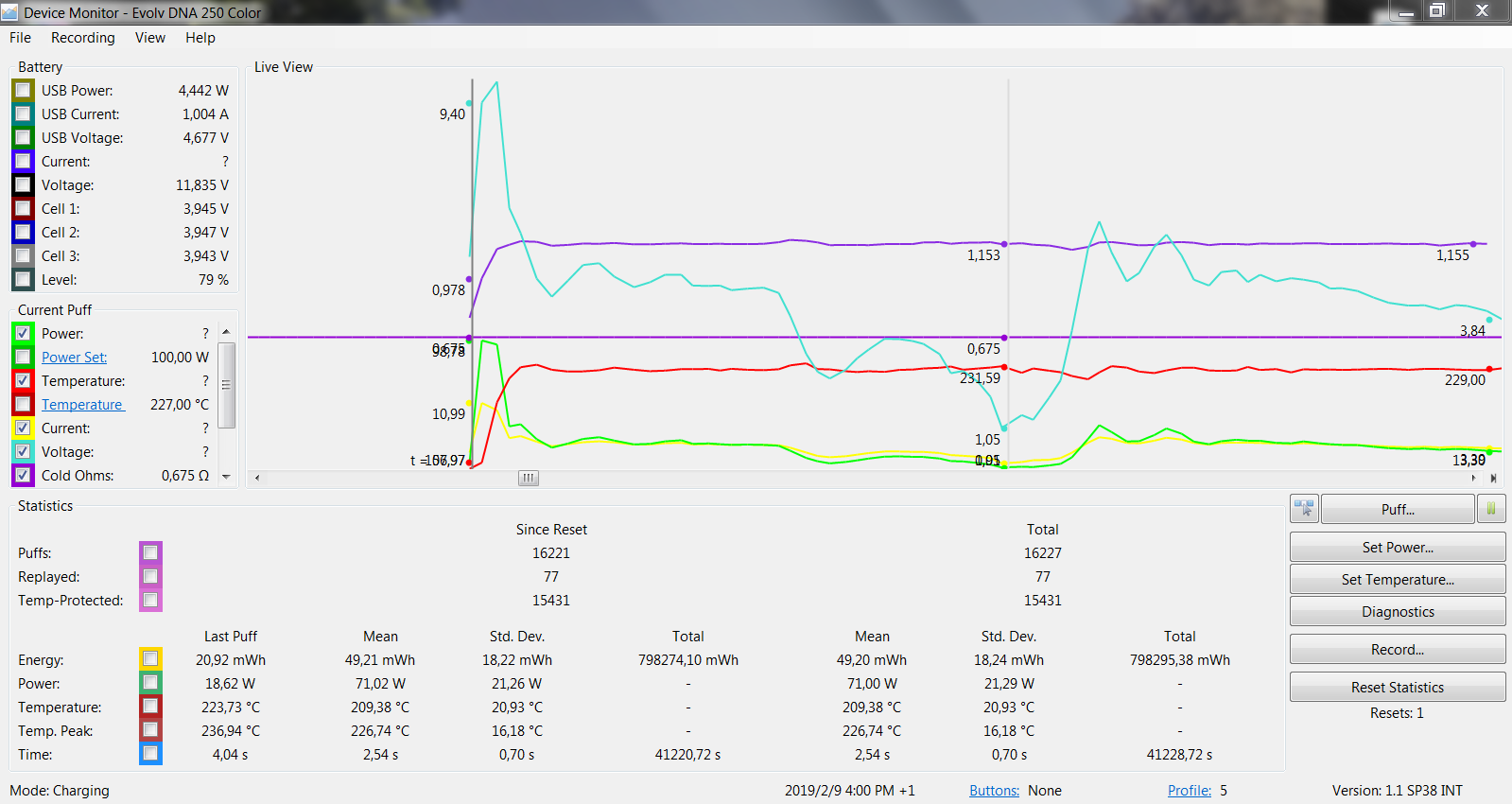

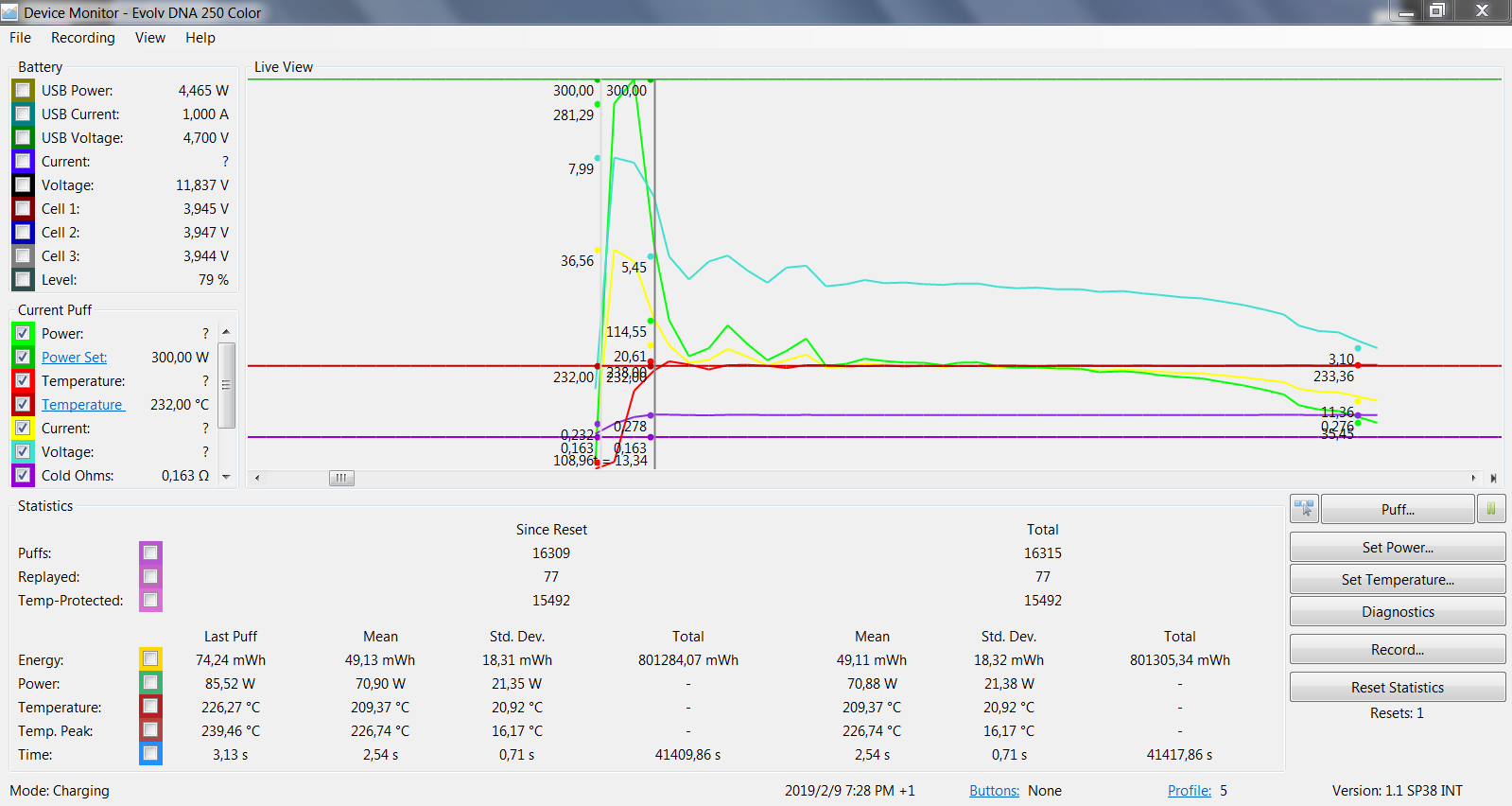

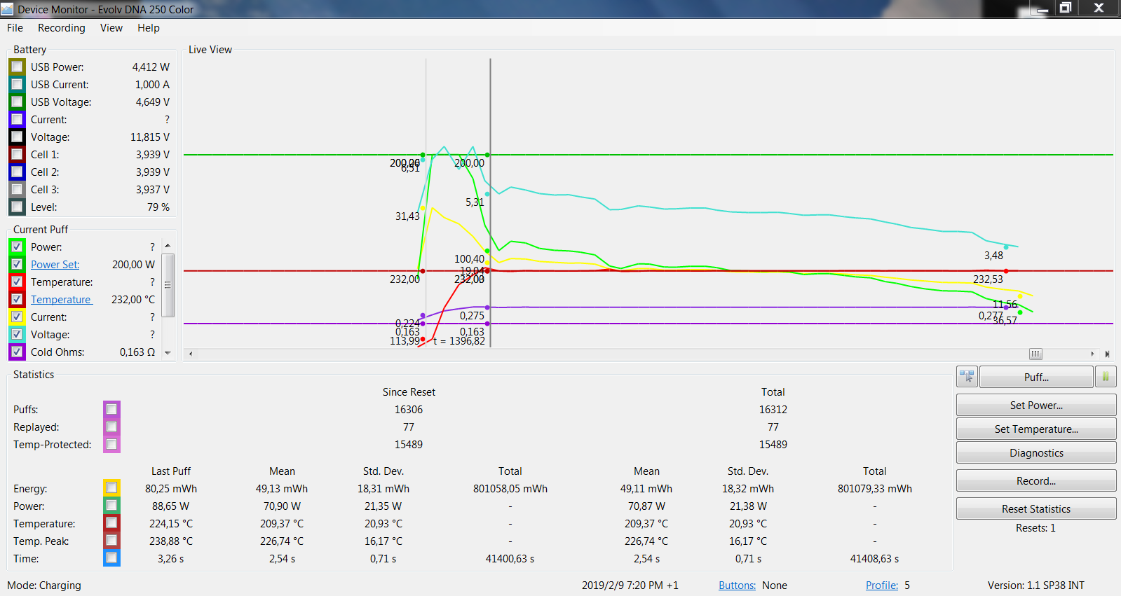

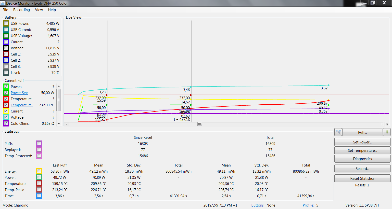

Quipu Posted February 9, 2019 Report Posted February 9, 2019 I tried with a .5 ohm coil exactly .675Ω but with titanium single coil. Without wick dry, blowing. Don't have an SS wire for now. On the other hand, don't know what is the purpose of preheating or punch etc. in TC. You can see when available watts is increased, the graph of temp. curve becomes steeper in time. At 50W even can't reach the desired temp. So just with Watts arrangement in TC mode, can be set how strong, sharp vape will be, and for me as an ex-smoker, I like immediately with no delay like a real cig. Dual Ti coils @ .163Ω With wet wick assembled atomizer same intensity of draws. Nothing from Temp Pro. cutoffs Anyway, maybe somebody will find this helpful. Cheers.
