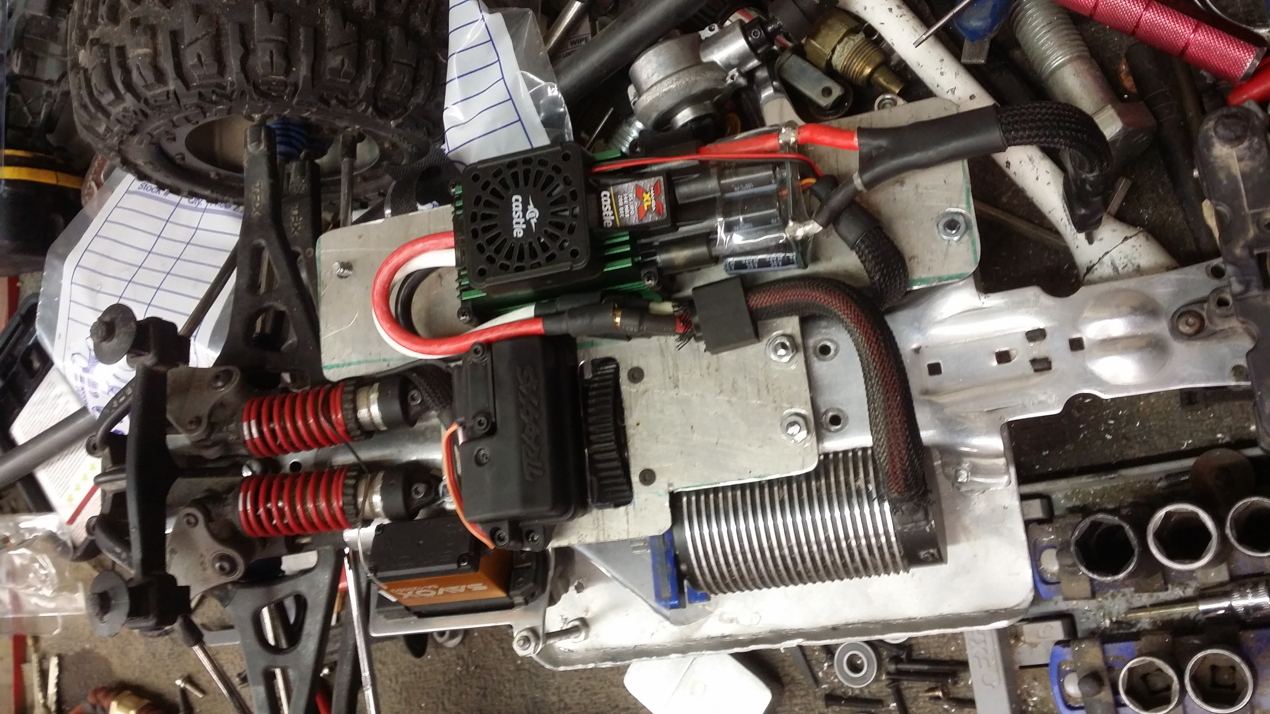

67exec Posted May 9, 2018 Report Posted May 9, 2018 @gizman, I didn't find a battery by my prefered manufacturer to fit your bill. My dislike for Maxamps came from my rc experience running my 15lb monster. 3 separate times I had Maxamps 4s lipos crap in less than a month, plus they couldn't deliver the amperage I needed from packs rated 3x what the max of my esc is. SPC Racing was my brand of choice until they closed up shop, now turnigy seems to be the only packs that can reliably feed my beast and hold up for over a year. It's a nitro revo converted to electric. Mamba xl extreme esc with datalogging, castle 1717 motor from XO-1, diffs from a losi xxl, and 1/4" keystock with impact wobble sockets for driveshaft. 1
gizman Posted May 9, 2018 Report Posted May 9, 2018 2 minutes ago, 67exec said: @gizman, I didn't find a battery by my prefered manufacturer to fit your bill. My dislike for Maxamps came from my rc experience running my 15lb monster. 3 separate times I had Maxamps 4s lipos crap in less than a month, plus they couldn't deliver the amperage I needed from packs rated 3x what the max of my esc is. SPC Racing was my brand of choice until they closed up shop, now turnigy seems to be the only packs that can reliably feed my beast and hold up for over a year. It's a nitro revo converted to electric. Mamba xl extreme esc with datalogging, castle 1717 motor from XO-1, diffs from a losi xxl, and 1/4" keystock with impact wobble sockets for driveshaft. I am sorry to hear you haven't had good luck with them. Very impressive, good lord that thing is insane! I haven't been in it since the early 90s, my dad and I built some badass machines for what it was back then. Mad respect though, beautiful beast! 2
67exec Posted May 9, 2018 Report Posted May 9, 2018 On 4s, with a phone inside for GPS speed, she'll do 62mph before she goes airborn. That's about 3/4 throttle.😎 she can pull 2 5yr olds in a wagon for an entire parade route on a single 5000mah 4s batt with power to play at the end 3

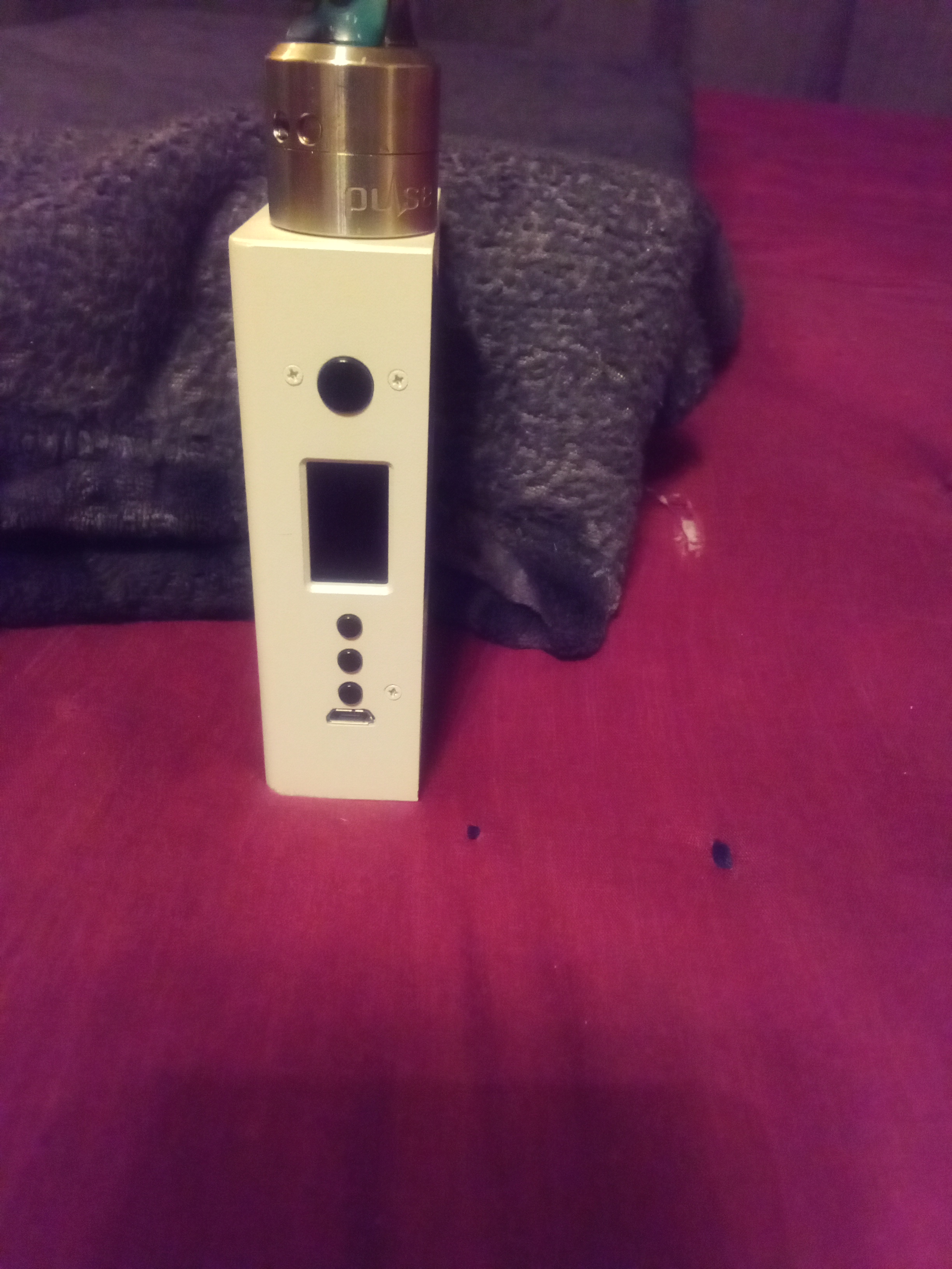

steamer861 Posted May 9, 2018 Report Posted May 9, 2018 23 minutes ago, Crazy_Al said: Sounds like getting some to help with (or just doing) some custom design work isn’t as difficult or expensive as I thought. I have been wanting to buy, build or get built a DNA75 (or perhaps now a 75C) Single 26650 Tube Mod but have had no luck finding anything remotely like it. I was looking at trying to buy an existing SS VV or VW MOD which already had cutouts of a similar size but even finding one of those has been difficult. There was one released a couple of years ago (Can’t remember it’s name or the maker, some Chinese mob I’d never heard of I think) but I can’t find anyone who still has one...perhaps I’d be better looking at getting one designed & “Printed”? Hey Bud If you are looking for a kit to build a 75c? Here a pretty good deal, you can get every thing you need in one kit http://analogboxmods.ca/Box-Mod-Kits/DNA75-Kit You have several options, I build an ABM1 with a FD 510, a ABM battery sled & external chip mount. It's a nice small sized box that fits a 21700 battery. Here's a few pics of mine Thats a Hana Mod DNA200 beside it for scale You can Email Them with Questions before you order, if you need Help Dan even has some nice YT videos to Help along the way https://www.youtube.com/watch?v=Y1wwcn39EiI 1

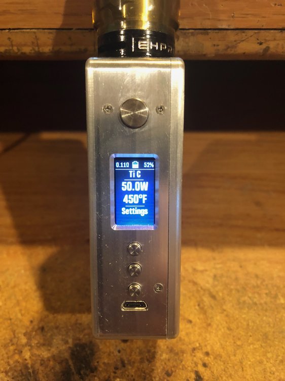

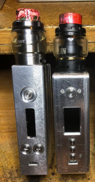

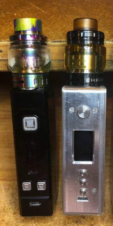

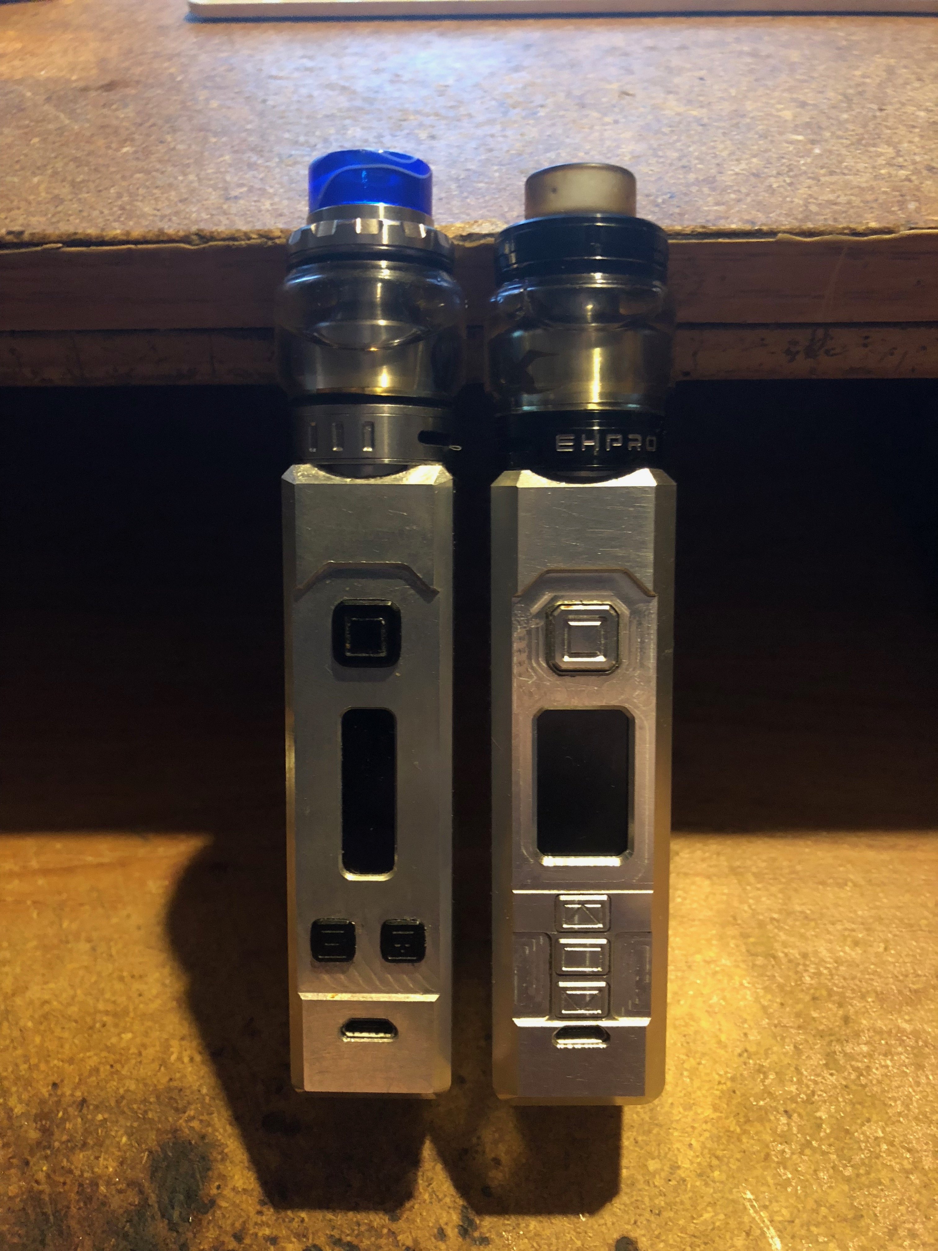

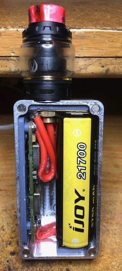

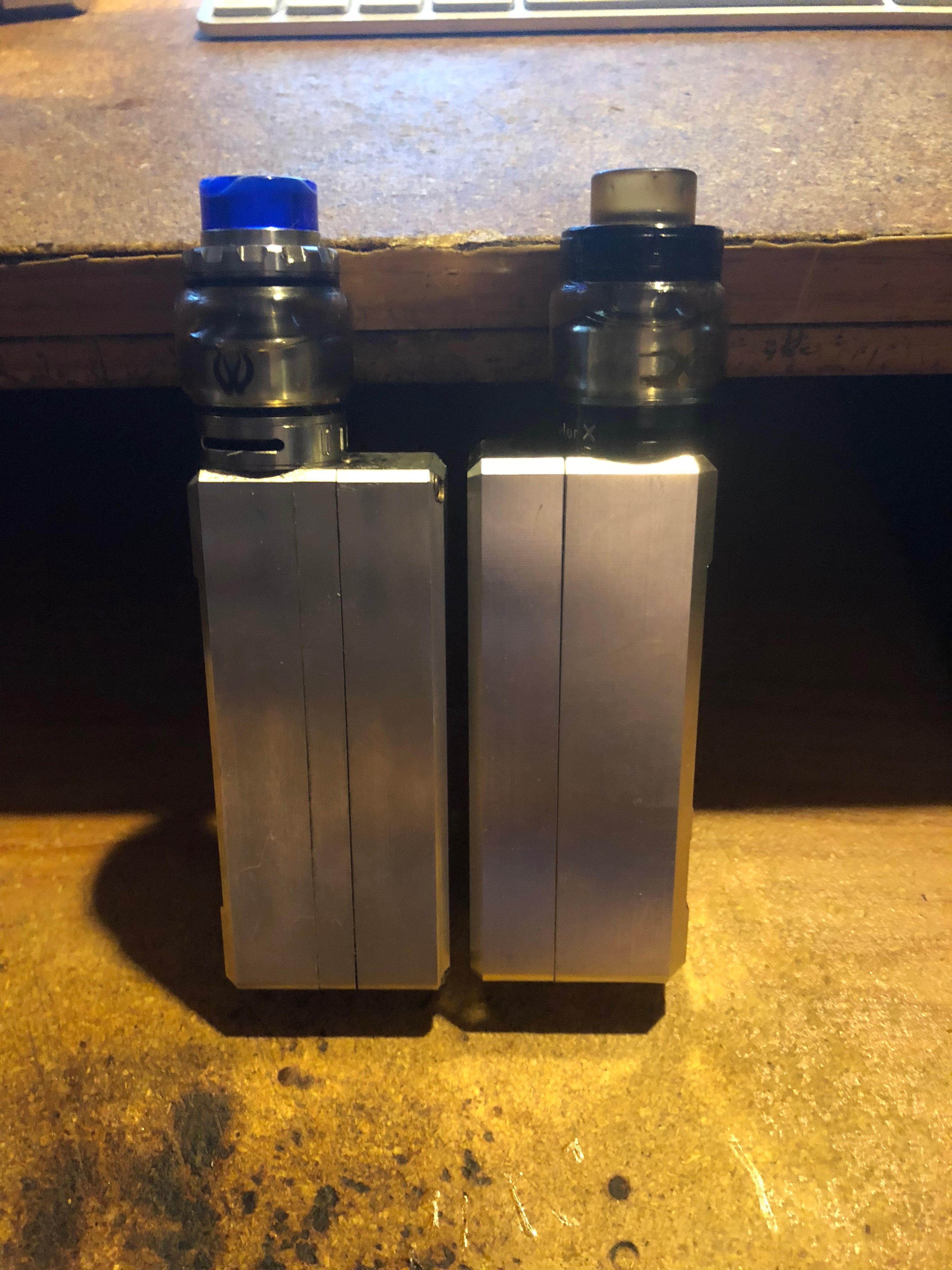

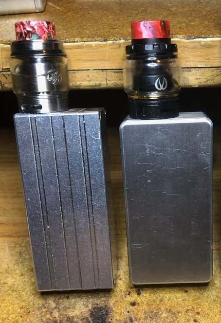

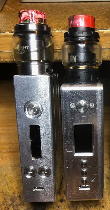

gizman Posted May 9, 2018 Report Posted May 9, 2018 3 minutes ago, steamer861 said: Hey Bud If you are looking for a kit to build a 75c? Here a pretty good deal, you can get every thing you need in one kit http://analogboxmods.ca/Box-Mod-Kits/DNA75-Kit You have several options, I build an ABM1 with a FD 510, a ABM battery sled & external chip mount. It's a nice small sized box that fits a 21700 battery. Here's a few pics of mine Thats a Hana Mod DNA200 beside it for scale You can Email Them with Questions before you order, if you need Help Dan even has some nice YT videos to Help along the way https://www.youtube.com/watch?v=Y1wwcn39EiI I may need to look at that for my wife, she loves her 75c's 1

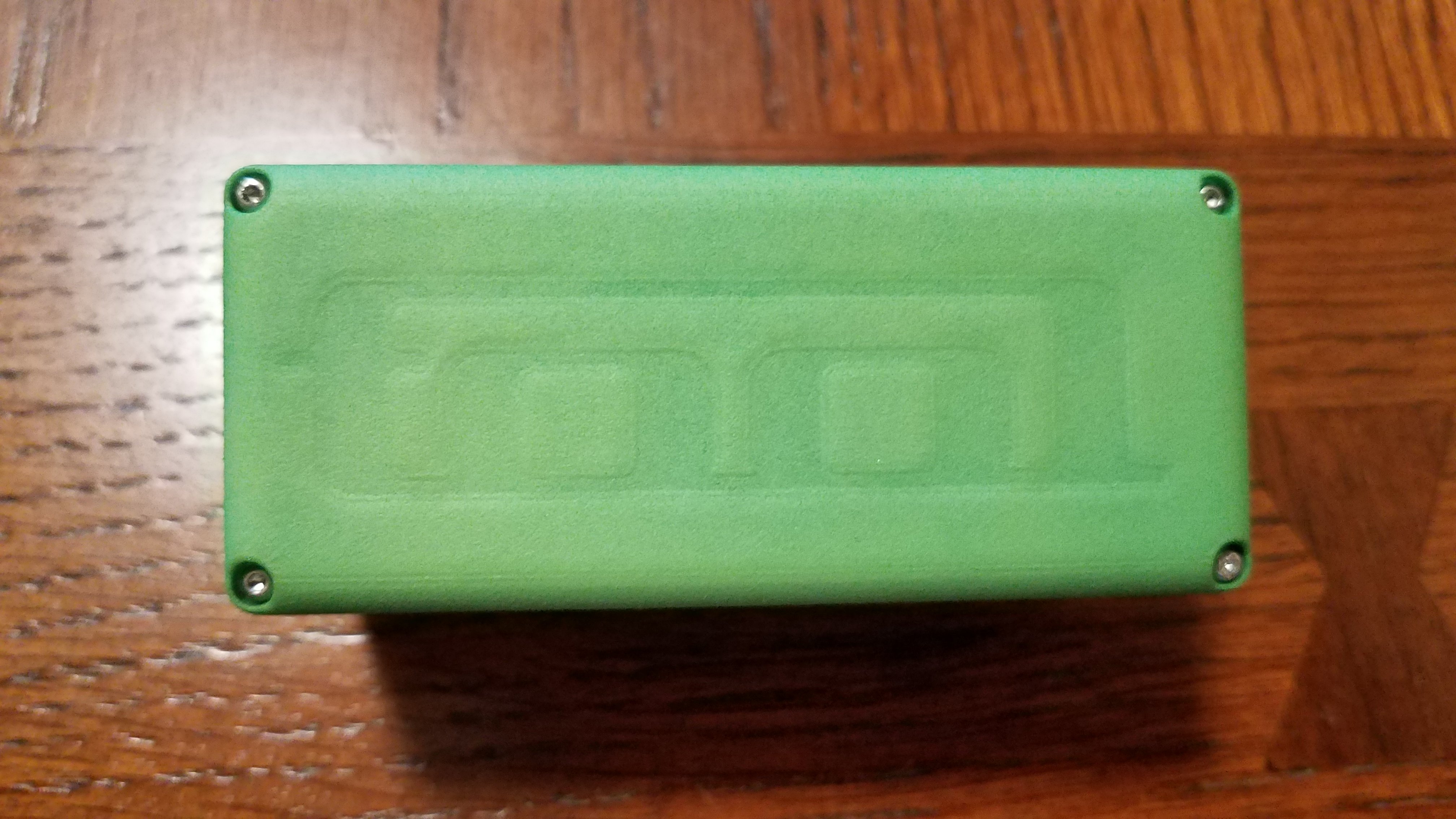

gizman Posted May 19, 2018 Report Posted May 19, 2018 Loving this mod, turned out great, ty Frogmod! 1 1

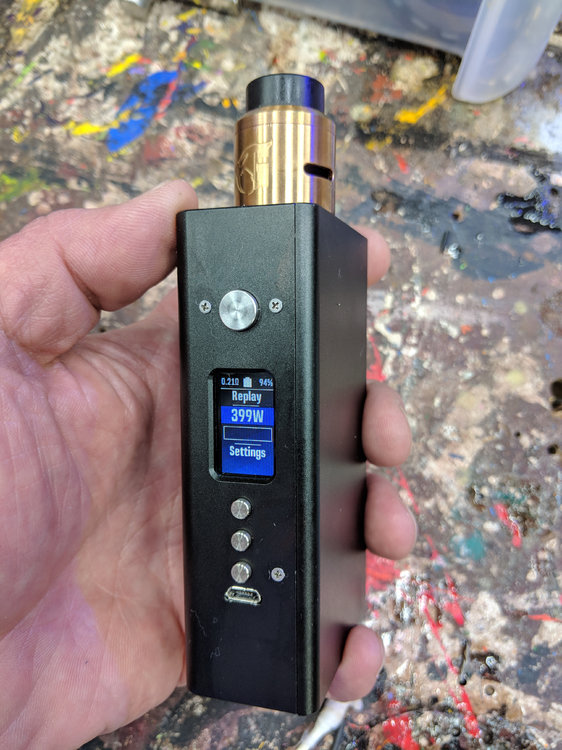

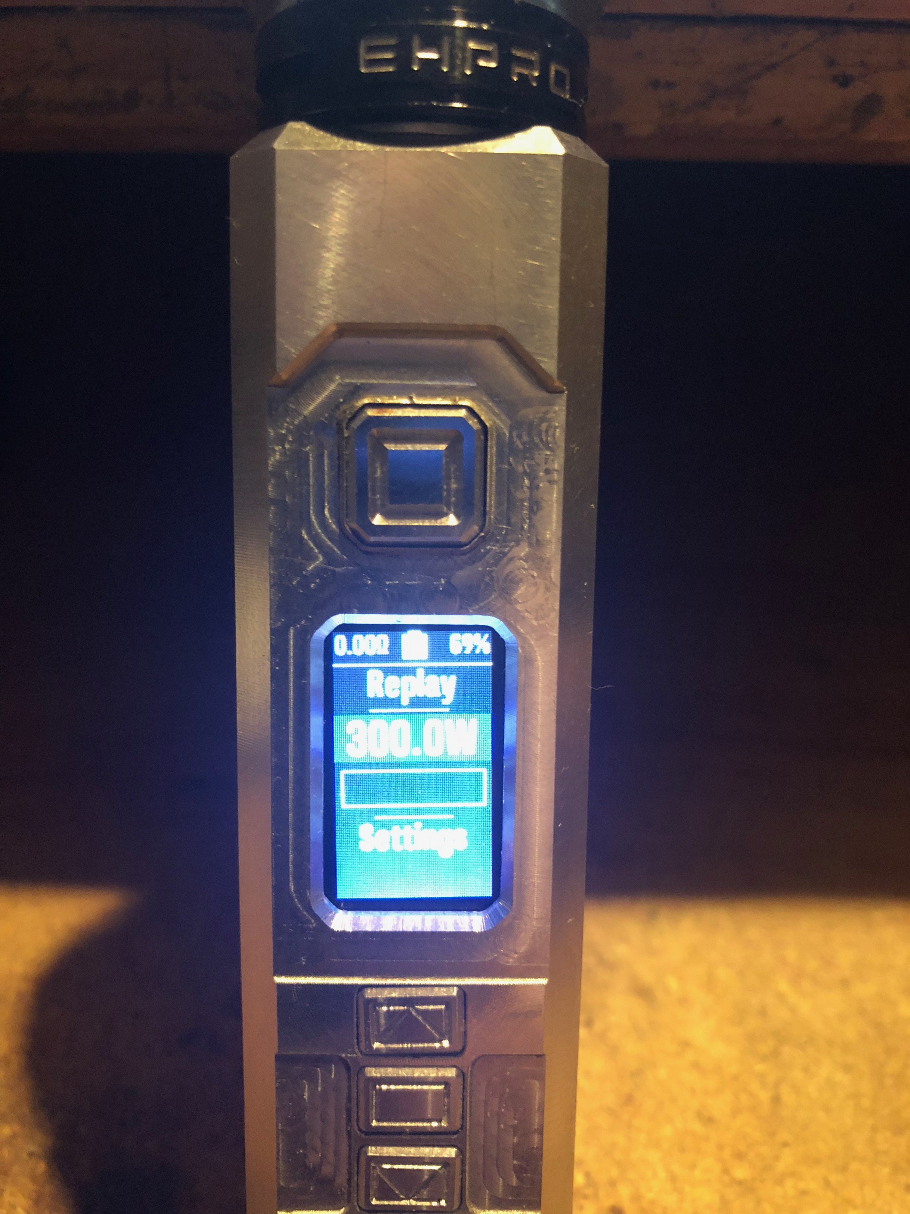

kwfranklin88 Posted June 1, 2018 Report Posted June 1, 2018 On 4/17/2018 at 9:06 AM, iambyrdman said: I finished mine last night. Replay stopped working even though the check is there to enable it. Can you give me a parts list on this build please? I love it! Enclosure? Battery? Thanks!

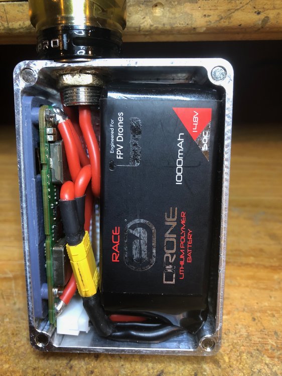

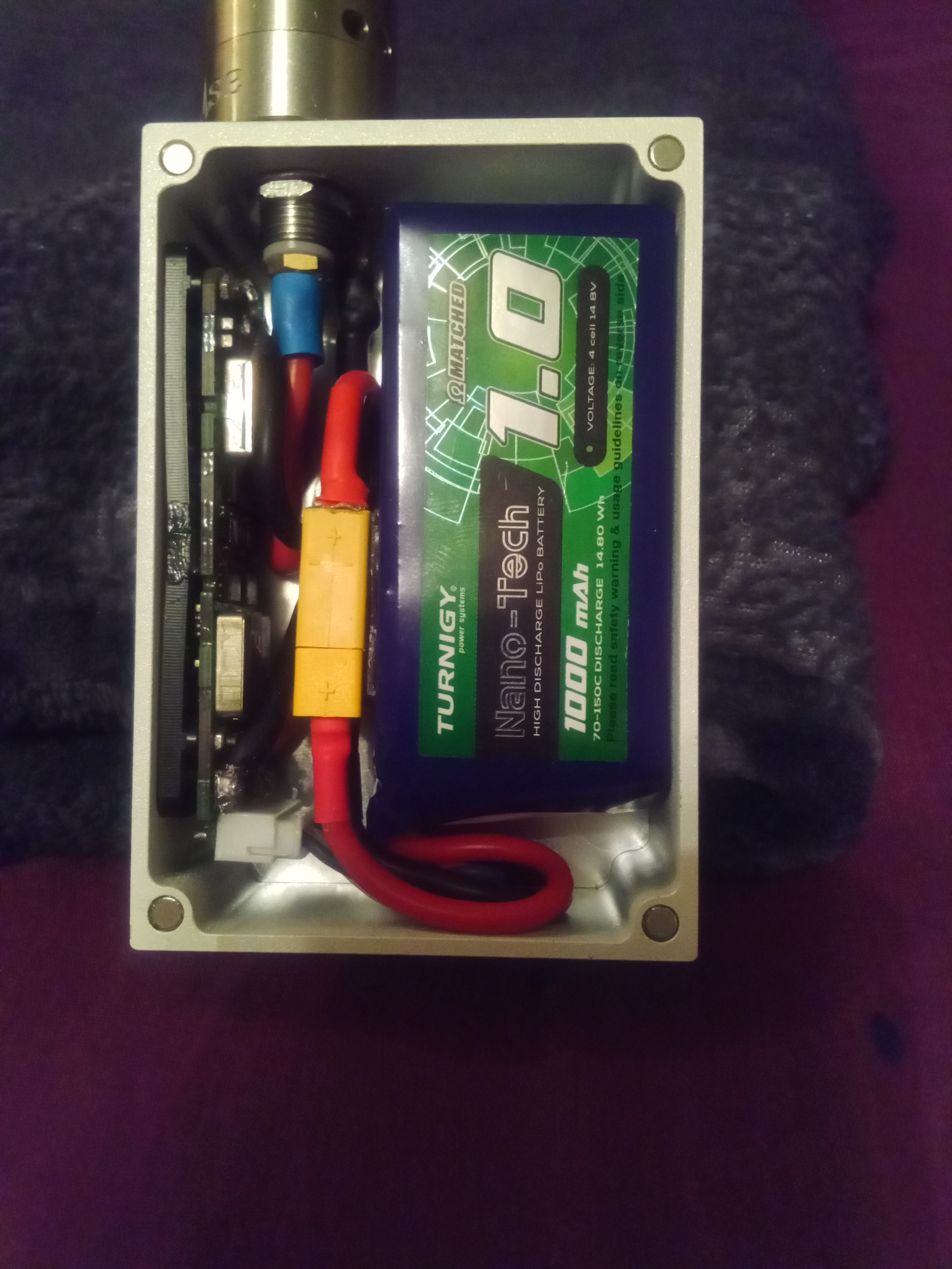

kwfranklin88 Posted June 1, 2018 Report Posted June 1, 2018 On 4/27/2018 at 7:52 AM, steamer861 said: Here'a another one ABM2, 1000mAH 4S lipo, Sorce 510. I posted some reference pics, thats a Silo 950 same size as the old Evolv Reference Mod FYI ABM = Analog Box Mods What’s the battery life like with this battery?
steamer861 Posted June 1, 2018 Report Posted June 1, 2018 2 hours ago, kwfranklin88 said: What’s the battery life like with this battery? Hi It's 14.8 watt hours :) Compare this to 10.5 watt hours with a FullyMax 950. It's pretty good :) I would say equivalent to dual 18650's, :)
gizman Posted June 1, 2018 Report Posted June 1, 2018 6 minutes ago, steamer861 said: Hi It's 14.8 watt hours Compare this to 10.5 watt hours with a FullyMax 950. It's pretty good I would say equivalent to dual 18650's, Assuming 2600MaH dual 18650's, you would be looking at ~18.7 watt hours, 3000MaH dual 18650's would be roughly 21.6 watt hours, if you could find a 1300MaH 4S that would fit it would give you about 19.2 watt hours which would be a closer comparison, or an 1800 3S would be about 20 watt hours. The 1000MaH 4S I ran for about a month would sometimes need charged by the time I got home from work, for me and my habits anyways, the 1300MaH 4S and the 1800MaH 3S both pretty much get me all day with a full charge in the morning, just like dual 18650's used to.
steamer861 Posted June 2, 2018 Report Posted June 2, 2018 2 hours ago, gizman said: Assuming 2600MaH dual 18650's, you would be looking at ~18.7 watt hours, 3000MaH dual 18650's would be roughly 21.6 watt hours, if you could find a 1300MaH 4S that would fit it would give you about 19.2 watt hours which would be a closer comparison, or an 1800 3S would be about 20 watt hours. The 1000MaH 4S I ran for about a month would sometimes need charged by the time I got home from work, for me and my habits anyways, the 1300MaH 4S and the 1800MaH 3S both pretty much get me all day with a full charge in the morning, just like dual 18650's used to. I understand the numbers It seems to me that a good 18650 (VTC5) would give as good or better Watt Hour rate as a Fully Max 950. But in reality, with low ohm high watt vaping like I do, the Fully Max gives Me better performance & run time. I find the same thing with the 4S 1000mAH lipo in my 250c. With my Vaping style the 4S 1000mAH will give me approximately the same run time as dual 18650's, even if the numbers would say different
gizman Posted June 2, 2018 Report Posted June 2, 2018 14 minutes ago, steamer861 said: I understand the numbers It seems to me that a good 18650 (VTC5) would give as good or better Watt Hour rate as a Fully Max 950. But in reality, with low ohm high watt vaping like I do, the Fully Max gives Me better performance & run time. I find the same thing with the 4S 1000mAH lipo in my 250c. With my Vaping style the 4S 1000mAH will give me approximately the same run time as dual 18650's, even if the numbers would say different Funny, I was going to say basically the same thing, that at over 75 watts or so I get much better than what the numbers say I should with a 3S or 4S lipo than I ever got at that wattage, even running VTC6's. Ironic that sometimes numbers DO lie 1

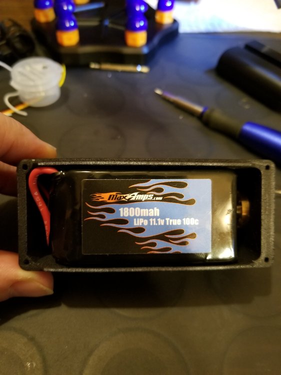

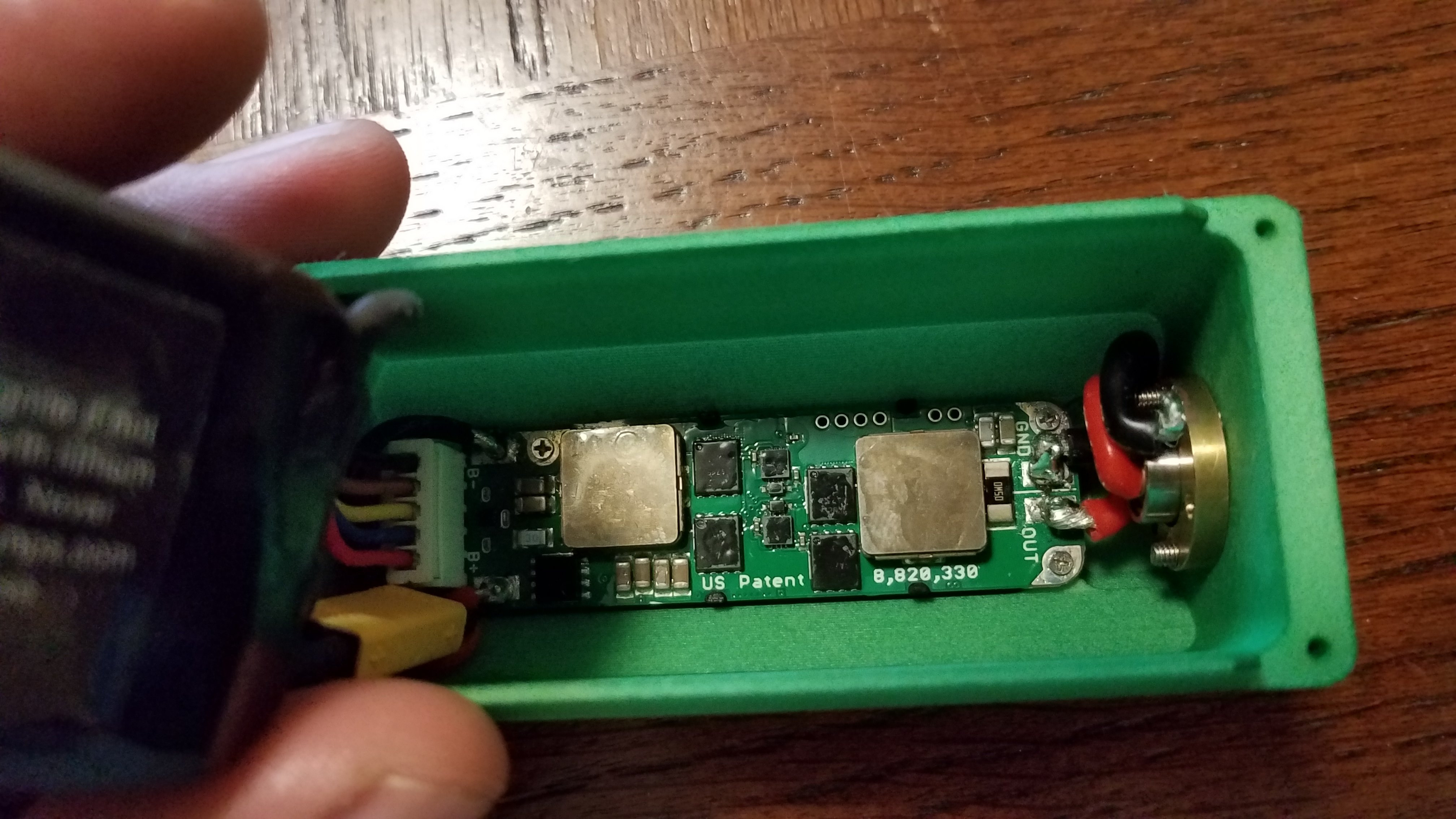

kwfranklin88 Posted June 4, 2018 Report Posted June 4, 2018 On 4/2/2018 at 12:13 AM, ChunkyButt200 said: My go at building a 250C...... Materials: Alpinetech 1590B with pre-cutouts DNA 250C Board Cradle 12mm Domed Tactile Switch Varitube V1 22mm 510 Infinity 4S 1500mah 90c Lipo 14awg Output silicone wires. 28awg enamel magnet wire (fire switch wiring) Waiting on a 6mm 3D printed spacer, from the UK, for between the lid and box . It’s a big a$$ lipo..... How’s the battery life so far on that lipo?
Spector NS5 RD Posted June 5, 2018 Author Report Posted June 5, 2018 @kwfranklin88 The mileage with a fully charged lipo is as expected for a 4s 1500 mAh lipo, not as long as you'd think with a lipo that size but my main reason for getting such a high C discharge rated lipo was so i wasn't stressing the lipo, regardless of my set wattage. I'm sacrificing vape time for a higher discharge. There's barely any voltage sag even at a 300w preheat. I figured overkill on the lipo so i never have to replace it. 1

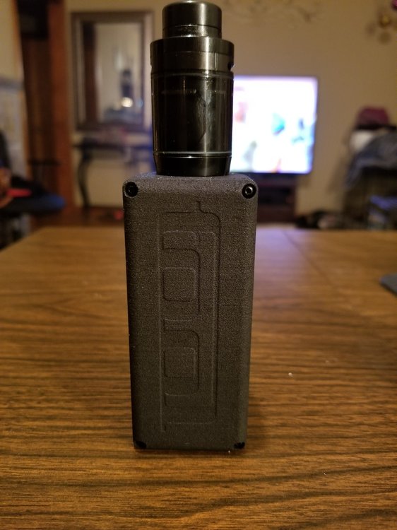

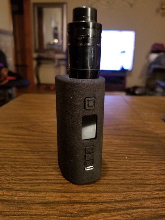

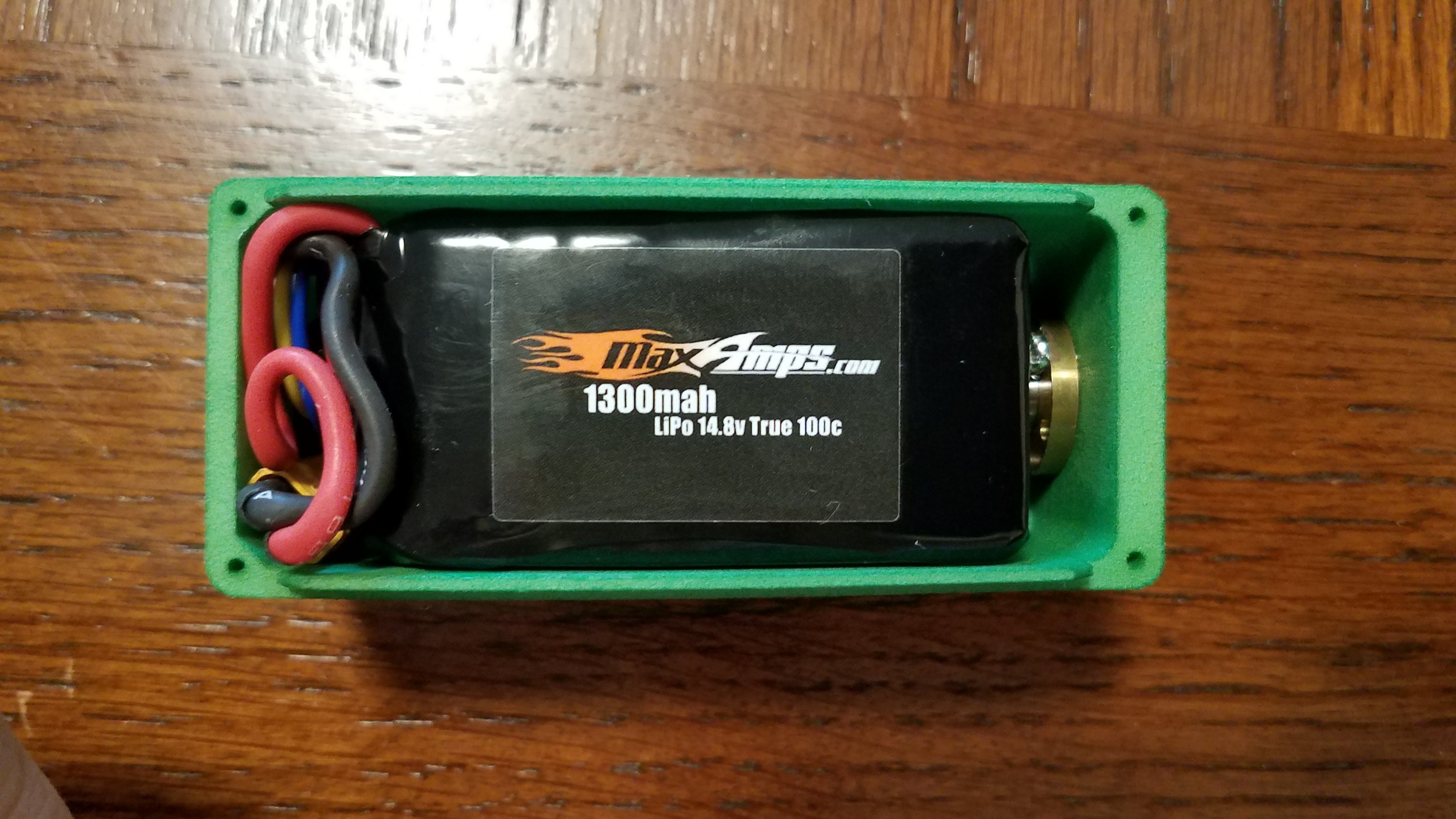

HPloco Posted July 6, 2018 Report Posted July 6, 2018 Went the shape way route, fit like a glove. Max Amp changed their battery size and it still fits. A bit too snug for my preference but with a 4S I don't think I'll have to worry too much if the battery puffs. My soldering skills on the other hand are a bit rusty. 1

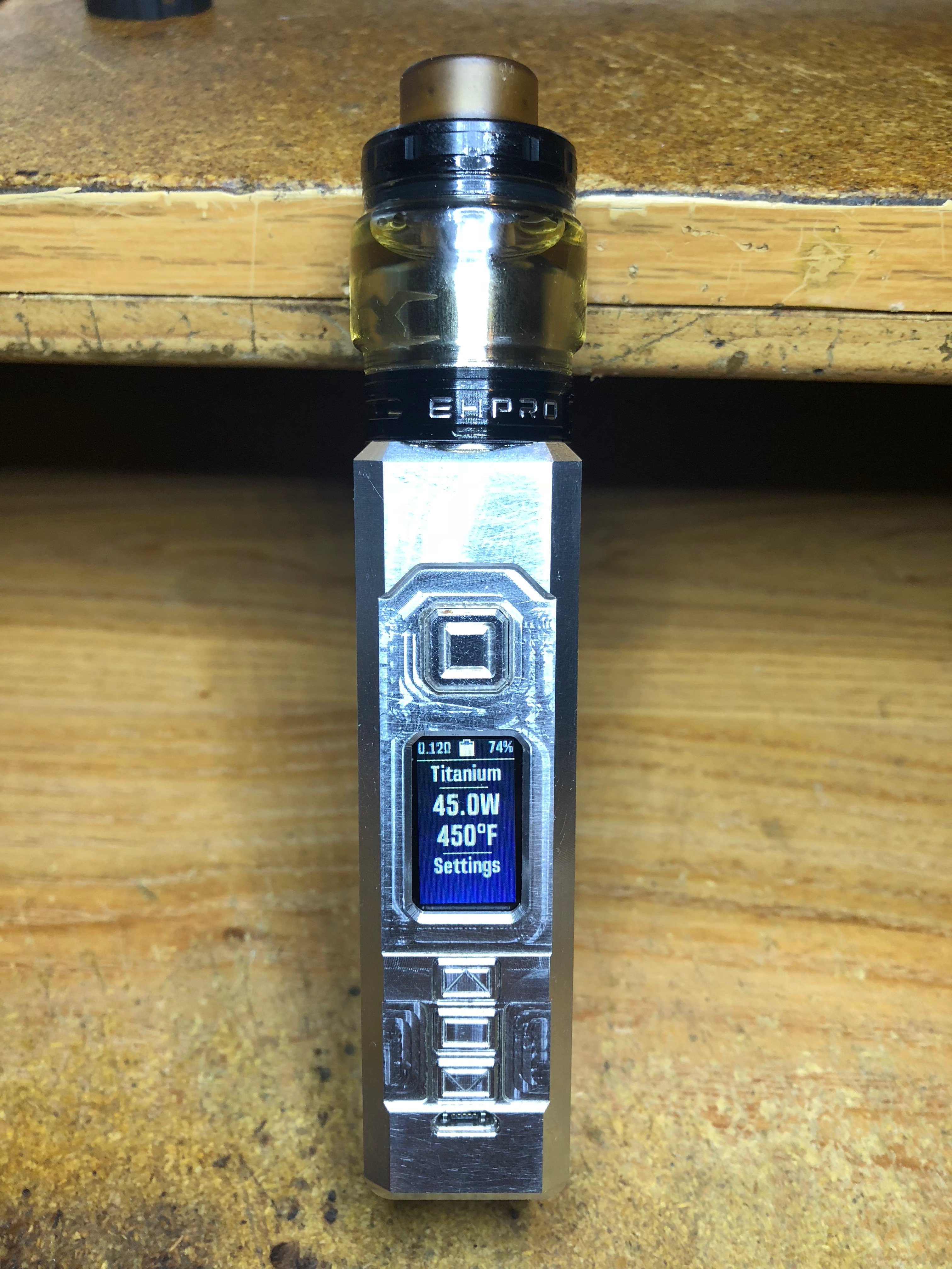

Frogmod Posted March 3, 2020 Report Posted March 3, 2020 Here are my builds the stab wood version has the same battery as the lucite version
Frogmod Posted March 3, 2020 Report Posted March 3, 2020 Built this one for a customer he will be sanding, polishing and assembling this one himself

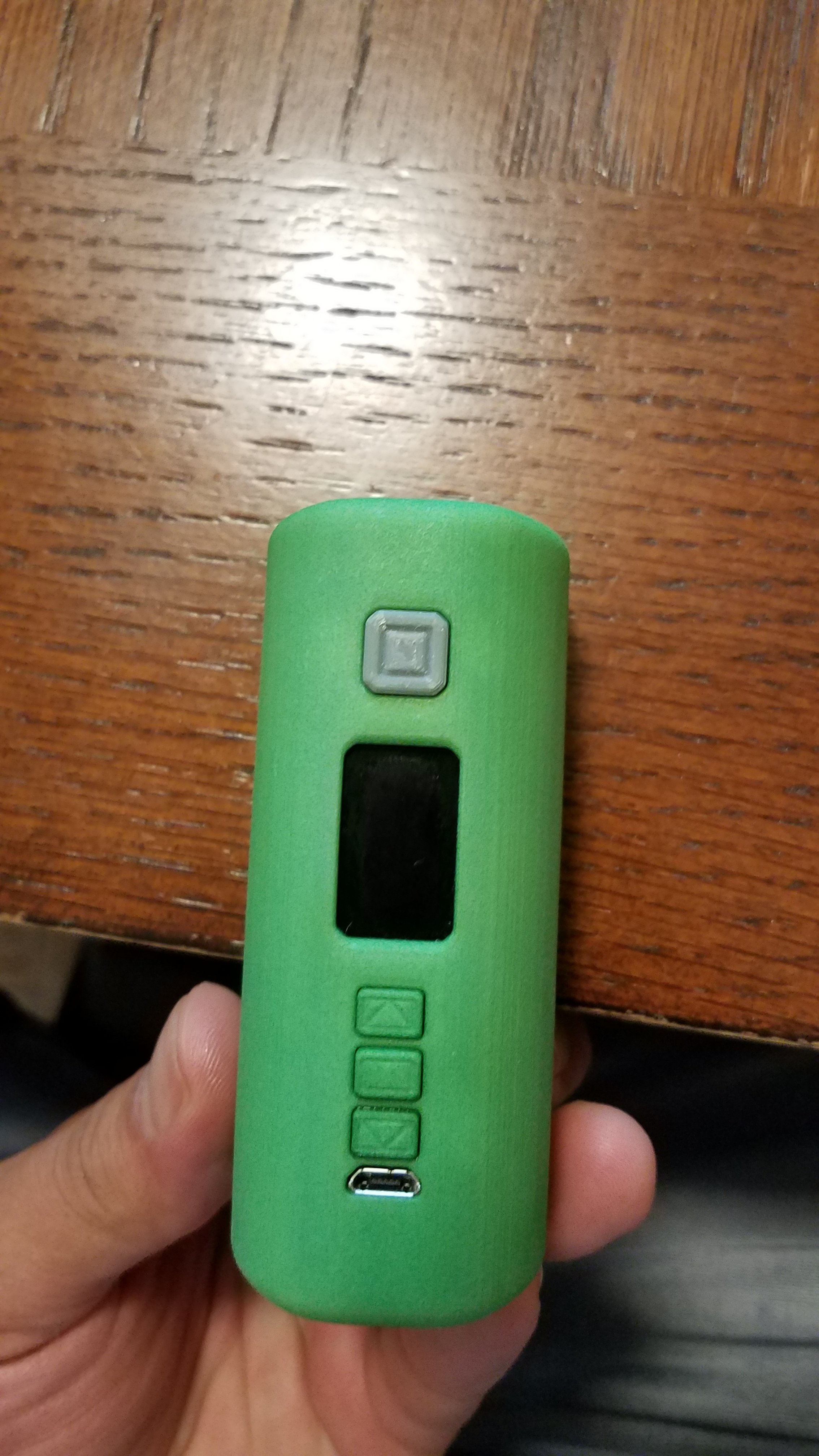

dsw67 Posted September 7, 2022 Report Posted September 7, 2022 Just wanted to show my first go at a dna 250c abm2xl enclosure. I enjoy building my own mods. 1
