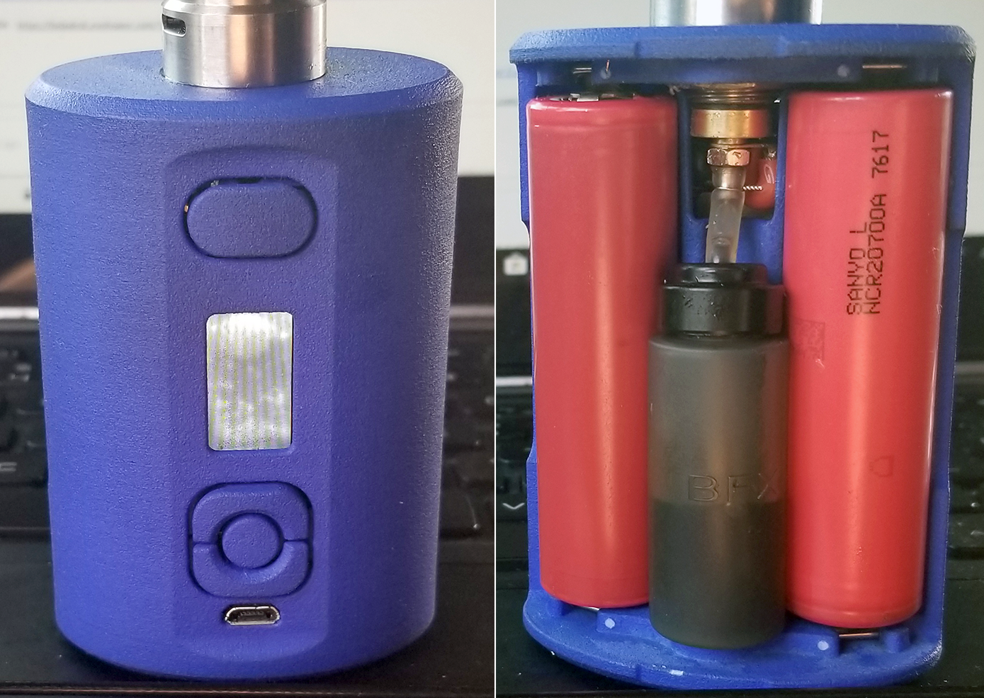

AMDtrucking Posted May 2, 2018 Author Report Posted May 2, 2018 (edited) 5 hours ago, bladedoza said: Does it read the ohms perfectly too? Right on the dot 0.1 Ohm. I think, it's because of MM510 and 14 Gauge wires that I soldered to it, instead of the set screw. Also, let's not forget about the negative connection. If you've noticed, the nut did not sink all the way into the plastic. That's because my negative soldered tab washer, that goes around the threaded part of the connector under the lock-nut is three times thicker and made out of copper. Could somebody tell me, what is the proper name for that washer? Edited May 2, 2018 by AMDtrucking

AMDtrucking Posted May 3, 2018 Author Report Posted May 3, 2018 Based on what I've been told by Evolv, when I had it repaired, my DNA250C board had some liquid damage to it. Well, this time, I made every precaution, that it will never happen again. My Boxer is dry as desert. But the screen went blank on me. Even though, the board still works, I can't see what it does.

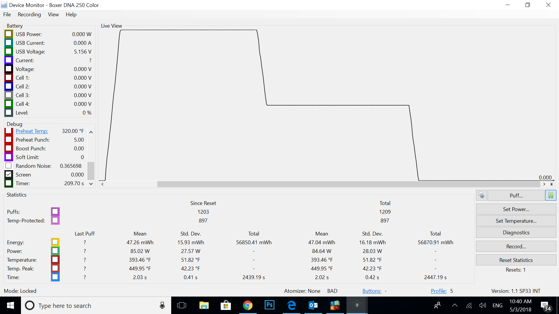

AMDtrucking Posted May 3, 2018 Author Report Posted May 3, 2018 Since my display quit working this morning, I ran Device Monitor in Debugging mode, looking at "Screen" monitor, but I'm not sure what to expect from it. It looks like this. Note: The batteries are removed. It's an old habit of mine. I don't USB charge DNA and I remove batteries when connect to Escribe. I had unfortunate experience in the past with DNA200.
