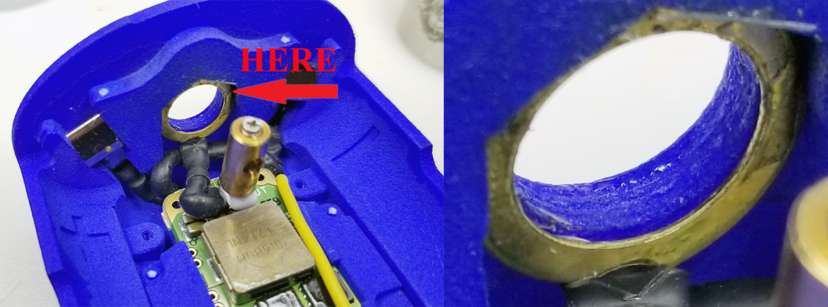

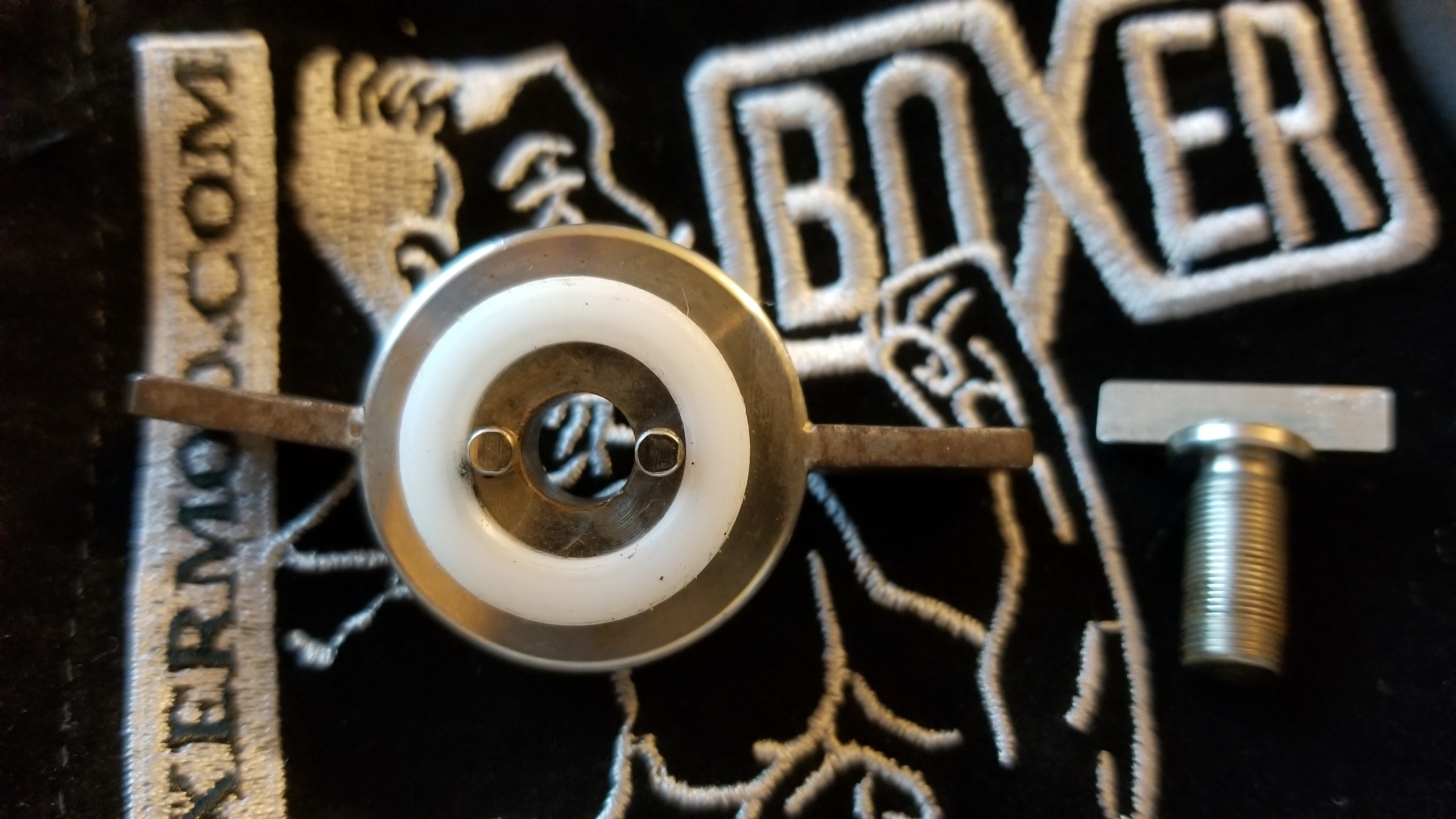

@Ginger I truly appreciate your response and as I stated before, I understand the tremendous pressure, you were under, trying to ship all those pre-orders out and I don't blame you. However, I disagree with your statement:   "Wasn't necessary to go through all the steps you did, but when you did tighten it back together it did correct the issue." Because, being an electronic technician by trade, that was the first thing that I did and it didn't help.  I used a very large Craftsman screw driver. Also, you didn't address the drayed glue, that I've removed with my threading die, what was it? Further more, the actual issue was in some small plastic shavings between brass contact washer and the nut. How did they get there? During the assembly, the nut was not placed in its plastic socket of the case all the way in and was pulled in by the connector, when it was being screwed in. When the nut was traveling, it shaved some plastic from the walls of its socket and some of the shavings, ended up squashed between the nut and the brass contact washer, creating conductivity issue.  I actually took X-Acto  knife  and cut off some small amounts of plastic layers from the washer and the nut that have already bonded to it. I know it wasn't the glue used on the threads, because the dry glue was bridle and what I've removed from the washer, was flexible.  Take under consideration, that you need to insert the nut in its socket, all the way in, hold it there until the connector is fully threaded and tight. Do not allow the nut to travel, rubbing and shaving the walls of its socket. By the way, did I understand you correctly, that 510 connector in made out of stainless steel and then black nickel plated, not painted? That's great!
That is correct.   It is a Black Nickel plating.   We also do not use glue.   The sealant is from the locknut down and not interfering with the ground beneath.  If it was super glue as I believe someone may have mentioned, you would not have been able to unthread it without heating it up. Still not even necessary on this model.   Not sure what you are referring to a plastic or a socket, but our 510 has a peek insulated bushing and cap which screws directly into the 510 collar.  Its diameter is smaller than the opening of the locknut.  From your pictures it is fully intact and not damaged in any way.  During assembly, the locknut in placed in its channel, the 510 collar with pin assembly dropped in from the top and tightened.  No force of movement of the locknut.

By the word Socket, I meant what you are referring to as a channel.  The hexagonal shaped cavity, near the top of the body, where the locknut rests, like in a socket wrench.  Sorry for misunderstanding. Here is the image, where you can see clearly, a layer of plastic (partially removed by X-Acto knife)? I then removed it all and sanded both sides of that contact washer as well as the lock nut itself. Also, I ran my M10-1.0mm tap through the threads of the nut, to remove remainder of the sealant you have used..

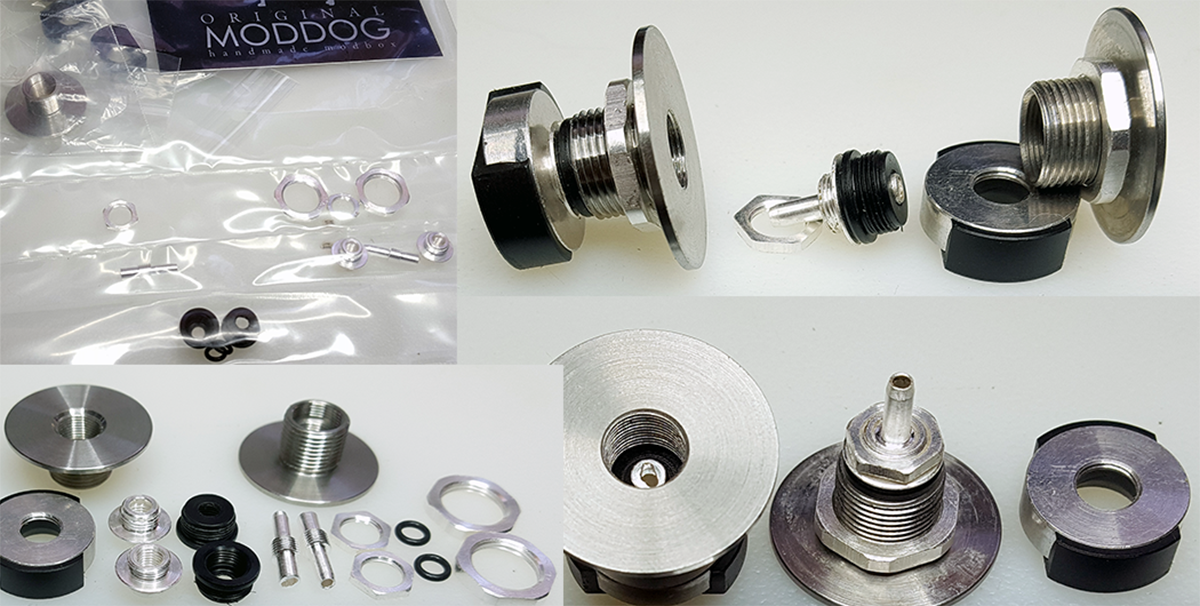

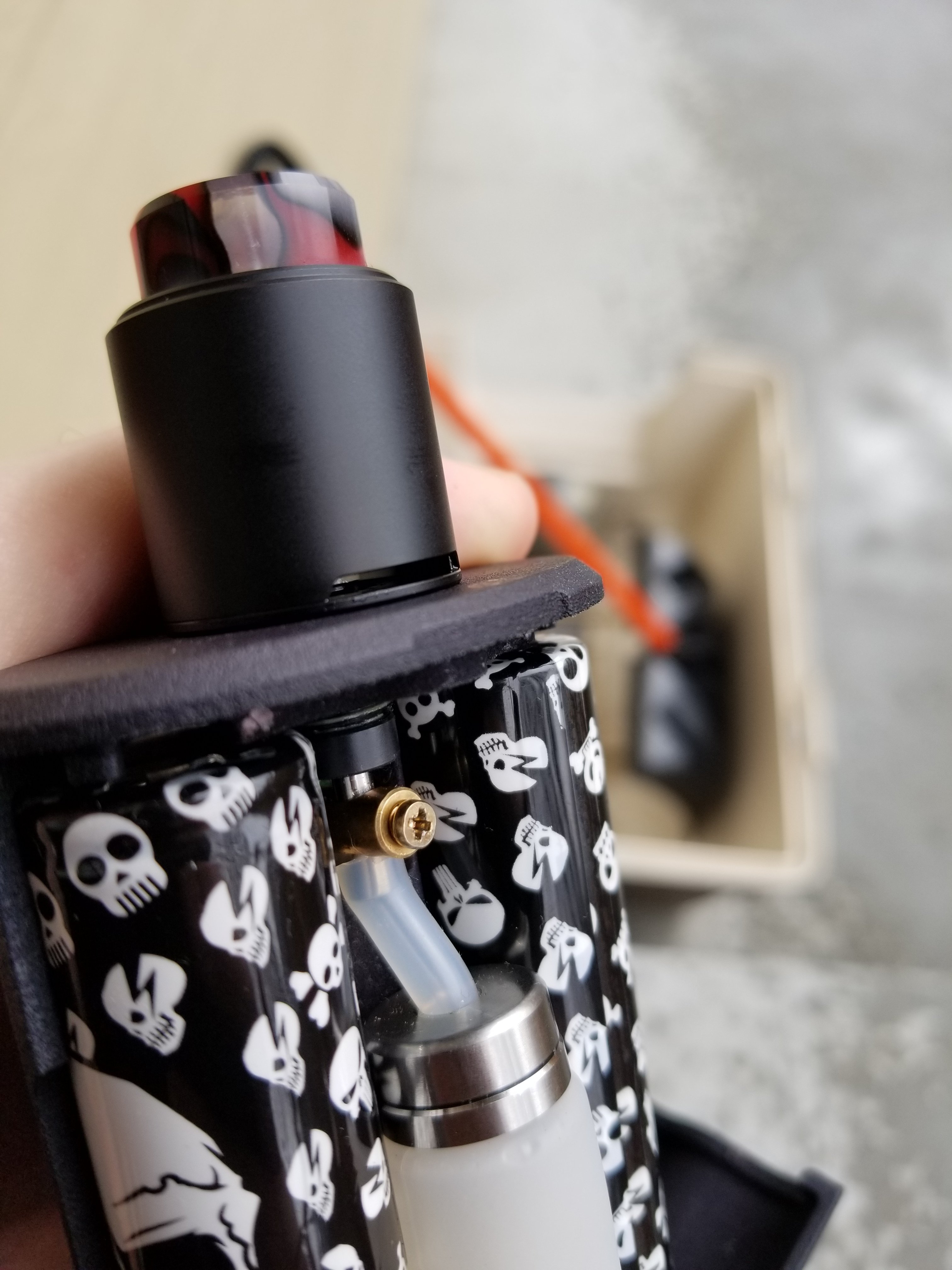

That's unfortunate. Mine is perfect. 60 Ml of liquid in Replay mode, went though it. Now I'm thinking, how to modify the tube of 510 connector, kind of like a kitchen faucet "gooseneck" , that way the end of the tube will be directly above the bottle, not offset, like it is now. That way, I could use Sunbox Cappy V4 silicon  8.5ml taller bottles. Here is a little hint for you guys, where to get Sanyo NCR20700A for less then $7.00 each. Enjoy!
Edited by AMDtrucking
1 hour ago, bladedoza said:
It's working I just have 0.2- 0.3 to much resistance dedending what device I compare it to that's working properly .  Share your bottle adapter when you do it please.

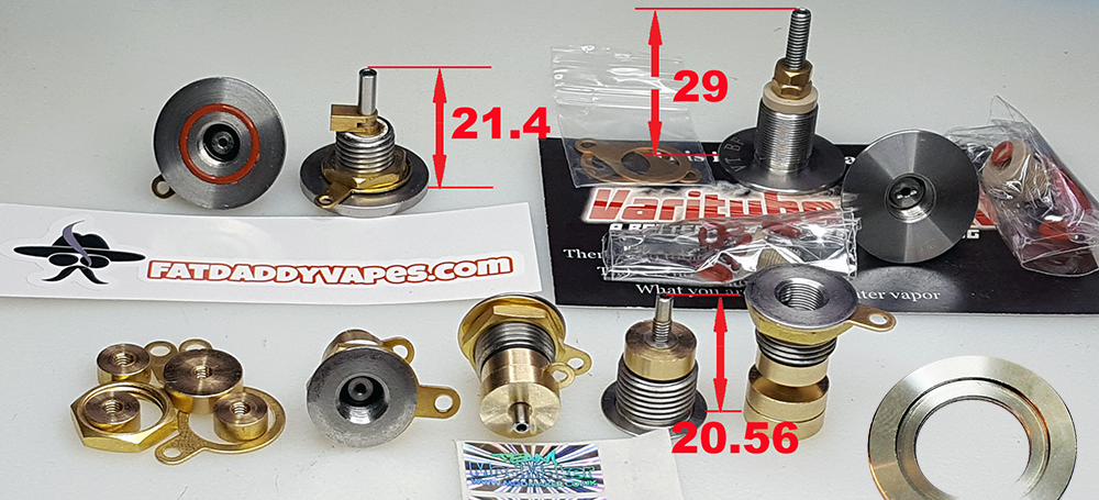

Wow 0.3Ω? That's too much. Mine was reading 0.05 extra Ohms and Replay worked sporadically, I can only imagine, what it does to you.   I haven't decided what exactly I'm going to do with that bottle adapter yet. Maybe I will use Varitube connector for it's long tube and bend into shape, I don't know yet, but the way that it is now is a goof. I understand why they did it, but I would rather have this connector offset to one side, then to have route the bottle tube at such angle and limit the size of the bottle that can be used. I have to refill four times a day. I don't particularly like these type of connectors. These type of construction, was used in Fat Daddy BF connectors that sucked. I'm sure they are better and hopefully, don't leak, like Fat Daddy did and they are black nickel plated and all that. But that doesn't doesn't cancel the fact, that having brass cylinder over the tube (with a set screw) , is not my favorite connection and it takes too much room. My favorite connectors, are Mod Dog from Italy, they are silver plated. But they are not spring loaded and are better for mechanical squonks. My second favorites are Mod Maker from England (MM510), but they are Ø12mm and will not fit.  I have them all in multiple quantities, including Varitube. Will see.
