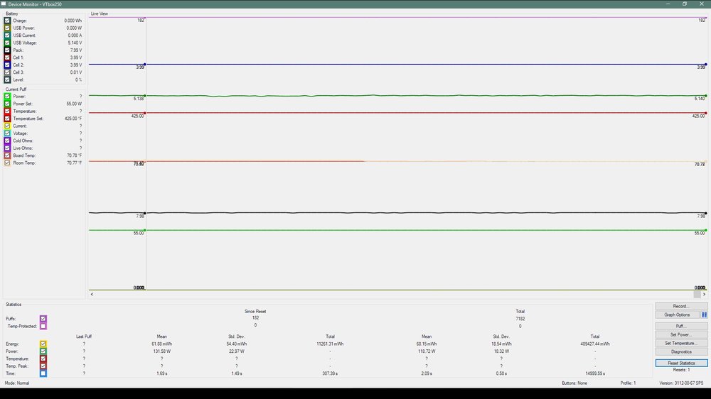

Yet the problem persists.  Using the device monitor, I can see that the 3 cells of the battery arin't quite right, cell 1 and 2 were find, right around 4v and identical, but cell 3 was running closer to 3.5 volts.  I reset defaults, renewed firmware, everything anyone suggested to help solve similar problems.  I even did a recovery charge, which for whatever reason is logged with escribe, but hey, it wasn't charging anyway, so I tried several times.  Now, just a few hours later, cell 3 - which was reading 3.68 or so, now according to the device monitor, is at 0.01 Volts...Cell's one and two are now at 3.99.  Wonderful, thank you for draining my device escribe software.  So now here I sit broken hearted, my coveted DNA 250 was all just a bunch of hype.   I've contacted both Vapecige and Escribe and explained what was happening, and someone had better either have a solution for me or send me a new mod, because this shouldn't be happening to a mod less than 4 months out of the box.  Ugh I'm just completely disgusted that after spending a pretty penny that a quality product is not what I end up with.  If anyone suggests changing the battery pack, I may just take this currently useless brick and sling it as far into the woods as I can - because this is MOST DEFINITELY a manufacturer defect, considering the only info you find on the model is people with battery problems.  I'm just so depressed - attached is a picture of the device monitor as it stands right now, plugged into the computer and should be charging....sigh .....

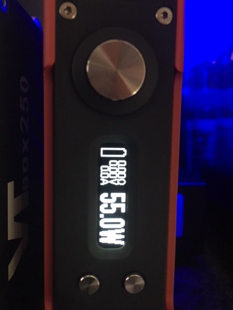

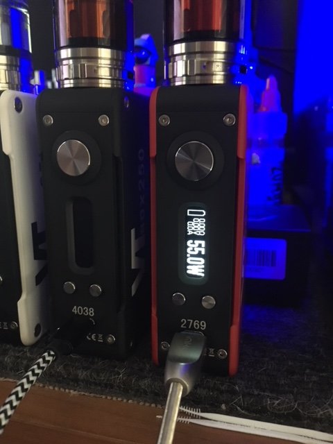

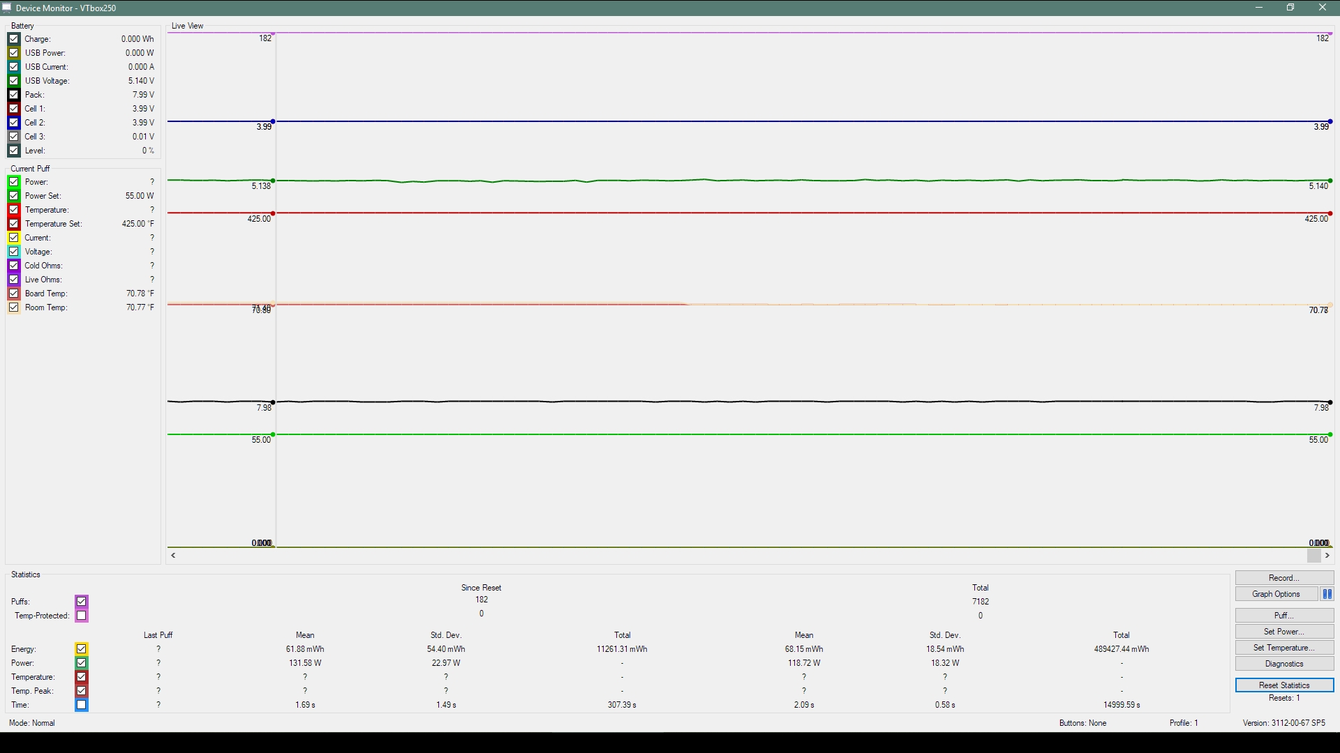

Did not wish to start a new thread on basically the same topic, but I have a very similar issue.. I have (3) VTBox250's, two work just great, one is a problem child and only had it about 5 months. During this time it has kikked (3) lipo packs and it is the same on all three packs.... Cell Number 3 is dead.. 0.00V
I have downloaded the Evolv and Escribe software, I have reset the unit, updated, hell had it try the recovery charge, see picture below... Cell 3 is at 0.00V
Have written and messaged VapeCige through Facebook, Messenger, and through their site. Honestly hate to think it is bricked. Anyone have any direction? Thoughts, Suggestions...

@John Vezirian If this mod has killed previous lipos, the problem is most likely after the lipo pack. This problem could be from - poor balance tap soldering, a broken balance tap wire, a smaller than a grain of rice resistor that has been knocked off the PCB, ejuice on or near the analog front end.......etc. etc. As it is almost impossible to diagnose a possible board issue through forum chat, i would suggest opening a help ticket with Evolv. The link is my signature at the bottom of this post.  Evolv encourages people with board issues to contact them if the vendor or manufacturer fails to respond. I definitely would not waste any more lipos on this mod, for sure, until the primary issue is fixed. Sorry i don't have a "fix cell 3" setting for you to use in EScribe. This mod is going to be required to go in for warranty service, which lasts one year from the date of purchase.
