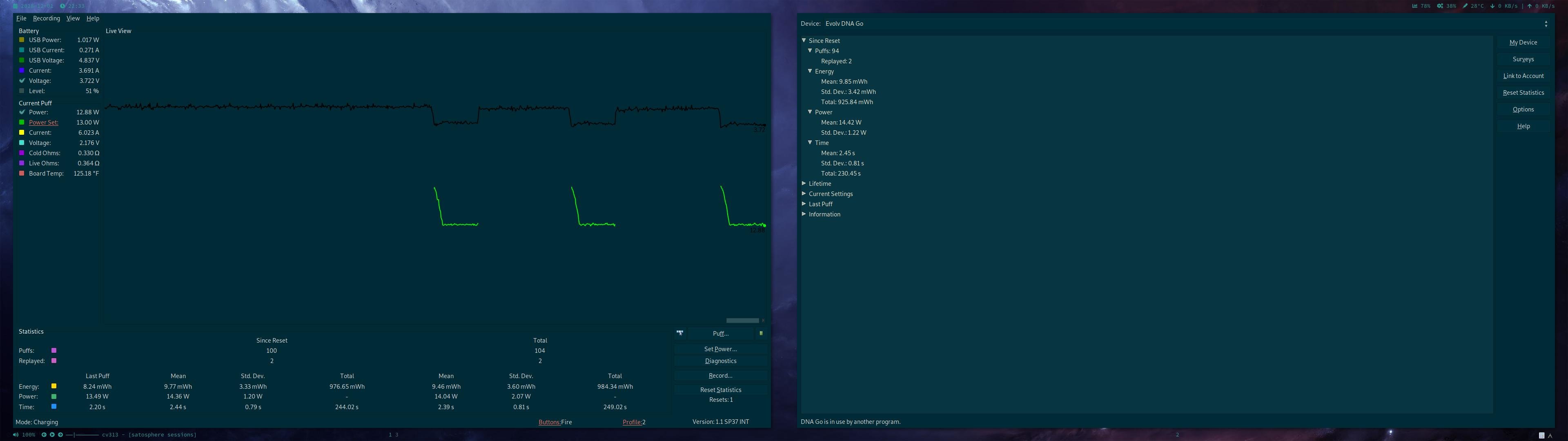

retird Posted September 27, 2018 Report Posted September 27, 2018 That screen looks like the Reuleaux RX200 which is not a DNA 1
