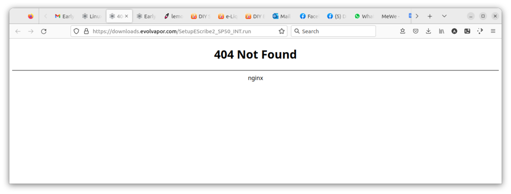

Magigamix Posted December 9, 2022 Report Posted December 9, 2022 16 hours ago, James said: I've posted up EScribe Suite SP50 for Linux. It includes new firmwares for DNA 60 and Cricket. I think the download links are broken:
James Posted December 9, 2022 Author Report Posted December 9, 2022 @Magigamix: Try now. I had found a bug in SP50 and took it down while I fixed it. It is up again now. 1 1

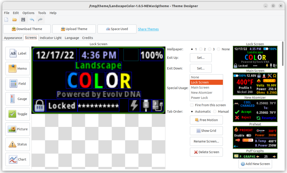

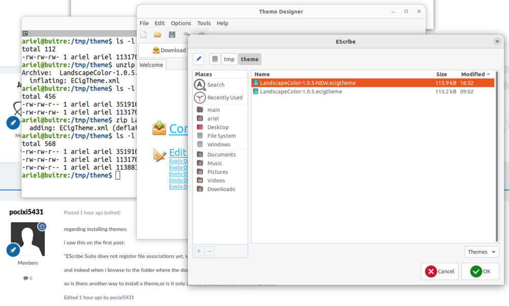

pocixi5431 Posted December 17, 2022 Report Posted December 17, 2022 (edited) regarding installing themes; i saw this on the first post: "EScribe Suite does not register file associations yet, so you can't install themes directly by double clicking a theme file. " and indeed when i browse to the folder where the downloaded theme is(through Escribe/"Load theme"),nothing appears,it's blank/the xml file is not recognized. so is there another way to install a theme,or is it only able to create your own one in Escribe? Edited December 17, 2022 by pocixi5431
Magigamix Posted December 17, 2022 Report Posted December 17, 2022 (edited) 2 hours ago, pocixi5431 said: regarding installing themes; i saw this on the first post: "EScribe Suite does not register file associations yet, so you can't install themes directly by double clicking a theme file. " and indeed when i browse to the folder where the downloaded theme is(through Escribe/"Load theme"),nothing appears,it's blank/the xml file is not recognized. so is there another way to install a theme,or is it only able to create your own one in Escribe? In order to Escribe to recognize a theme (either by opening with "Escribe -> Theme -> Load Theme..." or with the Theme Designer) the xml file (ECigTheme.xml) should be zip compressed and with the .ecigtheme extensión: Edited December 17, 2022 by Magigamix Deleted spaces. 1
pocixi5431 Posted December 18, 2022 Report Posted December 18, 2022 Thanks, i was extracting those archives, now i can see them fine. 1
