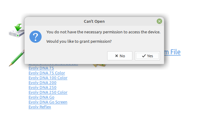

AmadVaper Posted April 26, 2022 Report Posted April 26, 2022 @Podunk Steam OK. So I did some testing with my media center machine and the details of that machine are below: OS - Linux mediactr 5.4.0-109-generic #123-Ubuntu SMP Fri Apr 8 09:10:54 UTC 2022 x86_64 x86_64 x86_64 GNU/Linux Linux Mint 20.3 groups: myuser adm cdrom sudo dip plugdev lpadmin sambashare Machine Specs: Asus B550 Motherboard Ryzen 3600 500GB NVME SSD 1TB AData SSD 32GB Patriot Viper 3200 MHz Ram Nvidia Gforce GT-610 Video HP NC-364T Quad GB Nic (Mobo has only a 2.5GB nic that requires a driver to work) I installed SetupEScribe2_SP31_US on the B550 machine and I immediately saw things I did not see on my main machine with the x470 board. First I was prompted during installation to install Mono and related dependencies. Not a big deal since I have Mono on the X470 from a previous install. But, upon starting EScribe I was told that I did not have the necessary permissions to access the device. This was new! I choose yes to apply those permissions and was pretty hopeful that EScribe was going to work on this machine. When I connected the DNA250c and then selected connect and download, Escribe crashed upon near completion of downloading settings. Since it appeared that EScribe was connecting to the DNA250, I decided to apply the firmware update (1.1 SP45) which was successful. I then tried connecting and downloading settings but EScribe crashed upon near completion of downloading settings. The unit that was connected was sn JAFAXXXXXXX. I then installed SetupEScribe2_2020-06-22_US_test.run over the previous installation, and then pushed the 1.1 SP45 to all of the units. I connected one of the Thelma's via USB. I selected Connect and Download, and to my amazement Escribe did not crash but loaded up and allowed me to save the settings and theme. I tried this again with my other Thelma and one of the Paranormal units. All connected and did not crash EScribe. The only unit that crashes EScribe on the B550 is the Paranormal sn JAFAXXXXXXX. As I did on the X470, I copied all of the logs and included them here as an attachment to try to keep the post reasonable in size. So now here is my question... Where do I go from here with the Paranormal sn JAFAXXXXXXX ? Errors.txt

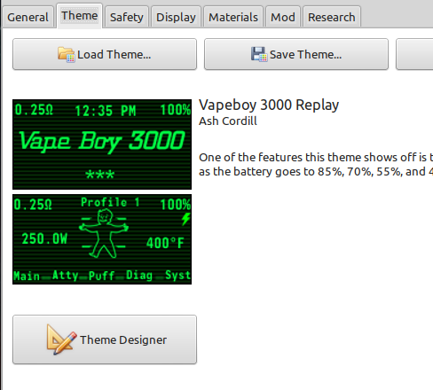

James Posted April 26, 2022 Author Report Posted April 26, 2022 What theme is your device running? Try this: https://downloads.evolvapor.com/SetupEScribe2_2022-04-26_INT_test2.run
AmadVaper Posted April 26, 2022 Report Posted April 26, 2022 Vapeboy 3000 Replay - The unit that crashes I had modded the lock screen wallpaper but made no other changes as far as I can remember. On to testing!
James Posted April 26, 2022 Author Report Posted April 26, 2022 The crash was related to a condition in the theme. For some reason it had not been stored properly in the device memory.

James Posted April 26, 2022 Author Report Posted April 26, 2022 What are the permissions on the hidraw device? On mine it's user root, group plugdev.
AmadVaper Posted April 26, 2022 Report Posted April 26, 2022 On the B550 ls -la /dev/hidraw5 crw-rw----+ 1 root plugdev 239, 5 Apr 26 13:08 /dev/hidraw5 On the X470 ls -la hidraw2 crw-rw----+ 1 root root 238, 2 Apr 23 10:13 hidraw2
James Posted April 26, 2022 Author Report Posted April 26, 2022 What does it say if you send this command? getfacl /dev/hidraw2 Is there a file 60-dimension_engineering.rules in /etc/udev.d ?
AmadVaper Posted April 26, 2022 Report Posted April 26, 2022 (edited) Sweet. So I added a udev rule to force hidraw devices to be root:plugdev. Connected and downloaded without issue on the X470 I created 99-hidraw-permissions.rules under /etc/udev/rules.d with this line: KERNEL=="hidraw*", SUBSYSTEM=="hidraw", MODE="0664", GROUP="plugdev" Serial Number: JAFAxxxxxxxxx Firmware Version: 1.1 SP46 INT Firmware Date: 2021-12-28 Revision Code: 311104658 USB Vendor ID: 268B USB Product ID: 0419 USB Product Version: 3.0 Edited April 26, 2022 by AmadVaper update
AmadVaper Posted April 26, 2022 Report Posted April 26, 2022 (edited) 12 minutes ago, James said: What does it say if you send this command? getfacl /dev/hidraw2 Is there a file 60-dimension_engineering.rules in /etc/udev.d ? getfacl /dev/hidraw2 getfacl: Removing leading '/' from absolute path names # file: dev/hidraw2 # owner: root # group: root user::rw- user:michael:rw- group::--- mask::rw- other::--- Sorry... forgot this /etc/udev/rules.d$ ls 52-airspy.rules 99-hidraw-permissions.rules 60-brother-mfp-brscan5-1.0.2-2.rules 99-md380.rules 60-dimension_engineering.rules rtl-sdr.rules 60-vboxdrv.rules So 60-dimension_engineering.rules are there Edited April 26, 2022 by AmadVaper
James Posted April 26, 2022 Author Report Posted April 26, 2022 By any chance is that system missing /usr/bin/pkexec? (That and bash should be all that is needed for the 'grant permission' script, which doesn't appear to have copied the rules in your case.) (Alternatively, are there any permissions set on the system which would prevent a file from the user's temp directory being copied to /etc/udev.d ?)
AmadVaper Posted April 26, 2022 Report Posted April 26, 2022 2 minutes ago, James said: By any chance is that system missing /usr/bin/pkexec? No. pkexec is there but I do remember having issues with pkexec where it would not run as some applications had pkexec in their run statement, but I could run the statement in the terminal just fine. /usr/bin$ ls pkexec* pkexec pkexec --version pkexec version 0.105
James Posted April 26, 2022 Author Report Posted April 26, 2022 Interesting. How is your 99 rules different from the 60 rules, then?
AmadVaper Posted April 26, 2022 Report Posted April 26, 2022 4 minutes ago, James said: Interesting. How is your 99 rules different from the 60 rules, then? 60-dimension_engineering.rules KERNEL=="hidraw*", SUBSYSTEM=="hidraw", ATTRS{idVendor}=="268b", MODE="0660", GROUP="plugdev", TAG+="uaccess", TAG+="udev-acl" KERNEL=="ttyACM*", SUBSYSTEM=="tty", ATTRS{idVendor}=="268b", TAG+="uaccess", TAG+="udev-acl" 99-hidraw-permissions.rules KERNEL=="hidraw*", SUBSYSTEM=="hidraw", MODE="0664", GROUP="plugdev" I guess the only real difference is that my rule isn't tagging or adding the ttyACM rule.
James Posted April 26, 2022 Author Report Posted April 26, 2022 ttyACM is for the device's serial port. Hmm. Mine also restricts it to USB Vendor ID 268b, and adds tags (used by some newer distributions). How old is the OS on that one? Do you get any udev errors when connecting it? https://unix.stackexchange.com/questions/36251/in-which-log-should-i-check-for-udev-errors
