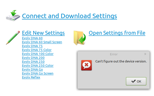

AmadVaper Posted April 23, 2022 Report Posted April 23, 2022 (edited) Hello All, I'm running Linux Mint 20.1 Ulyssa kernel 5.4.0-109-generic and unfortunately I cannot get EScribe suite to connect to my 4 different DNA 250 units (2 Paranormal & 2 Thelma). Getting an error that just says "Can't figure out the device version" when trying to download and connect. EScribe version is 2.0 SP30.1 Anyone have any thoughts on where to start for troubleshooting other than downloading an older version and trying again? Just a note - Linux Admin/Dev is my day job so if you need folks to test I'm more than willing to help! Edited April 23, 2022 by AmadVaper

AmadVaper Posted April 23, 2022 Report Posted April 23, 2022 Decided to run in a terminal to see what EScribe was outputting and I've added that below if someone can forward that on to the Devs. Going to try different cable too BTW - My machine hardware is: Ryzen9 3900X MSI X470 64GB Crucial Ballistix 3200mhz Ram Zotac 1060 Video 2 Intel NVME 1tb Razer Black Widow Keys Logitech MX Anywhere 2 mouse "/home/user/.local/opt/evolv/escribe-suite/launch-escribe-suite" Killed user@machine:/media/user/Data1$ Device list changed. 16:39:14.8630: Benchmark: Tab Configuration: Welcome took 45.1831 ms. 16:39:14.8822: Benchmark: File->New took 10.292 ms. 16:39:14.8834: Benchmark: Startup took 565.2474 ms. 16:39:14.9362: Benchmark: AutoConnect took 6.8696 ms. Device list changed. Device list changed. 16:39:23.0872: Benchmark: AutoConnect took 7.9496 ms. Device list changed. (EScribe:487097): Gtk-WARNING **: 16:39:23.223: gtk_widget_size_allocate(): attempt to allocate widget with width -5 and height 0 A.JXD: Exception of type 'A.JXD' was thrown. at A.HJD.GU (System.IO.Stream , System.Byte[] , System.Func`2[T,TResult] , System.Func`2[T,TResult] , System.Action`2[T1,T2] ) [0x0013d] in <7f12dab92af142cabec75367973409b4>:0 at A.HJD.UU (System.IO.Stream , System.Byte[] , System.Func`2[T,TResult] , System.Action`2[T1,T2] ) [0x00000] in <7f12dab92af142cabec75367973409b4>:0 at A.HJD.BU (System.IO.Stream , System.Int32 ) [0x00095] in <7f12dab92af142cabec75367973409b4>:0 at A.AKF+NKF.GU (A.ZRB , System.Byte , System.Int32& , System.Boolean& , A.HXF ) [0x000bb] in <18d250f3d7964b88be530360e0b927da>:0 I/O output report failed. Closed. 16:39:54.9883: Benchmark: AutoConnect took 2.4082 ms.

AmadVaper Posted April 23, 2022 Report Posted April 23, 2022 I also noticed this in the journalctl as well. Is there a plugin that I'm missing for the DNA250 chipset? kernel: hid-generic 0003:268B:0419.0017: hiddev2,hidraw7: USB HID v1.10 Device [Dimension Engineering Evolv DNA 250 Color] on usb-0000:03:00.0-11.7/input0 Apr 23 16:39:23 machine kernel: cdc_acm 1-11.7:1.1: ttyACM0: USB ACM device Apr 23 16:39:23 machine mtp-probe[487307]: checking bus 1, device 19: "/sys/devices/pci0000:00/0000:00:01.3/0000:03:00.0/usb1/1-11/1-11.7" Apr 23 16:39:23 machine mtp-probe[487307]: bus: 1, device: 19 was not an MTP device Apr 23 16:39:23 machine mtp-probe[487336]: checking bus 1, device 19: "/sys/devices/pci0000:00/0000:00:01.3/0000:03:00.0/usb1/1-11/1-11.7" Apr 23 16:39:23 machine mtp-probe[487336]: bus: 1, device: 19 was not an MTP device Apr 23 16:39:25 machine ModemManager[1375]: <info> [base-manager] couldn't check support for device '/sys/devices/pci0000:00/0000:00:01.3/0000:03:00.0/usb1/1-11/1-11.7': not supported by any plugin

AmadVaper Posted April 23, 2022 Report Posted April 23, 2022 7 minutes ago, Podunk Steam said: I won't be able to follow up any time soon but did you start with the simple stuff like making sure you're using a good data cable? Check the USB with another data device? It's been quite a while since I have had to designate USBs with any Linux distro, that's going back to the 9.x Ubuntu distros thinking about it. Thanks Podunk, I did try a different cable that is known working. Also checked dmesg so I know the system is seeing the DNA250 [24909.609070] usb 1-11.6: new full-speed USB device number 22 using xhci_hcd [24909.952534] usb 1-11.6: New USB device found, idVendor=268b, idProduct=0419, bcdDevice= 3.00 [24909.952536] usb 1-11.6: New USB device strings: Mfr=2, Product=3, SerialNumber=1 [24909.952538] usb 1-11.6: Product: Evolv DNA 250 Color [24909.952539] usb 1-11.6: Manufacturer: Dimension Engineering [24909.952540] usb 1-11.6: SerialNumber: [censored] [24909.999750] hid-generic 0003:268B:0419.001A: hiddev2,hidraw7: USB HID v1.10 Device [Dimension Engineering Evolv DNA 250 Color] on usb-0000:03:00.0-11.6/input0 [24909.999834] cdc_acm 1-11.6:1.1: ttyACM0: USB ACM device I tried to push service packs to 3 of the units but this just failed saying it could not connect even though EScribe shows the unit connected.

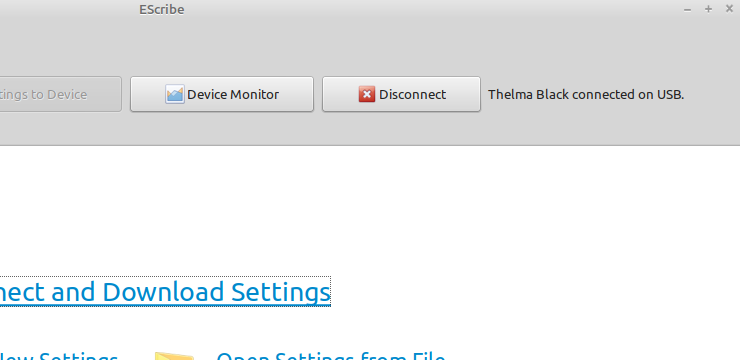

KickMeElmo Posted April 24, 2022 Report Posted April 24, 2022 Pretty sure the group you need to be part of is plugdev. I'm on Mint 19.3 and have no issue, but I'm part of that group for a wide variety of things, so I wouldn't have been directly aware if this specifically required it. Just verified that I can connect fine on the latest build, just to be certain.
AmadVaper Posted April 24, 2022 Report Posted April 24, 2022 8 hours ago, KickMeElmo said: Pretty sure the group you need to be part of is plugdev. I'm on Mint 19.3 and have no issue, but I'm part of that group for a wide variety of things, so I wouldn't have been directly aware if this specifically required it. Just verified that I can connect fine on the latest build, just to be certain. Here are the groups I am a member of : groups user adm uucp dialout cdrom sudo dip plugdev lpadmin bluetooth sambashare vboxusers wireshark power
