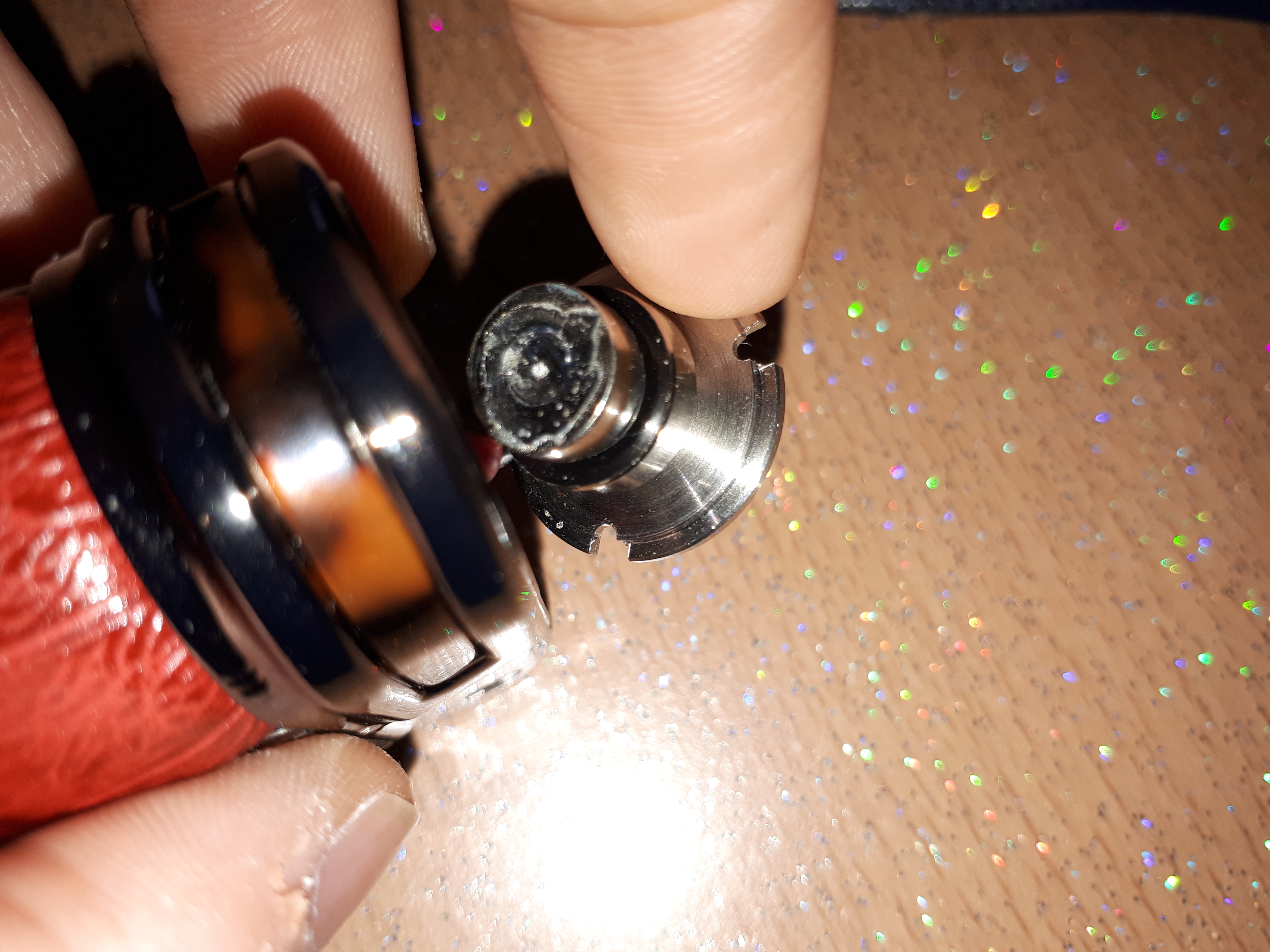

MAGAman Posted January 25, 2018 Report Posted January 25, 2018 (edited) I signed up tonight just so I could give a big shout out to TheSwain. You sir, are a gentleman and a scholar. I received my brand new Paranormal today and was about to rip my hair out with the TC/high resistance issue. I followed TheSwain's instructions and it's all good now. One thing I'd like to add. When you get the 510 apart use something sharp to clean out the threads even if it appears to be clean. Mine didn't look gummed up but when I started going over the threads there was quite a bit in there. Swab with alcohol for good measure and reassemble. Time spent = 20 minutes Edited January 25, 2018 by MAGAman 3
ThatGuySwain Posted January 25, 2018 Author Report Posted January 25, 2018 11 hours ago, MAGAman said: I signed up tonight just so I could give a big shout out to TheSwain. You sir, are a gentleman and a scholar. I received my brand new Paranormal today and was about to rip my hair out with the TC/high resistance issue. I followed TheSwain's instructions and it's all good now. One thing I'd like to add. When you get the 510 apart use something sharp to clean out the threads even if it appears to be clean. Mine didn't look gummed up but when I started going over the threads there was quite a bit in there. Swab with alcohol for good measure and reassemble. Time spent = 20 minutes Glad I can help. That is the reason I made this post to begin with; to help everyone with this problem, without you having to send it in.
AntoVape Posted January 31, 2018 Report Posted January 31, 2018 (edited) @TheSwainI did it on my Paranormal DNA 166 and it works. I solved my problem with fluctuating ohms and improved ohms reading, but there's still a difference compared to my other mods. I cleaned the 510 with hot water...could it be the problem? Should I use alcohol or acetone? Thanks in advance. Edited January 31, 2018 by AntoVape
ThatGuySwain Posted January 31, 2018 Author Report Posted January 31, 2018 8 hours ago, AntoVape said: @TheSwainI did it on my Paranormal DNA 166 and it works. I solved my problem with fluctuating ohms and improved ohms reading, but there's still a difference compared to my other mods. I cleaned the 510 with hot water...could it be the problem? Should I use alcohol or acetone? Thanks in advance. How much difference is there? if you cleaned the thread lock, and its still not reading true, did you check the center pin solder connection? (see last two pictures in guide) if that connection isnt solid, it can still read high ohms. I do all my cleaning here with Alcohol.
AntoVape Posted January 31, 2018 Report Posted January 31, 2018 @TheSwainIt depends. I use Kanthal A1, the smallest difference is about 0,005 and the biggest about 0,1. I tried with 5 different atomizers. Should I check the soldering? How could I remove the black isolator disc?
ThatGuySwain Posted January 31, 2018 Author Report Posted January 31, 2018 17 minutes ago, AntoVape said: @TheSwainIt depends. I use Kanthal A1, the smallest difference is about 0,005 and the biggest about 0,1. I tried with 5 different atomizers. Should I check the soldering? How could I remove the black isolator disc? I would check it, just to make sure, and the black isolator is just stuck on with 3M adhesive. i use a razor blade, or my thumb nail to peel it off. then its usually still sticky enough to just stick back on when you're done.

ManUtdVaper Posted March 4, 2018 Report Posted March 4, 2018 Ok, I have the same problem. I don’t know how to screw off the 510. Alao I changed the internal resistance to 0.12 and now it’s reading ohms perfectly, how can this be ?
andrewmic Posted March 11, 2018 Report Posted March 11, 2018 (edited) Huge thanks for this guide!!! I had the same problem. In my case, 510 was loose, just needed to clean it and screw it tight. Atty's resistance dropped by 0.05. Mod res. after procedure - 0.005 (measured with a cooper screw). Edited March 11, 2018 by andrewmic
Frank65 Posted March 17, 2018 Report Posted March 17, 2018 Thanks for this guide , I managed to improve internal resistance from 0.03 to 0.005 , just by cleaning and screwing , no desoldering needed.
