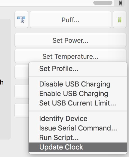

6 hours ago, Wayneo said:
This should work.
Device Monitor -> Diagnostics  -> Clock
I don't want to be rude but let's try to be professional here. I know about this option - been using DNA & Escribe since the very 1st that came out. This does not solve the issue as the issue is probably coming for the malfunction of the board itself.
Evolv Support provided me also extremely useful information which was to connect to the escribe and set to "removable batteries" ... which is kind of an obvious thing you do once you receive a device which I did long time ago and also is not a solution.
