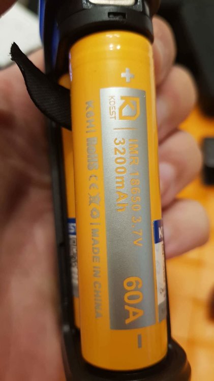

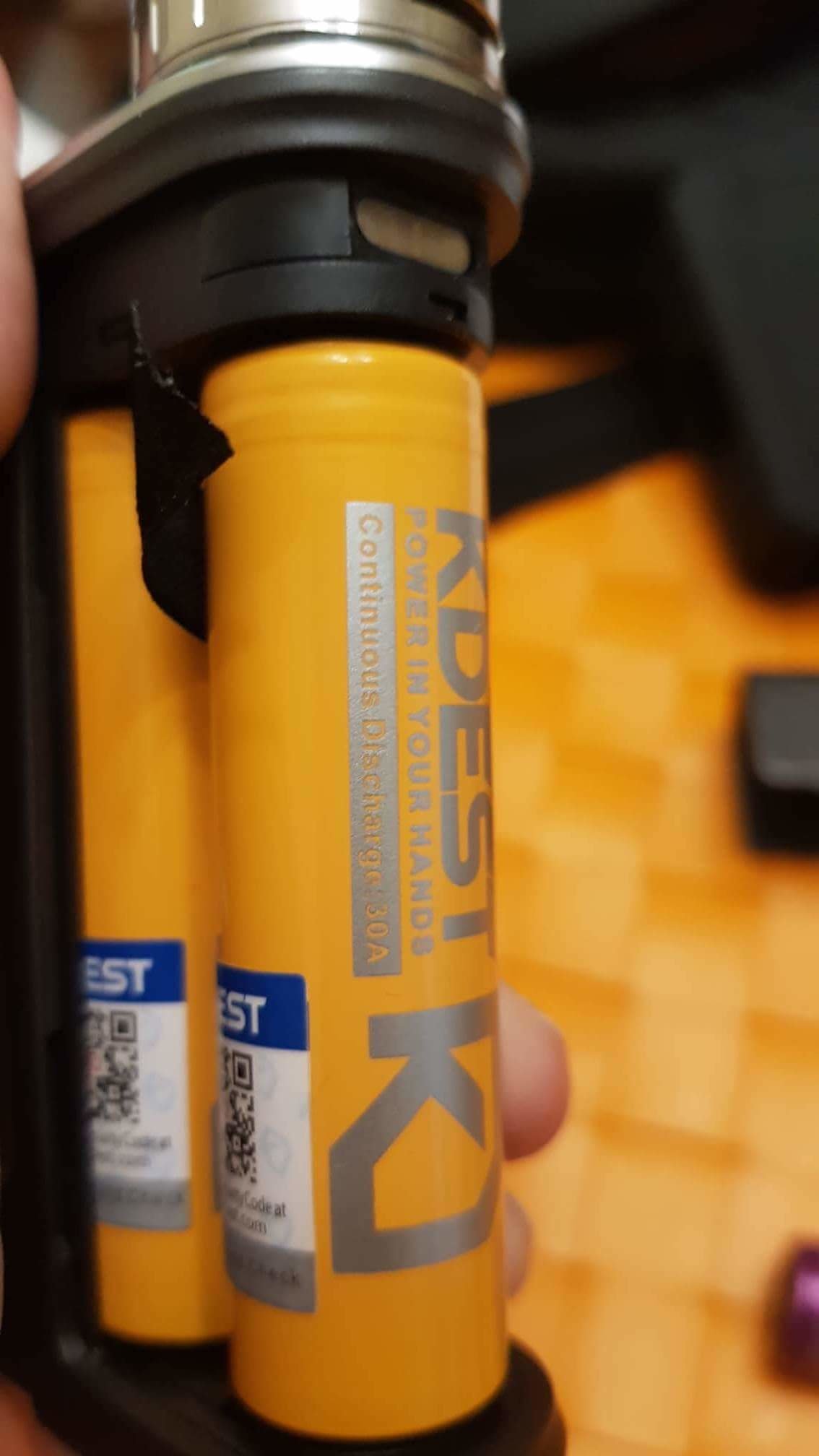

Tarek salem Posted June 30, 2018 Report Posted June 30, 2018 Hii plz i need the csv file for this battery as it's not staying at all while i bought it cause someone told me it's good and stay well.. plz help me My mod is therion 75c and batteries are in the attached pix (kdest)
Wayneo Posted June 30, 2018 Report Posted June 30, 2018 Hey @Tarek salem On 12/11/2017 at 12:51 PM, jakeycrx said: The CSV file has no impact on battery life. It is purely to make the battery meter accurate, nothing more. But you can run your own with the Battery Analyzer tool. Most accurate results for your batteries.
Tarek salem Posted July 1, 2018 Report Posted July 1, 2018 dear @Wayneo if u can help me setting up my batteries manually? I allready attached my battery info in my first question.. i need to set : 1 - cell soft cutoff 2 - max peak input current 3 - max sustained input current plz help me if u can , thank a lot
Wayneo Posted July 1, 2018 Report Posted July 1, 2018 I have never heard of those batteries. No idea what's under the wrapper, but the specs I see are 'suspect'. Google Battery Mooch. For your 3 points, I'd just leave them at the Evolv default. For point 1, the keyword is 'soft' <- upon firing and under load. Usually/commonly set anywhere from 2.75-3.0V
