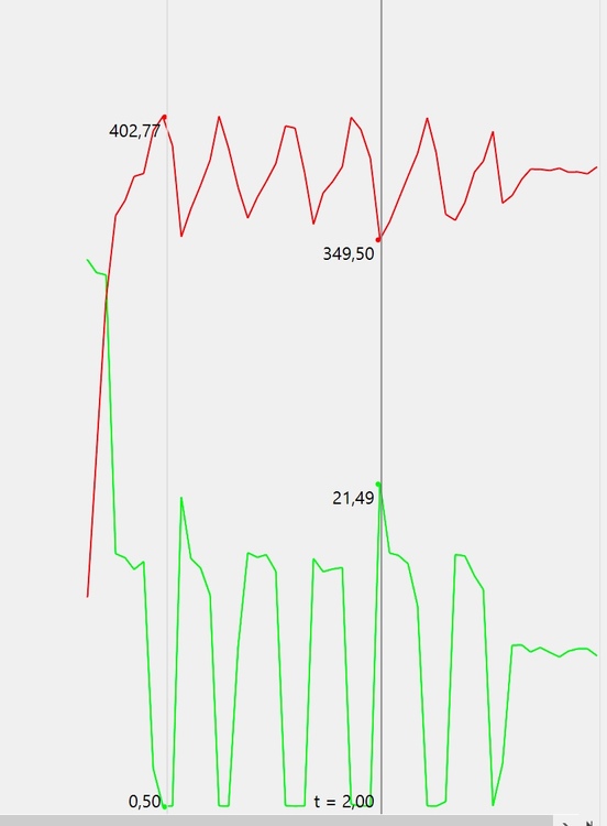

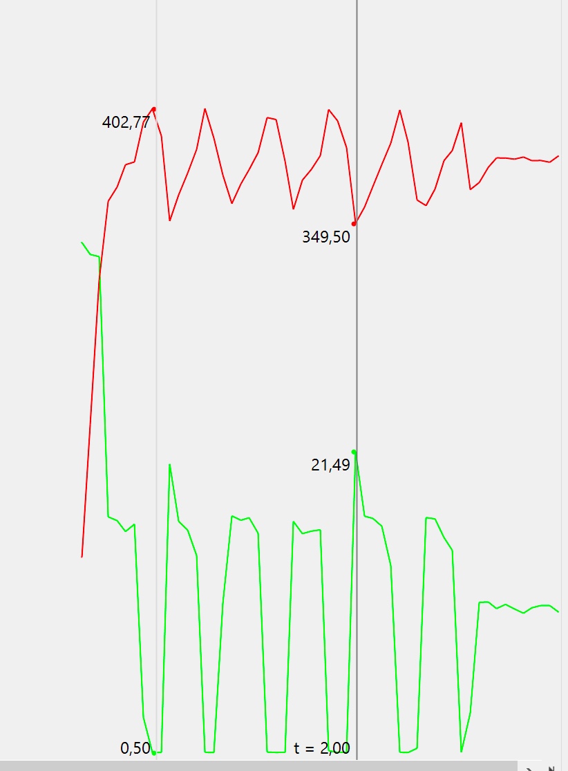

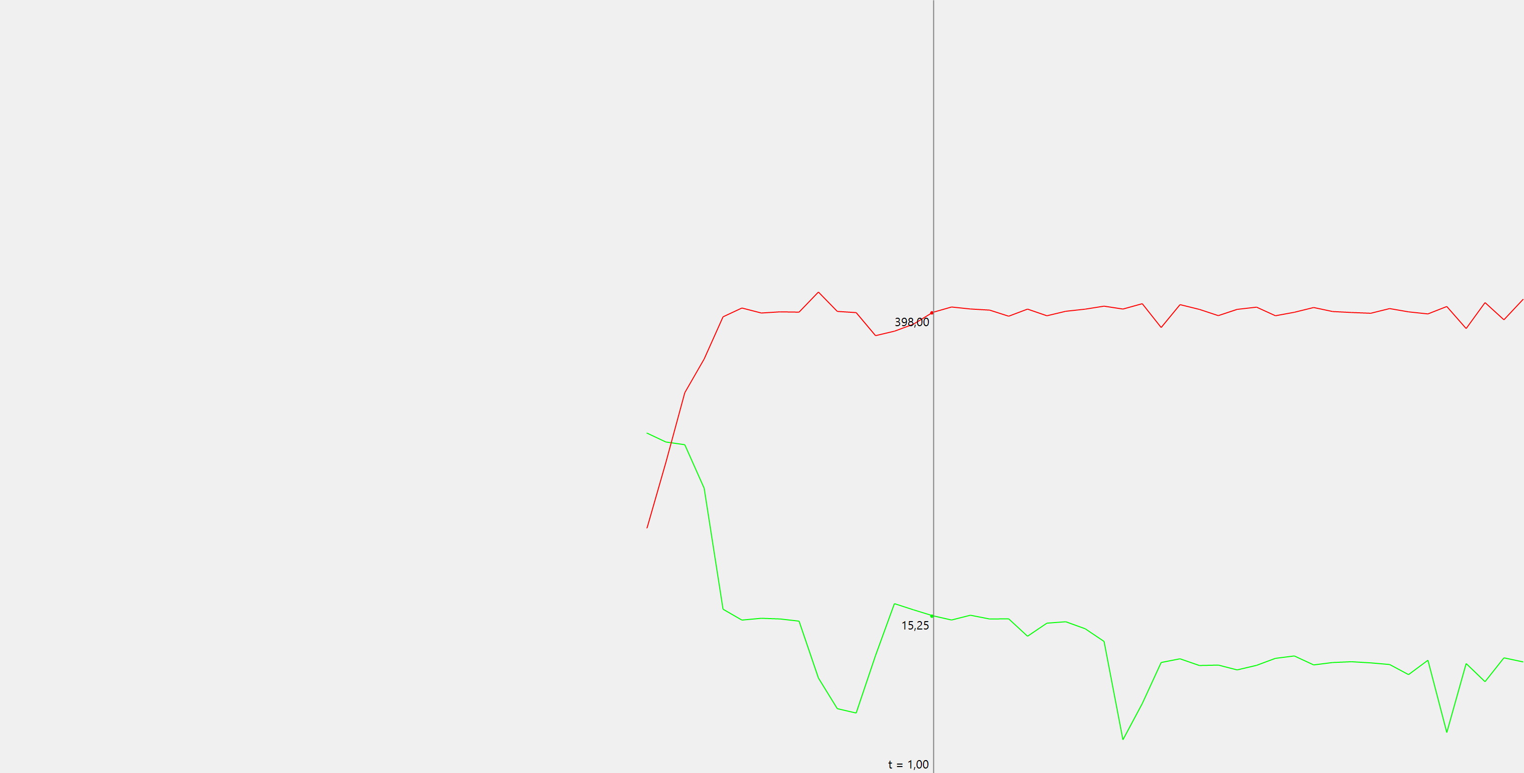

ndb Posted June 15, 2017 Report Posted June 15, 2017 1 hour ago, James said: OK. Well that rules out X=READ DEBUG being the problem. Out of curiosity, what power level is it dropping to there? (To get to the recording, go to Device Monitor -> History -> Download All Recordings). It looks like a current offset issue, to be honest. @James I don't know enough to follow your reasoning, but here's the screenshot of the puff#1774 once I downloaded it in Escribe. I've put a pair of peak/valley cursor for you to see the TEMP/POWER levels
James Posted June 16, 2017 Report Posted June 16, 2017 Howdy @ndb. Give this firmware a try. I think the issue is current offset when it's down at 0.5W. In Serial Terminal, X=GET COB gets the current offset. It is 0.025 by default on DNA 75 Color. On a DNA 75, it is 0.0625. Try X=0.0625 COB and see if it fixes the oscillation. I suspect it will. Thanks! DNA 75 Color v1_1_SP22_Beta2p2.sw-service 1

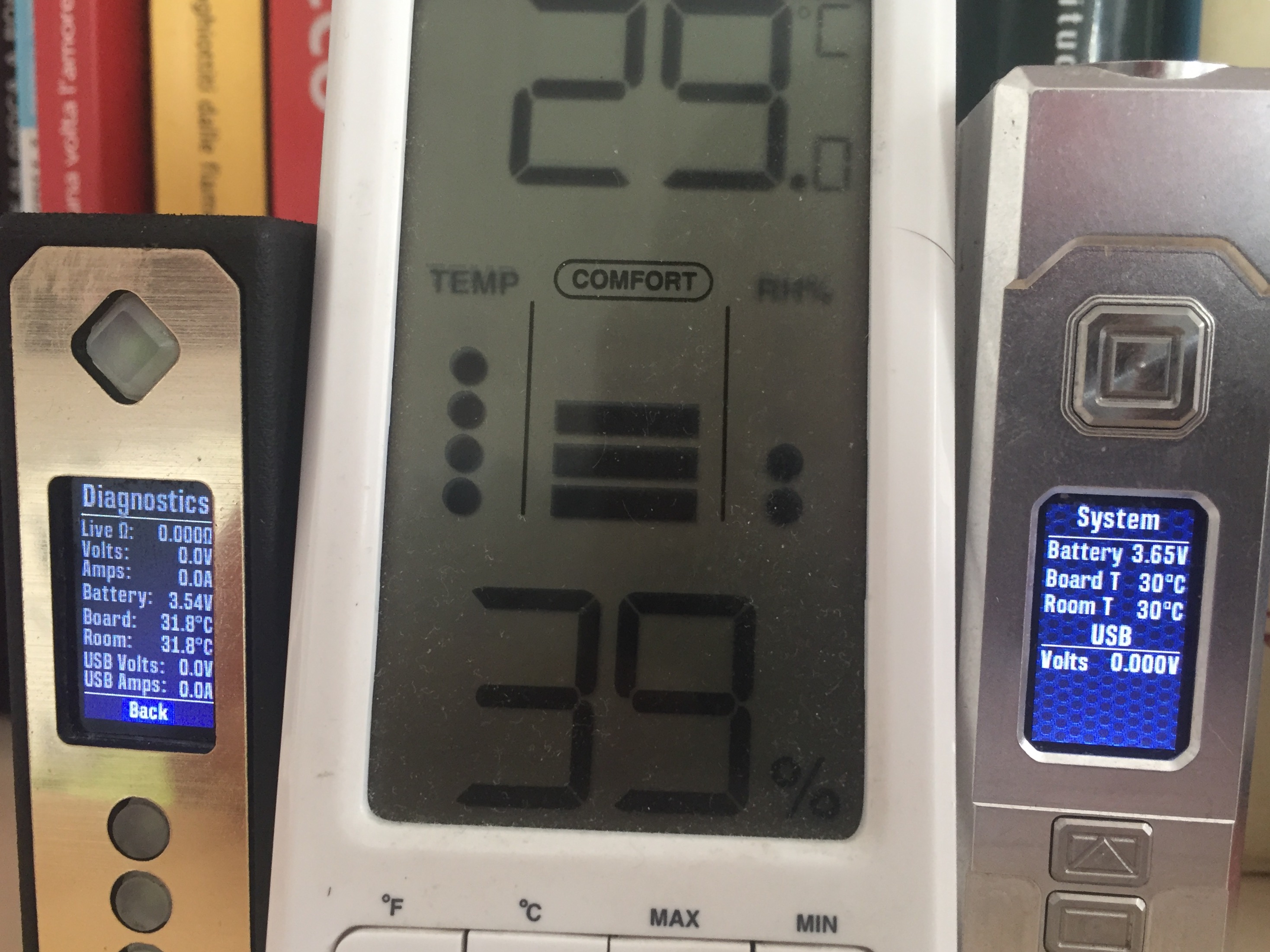

lordbyron77 Posted June 18, 2017 Report Posted June 18, 2017 Here you are two 75C with beta2, I let them rest all afternoon. I would say that the error is acceptable 👍 29°C at home (Chinese thermometer LOL) 31.8°C MTO DNA75C 30°C Reference box 1

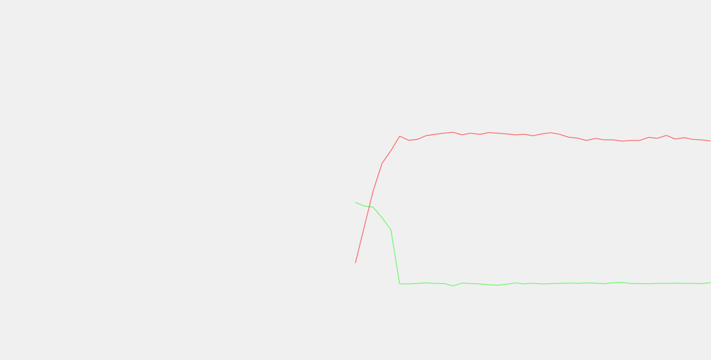

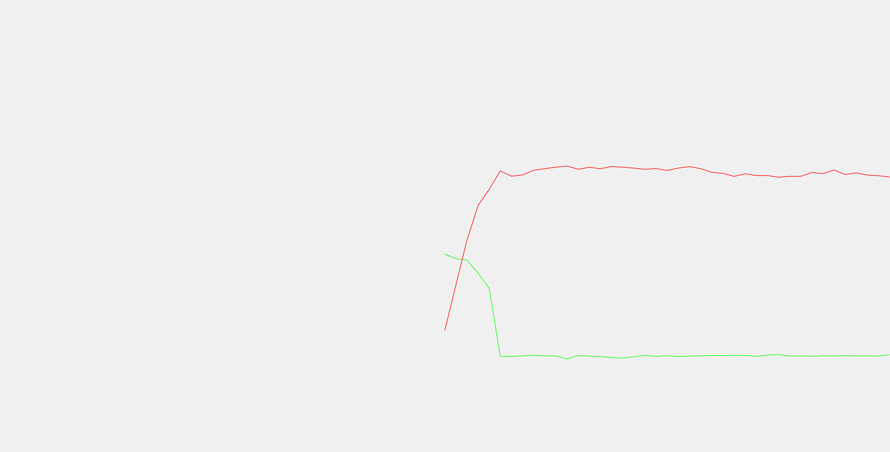

ndb Posted June 19, 2017 Report Posted June 19, 2017 On 6/17/2017 at 1:59 AM, James said: Howdy @ndb. Give this firmware a try. I think the issue is current offset when it's down at 0.5W. In Serial Terminal, X=GET COB gets the current offset. It is 0.025 by default on DNA 75 Color. On a DNA 75, it is 0.0625. Try X=0.0625 COB and see if it fixes the oscillation. I suspect it will. Thanks! DNA 75 Color v1_1_SP22_Beta2p2.sw-service Hi @James, sorry for the late reply but I've been again on the move and couldn't access Escribe until today. Whatever this setting is doing, it works! I just got a bit confused initially because it seemed like it worked just "for a while", then I realized that after a while (maybe when the device locks/unlocks or when I reconnect to Escribe?), the setting reverts to 0.025, as confirmed by X=GET COB. I couldn't really nail down exactly when/why, but I then started to always setting it back to 0.0625 before testing and then I got repeatable results. For comparison, here are two consecutive puffs, the first with 0.025 and the second one with 0.0625: COB=0.025 COB=0.0625 I hope this is what you expected and gives you all you need to maybe prepare another service pack which makes this a permanent setting? Eagerly waiting for your feedback, thanks again.

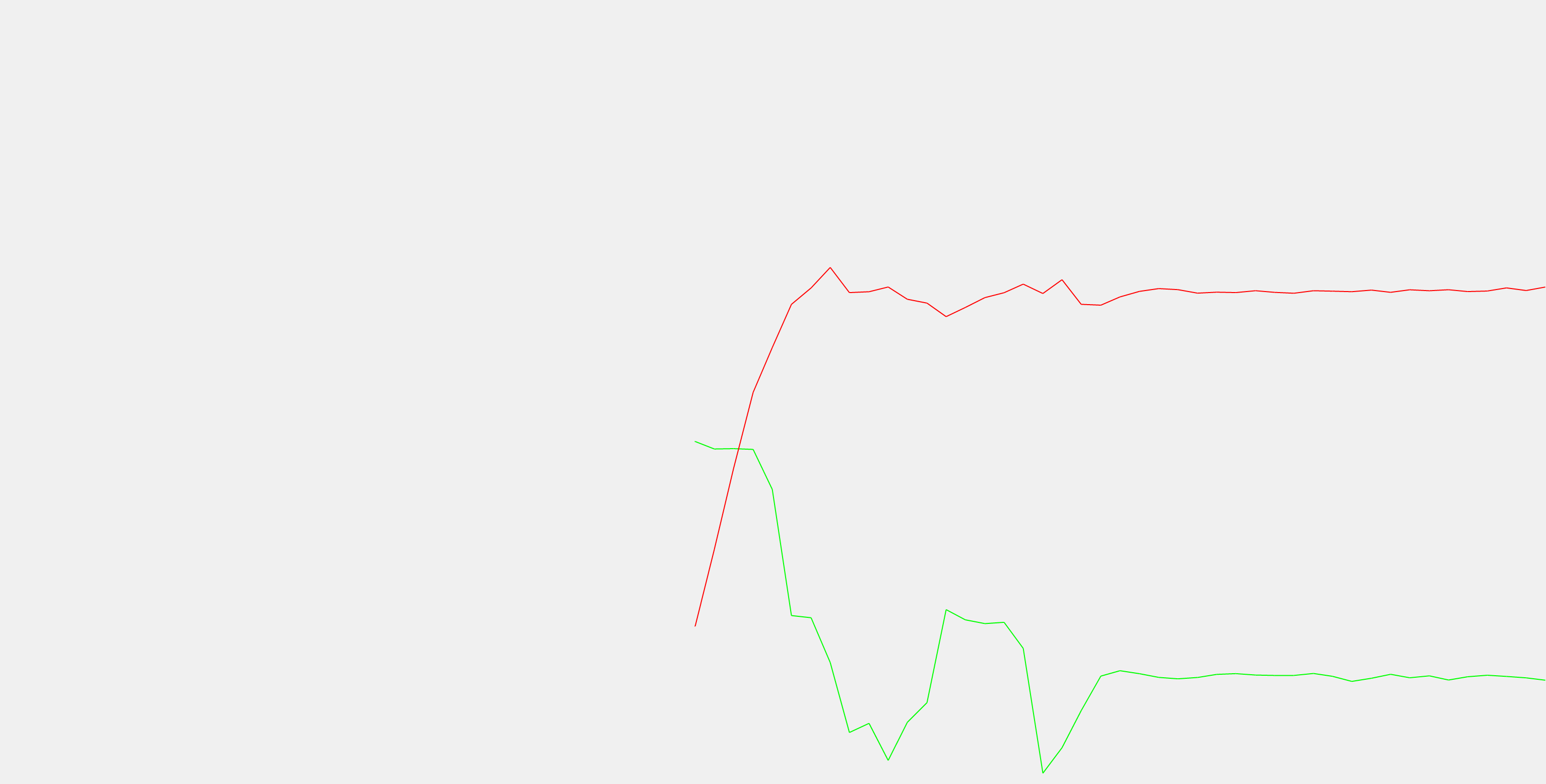

James Posted June 19, 2017 Report Posted June 19, 2017 Yes, the debug setting doesn't retain after power-off. It looks like the steady state power is different slightly. Am I seeing that correctly? Also, could you try an in-between value such as 0.04?
ndb Posted June 19, 2017 Report Posted June 19, 2017 23 minutes ago, James said: Yes, the debug setting doesn't retain after power-off. It looks like the steady state power is different slightly. Am I seeing that correctly? Also, could you try an in-between value such as 0.04? @James, yes you're right. I didn't notice it but the steady state power for COB=0.025 is about 10W, while for COB=0.0625 is about 15W. Both puffs were taken with power set to 16W, TEMP=400F, pre-heat 32W 395F. I tried with COB=0.04 and I got this COB=0.04 The "first" steady power is ~15W (as you can see from the cursor), while the "second" one is again down to ~10W. Tried also with COB=0.05, got a first puff still pulsy, then the following ones were pretty much like COB=0.0625 (with steady power ~15W), but it felt like it was less repeatable and on the verge of pulsiness... As a side note: while on COB=0.0625, for a couple of time I got immediate "temp protection" when trying to fire. Then at the 3rd or 4th attempt it started firing again.
