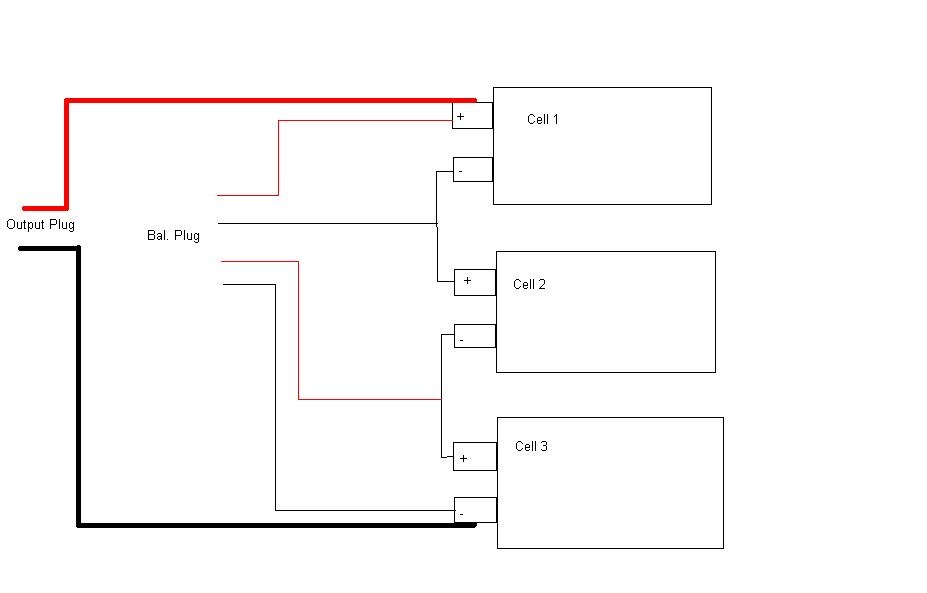

Guest Posted August 3, 2015 Report Share Posted August 3, 2015 You can use 2 or 3 18650 batts I'm using sony vtc4 here's a lay out on connecting the batteries if you use two batteries soder or jumper 2 and 3 together on the board and run the #2 wire to the battery and make sure you change it in escribe to 2 cell. Oh! I forgot to say using 2 batts your wattage will max out at 133w Link to comment Share on other sites More sharing options...
VapingBad Posted August 3, 2015 Report Share Posted August 3, 2015 That will work, but there is no reverse battery protection, Evolv plan to bring out a accessory board/module that can do that. Link to comment Share on other sites More sharing options...
Guest Posted August 3, 2015 Report Share Posted August 3, 2015 That's cool, if it's super small I might get it, but I'll just make sure my batts are in the right way Link to comment Share on other sites More sharing options...

VapingBad Posted August 3, 2015 Report Share Posted August 3, 2015 lalemandrew said:So if I use 3 will I get 200w and if I buy the battery evolv sells do I need 1 or 3 of the 19.99$ packsYou only need one 3S LiPo like the ones Evolv have for sale.For 18650s: 2 will limit you to 133 W but 3 will allow the full 200W, but for bothe these configurations there is no reverse battery protection and you need good cells, on paper that is only the Sony VTCs ATM, but the LG HE2 and Samsung 25R will almost certainly be OK. Link to comment Share on other sites More sharing options...
