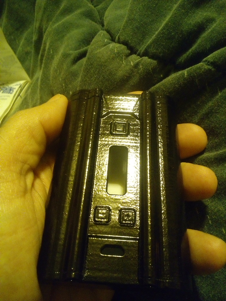

Podunk Steam Posted September 5, 2015 Author Report Share Posted September 5, 2015 Thanks! My partner and I worked up the design, it makes for quick easy battery changes with no parts to get lost or any need for tools.Here, you may have seen this though. I've haven't done the dip coatings yet although they do look pretty cool. Are there different finishes, I mean like glossy, semi gloss, flat.....? Mating patterns on a full 360 coat could be a trick I'd think. The epoxy paint on the 3D prints almost has a leather, kinda grippy feel, my favorite coating so far. Link to comment Share on other sites More sharing options...
alee132 Posted September 5, 2015 Report Share Posted September 5, 2015 Honestly the picture must not do it justice because it looks like a bad spray paint job. Sometimes pictures just make things look a lot different though. Link to comment Share on other sites More sharing options...

Podunk Steam Posted September 5, 2015 Author Report Share Posted September 5, 2015 I'm very much a function before form person although when possible I can dress a mod very nicely. The 3D prints have an odd texture that absorbs the paint for the first few coats and if patience the texture can be smoothed through multiple coatings of paint and sanding between coats. Coating the 3D prints has been a work of trial and tribulation for myself, others have done much better than I have so far. Link to comment Share on other sites More sharing options...

blueridgedog Posted September 5, 2015 Report Share Posted September 5, 2015 Podunk Steam said:I'm very much a function before form person although when possible I can dress a mod very nicely. The 3D prints have an odd texture that absorbs the paint for the first few coats and if patience the texture can be smoothed through multiple coatings of paint and sanding between coats. Coating the 3D prints has been a work of trial and tribulation for myself, others have done much better than I have so far.I have gotten amazing results with acetone, acetone based nail polish and CA. Link to comment Share on other sites More sharing options...
Podunk Steam Posted September 5, 2015 Author Report Share Posted September 5, 2015 I did test it with connecting part of prints and it didn't really work for me although there could be a difference in the plastic I tested to what I seen on the internet. Link to comment Share on other sites More sharing options...
Podunk Steam Posted September 5, 2015 Author Report Share Posted September 5, 2015 You know which type of plastic? Three coats appliance epoxy out of a rattle can. Link to comment Share on other sites More sharing options...
Mad Scientist Posted September 5, 2015 Report Share Posted September 5, 2015 Podunk Steam said:You know which type of plastic? Three coats appliance epoxy out of a rattle can. Looks good. I know photos show a lot more texture than what it actually looks like in hand (at least with my eyesight lol). Superb engineering job. The hinged doors are over the top! Link to comment Share on other sites More sharing options...
