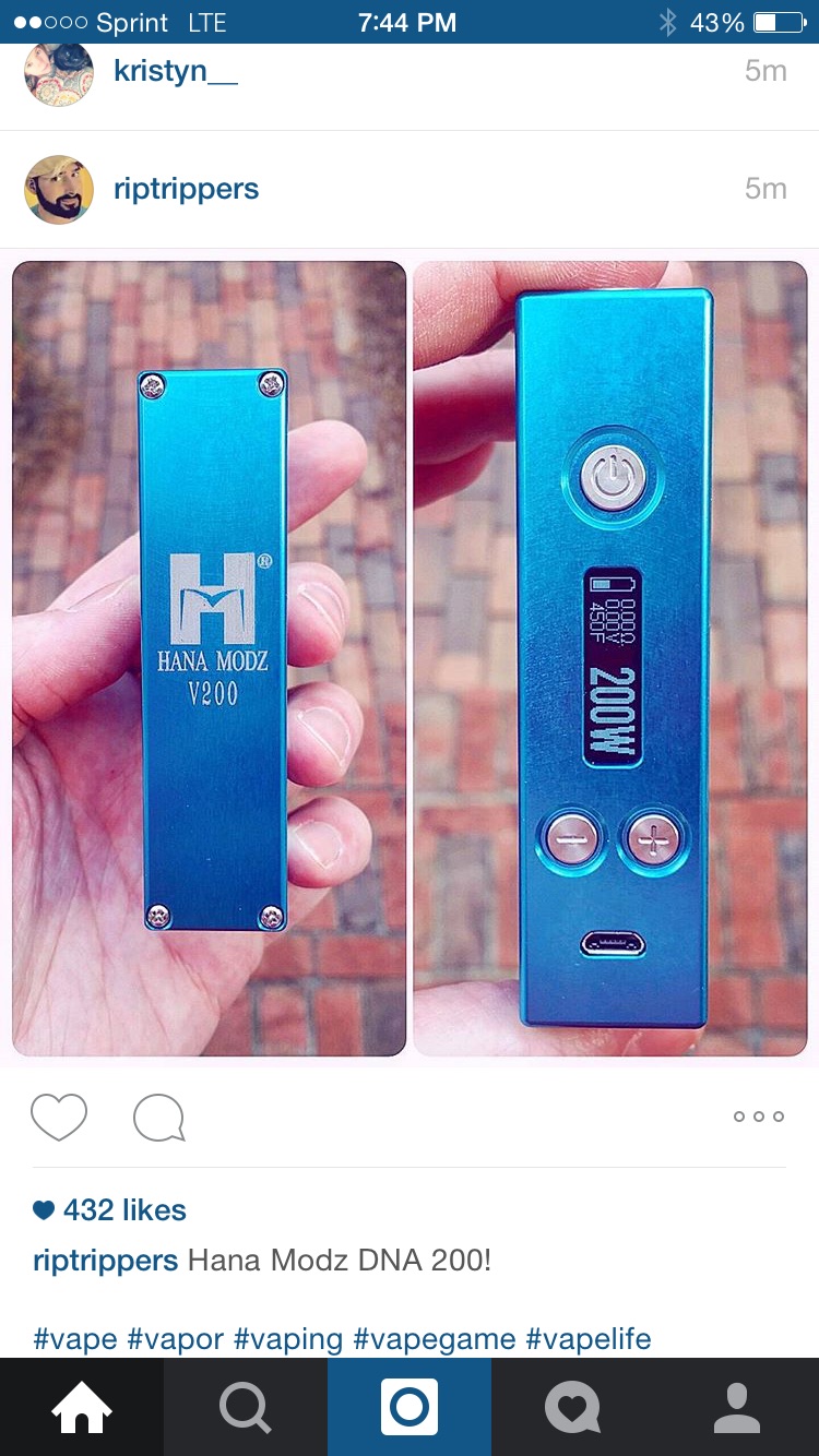

Tomr1088 Posted August 13, 2015 Report Share Posted August 13, 2015 Just saw this. If anyone wanted to see how the production model looks. Looks way better but not worth the risk to me still. Idk. If I can sel my fixed Hana and I see the new one isn't problematic and it's not more than 250 I'll buy. Link to comment Share on other sites More sharing options...
Tomr1088 Posted August 13, 2015 Report Share Posted August 13, 2015 Looks like they meant it when they said the faceplate will be the only difference. Looks like they made it better and used better buttons. Wonder if they made a better 510. Wanna see that and what the sides look like. Link to comment Share on other sites More sharing options...
