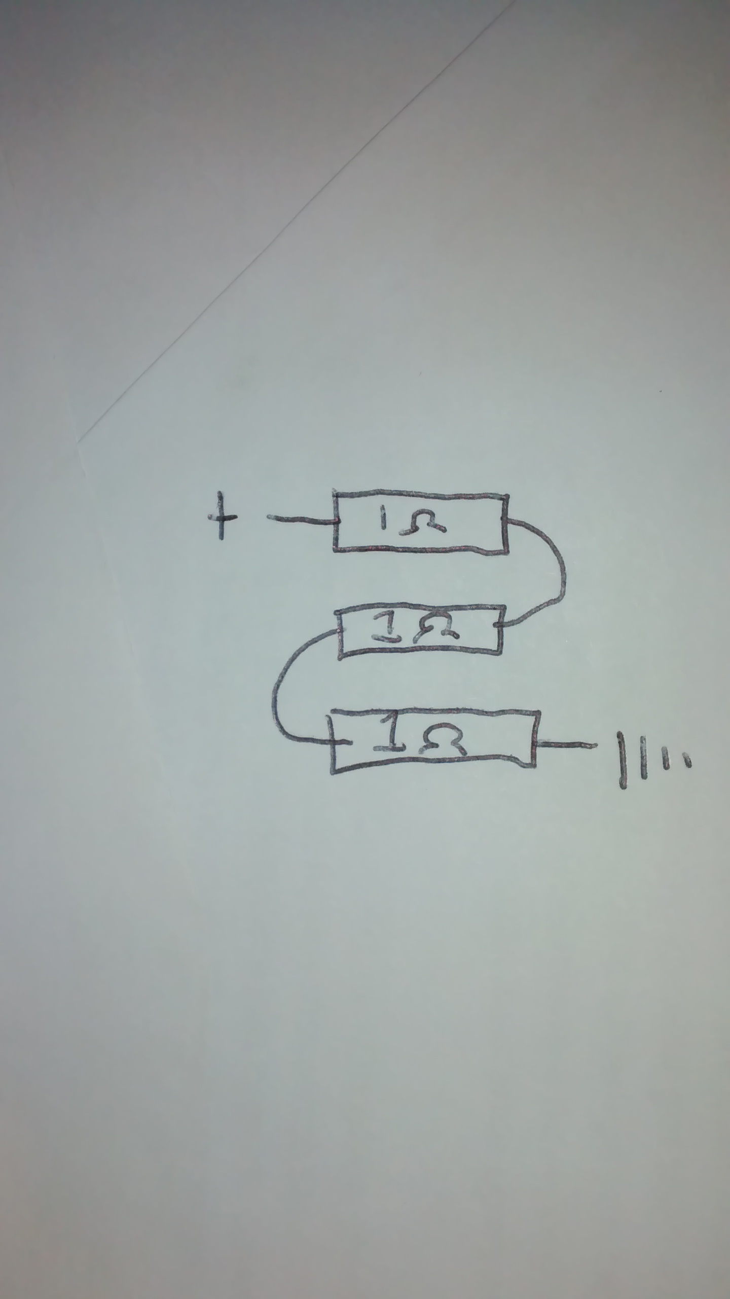

Alex faught Posted December 20, 2015 Report Posted December 20, 2015 Nick said:[QUOTE=mactavish]If you get a chance, put up a quick photo of you wiring and this rig. Interested in how you connect it to the mod. This is affordable, but on the large size, guess it can't be made much smaller. Here you go. I put a plug between the base and atty so you don't have to spin the whole setup onto the mod. Screw the atty in, plug it into the rest of the rig, and start the test.https://instagram.com/p/9JsRgnCwWv/?taken-by=dogmods[/QUOTE] Those look like they are wired in parallel. If that is the case it would come out to 4 ohms. One would have to put three end to end to get the desired .25 ohm.
Spector NS5 RD Posted December 20, 2015 Report Posted December 20, 2015 Alex faught said:[QUOTE=Nick][QUOTE=mactavish]If you get a chance, put up a quick photo of you wiring and this rig. Interested in how you connect it to the mod. This is affordable, but on the large size, guess it can't be made much smaller. Here you go. I put a plug between the base and atty so you don't have to spin the whole setup onto the mod. Screw the atty in, plug it into the rest of the rig, and start the test.https://instagram.com/p/9JsRgnCwWv/?taken-by=dogmods[/QUOTE] Those look like they are wired in parallel. If that is the case it would come out to 4 ohms. One would have to put three end to end to get the desired .25 ohm. [/QUOTE] they are wired in parallel, yielding .25 ohms. if you wire loads in series THEN you multiply resistance. series would yield 4 ohms in this setup, not parallel. in your drawing you have three one ohm resistors wired in series which would a three ohm load.
Alex faught Posted December 20, 2015 Report Posted December 20, 2015 I had a major brain fart (hennessey). I would still think that 4 100 ohm resistors in parallel would bring the resistance down to 0 ohms. Just rambling though, still a little tipsy and getting tired lol.
