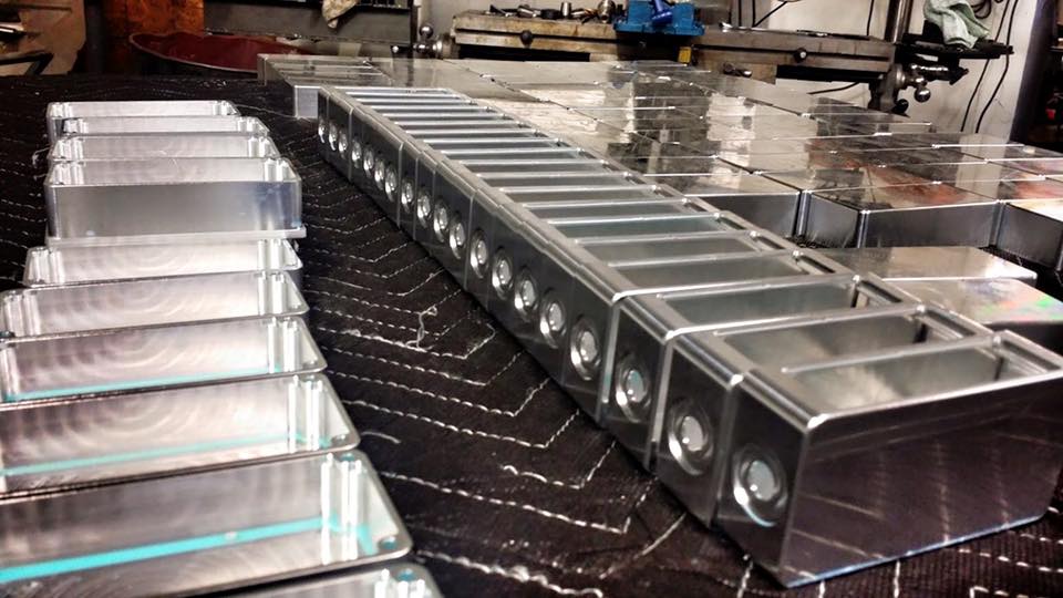

Russ ModCrate Posted September 6, 2015 Author Report Posted September 6, 2015 Hey Evolv Modders,Just wanted to show some of what we have been working on. Currently we have Mod Crate Tallboys being milled for the Mamu faceplate. We went this route vs something more fancy and refined as we though it would be a great entry level enclosure for new modders. It offers plenty of room and the Mamu faceplate is incredibly easy to install brining the difficulty level down significantly. In the future we will have some boxes with integrated mounting points and cut outs for the reference case button actuators.Is there anything specifically this community of DNA users would like to see? What gives you guys a headache when building DNA/DNA200D mods? We like running our machines but we like solving problems even more.Russ Mod Crate
Podunk Steam Posted September 6, 2015 Report Posted September 6, 2015 That's all nice but why would you want to put a face plate in a box when the back interior of the 1590 A you make could be milled to have standoffs for mounting, display window, USB hole and button holes?I have plans to mill a press in structure that will do the equivalent of the mentioned. I'm not CNC equipped or I'd be doing it myself, it's a different world hand cracking everything!

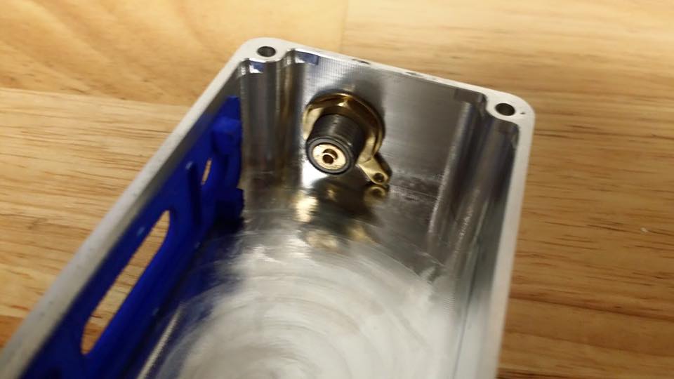

blueridgedog Posted September 6, 2015 Report Posted September 6, 2015 The most critical need for a good DNA200 mod, both for the one off DIY guy and for the 100 at a time artisan shop, is the evolv 510. The extra pressure from the wave spring and the method of stopping the downward travel of the support (the C clip vs threaded plastic) should become standard. Additionally, if you are mounting the box into the cnc machine why not cut away less material and have the right holes for the ship vs needing another part?

Russ ModCrate Posted September 6, 2015 Author Report Posted September 6, 2015 Awesome thanks for all the responses guys. There are a few reasons we started off the way we have.[QUOTE]That's all nice but why would you want to put a face plate in a box when the back interior of the 1590 A you make could be milled to have standoffs for mounting, display window, USB hole and button holes?/QUOTE]Why did we go with a face plate for our first DNA200 enclosure?Well a few simple reasons. The specific faceplate is popular and designed by a respected member of the modding community. We stayed away from internal mounting points this time because it minimizes working inside the confines of the enclosure. Additionally the goal of this project was price point and end user success rate, with a mostly finished faceplate and precut enclosure there is very little risk that button holes wont line up properly.We have more enclosures in the works however we expect them to be significantly more expensive, for these enclosures we are considering using the Evolv 510 it really depends how popular it becomes for DIY modders in general.

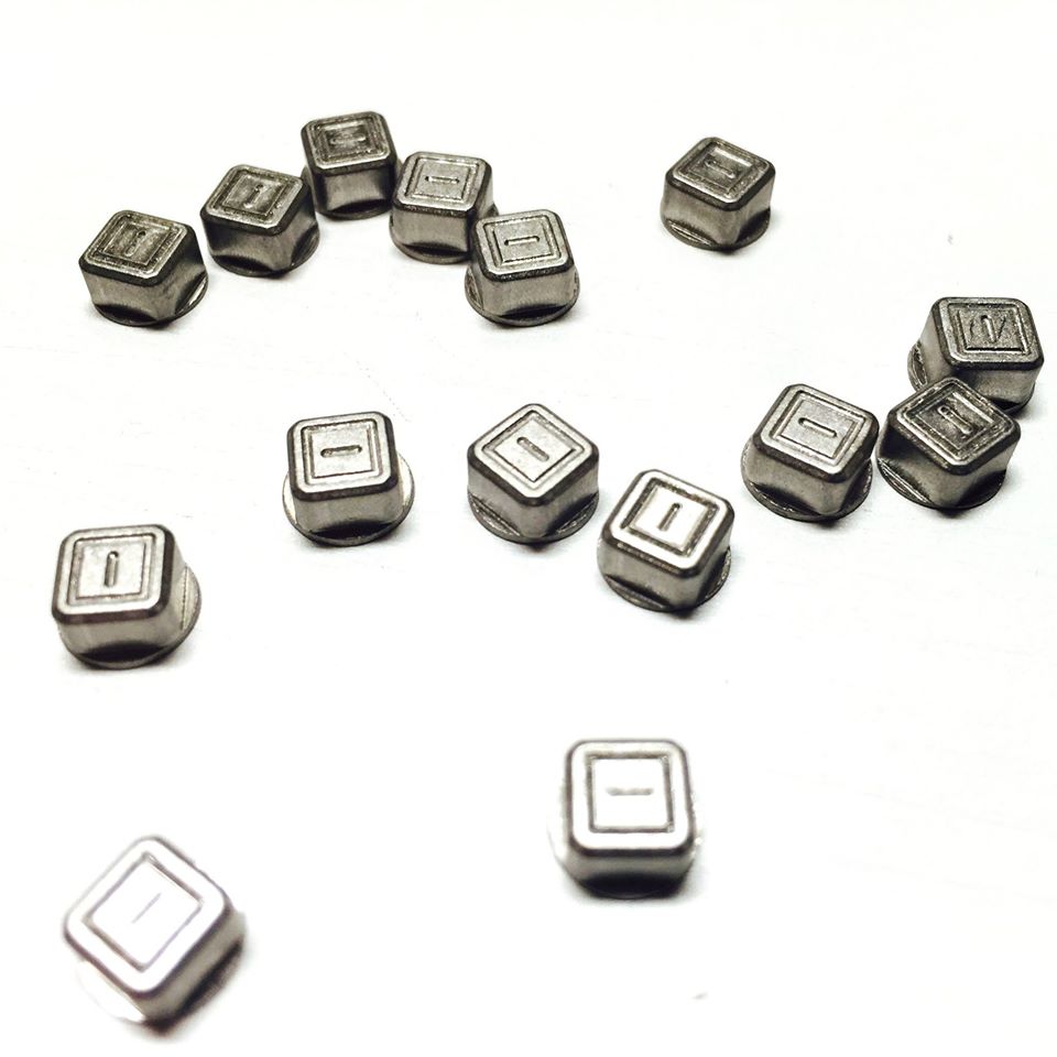

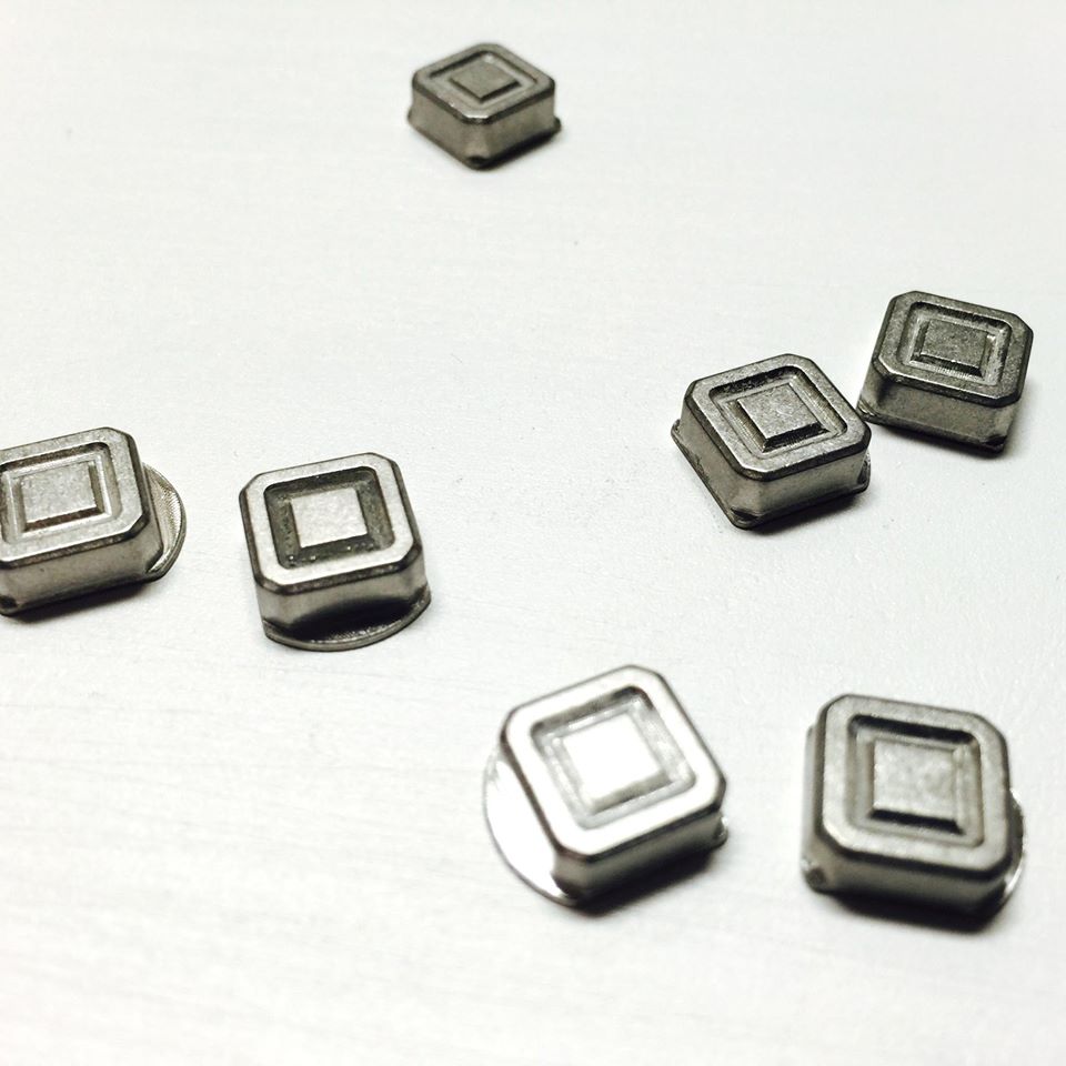

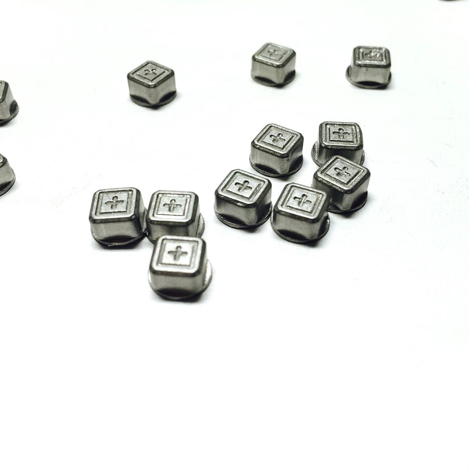

scoopy Posted September 7, 2015 Report Posted September 7, 2015 Is there any way to make or modify the mamu faceplate to fit the reference buttons......I absolutely hate them round buttons on that faceplate especially matching color....It looks cheap imho......I would love a B or G box with the cutouts already milled for the square reference buttons or a faceplate with them in it......Of course I would want the recessed 510 as well.....I like where u guys are going though and will have my business once a bigger box is offered

scoopy Posted September 11, 2015 Report Posted September 11, 2015 THE EVOLV 510 IS fantastic! ! It solves most connection issues with bad connections in attys by using the wave spring they used.....its also a lot beefier and basically 1 part .....The 510 an insulator and a c clip holds it all together. ..I want to strongly suggest MOD - CRATE to PLEASE start manufacturing and carrying them! !!! I knows us Modders want them so bad and I know they will sell like crack on your end lol!! Also I'd like to see a B box with the recessed 510 and the buttons and window all cut out instead of a faceplate ...Also I want to see the reference square buttons in that same B box just like u guys show in your pic's that u r making the buttons now....Please Consider and I'm totally fine with a higher cost....maybe anodised them different colors to or I'd really love a rubbery flat black finish just like a Vapor Shark.....I painted my beta reference box I got from EVOLV this way and love it!!!

Podunk Steam Posted September 13, 2015 Report Posted September 13, 2015 Thanks Blueridgedog! That's a different beasty and looks a lot more manageable with 12 gauge than other 510s out there.Oh boy, I snaked a display from a board for a repair being I ordered another display, hope they aren't out too long!

Russ ModCrate Posted September 15, 2015 Author Report Posted September 15, 2015 we can manufacture them however it's not our design and we don't intend to clone one of our suppliers products without permission. We haven't asked but I'm gonna go ahead and assume this is something they would like to keep for themselves. And there's absolutely nothing wrong with that it is an excellent designed connector. As far as a 1590 be enclosure goes that is in the works as well as a few other things.
