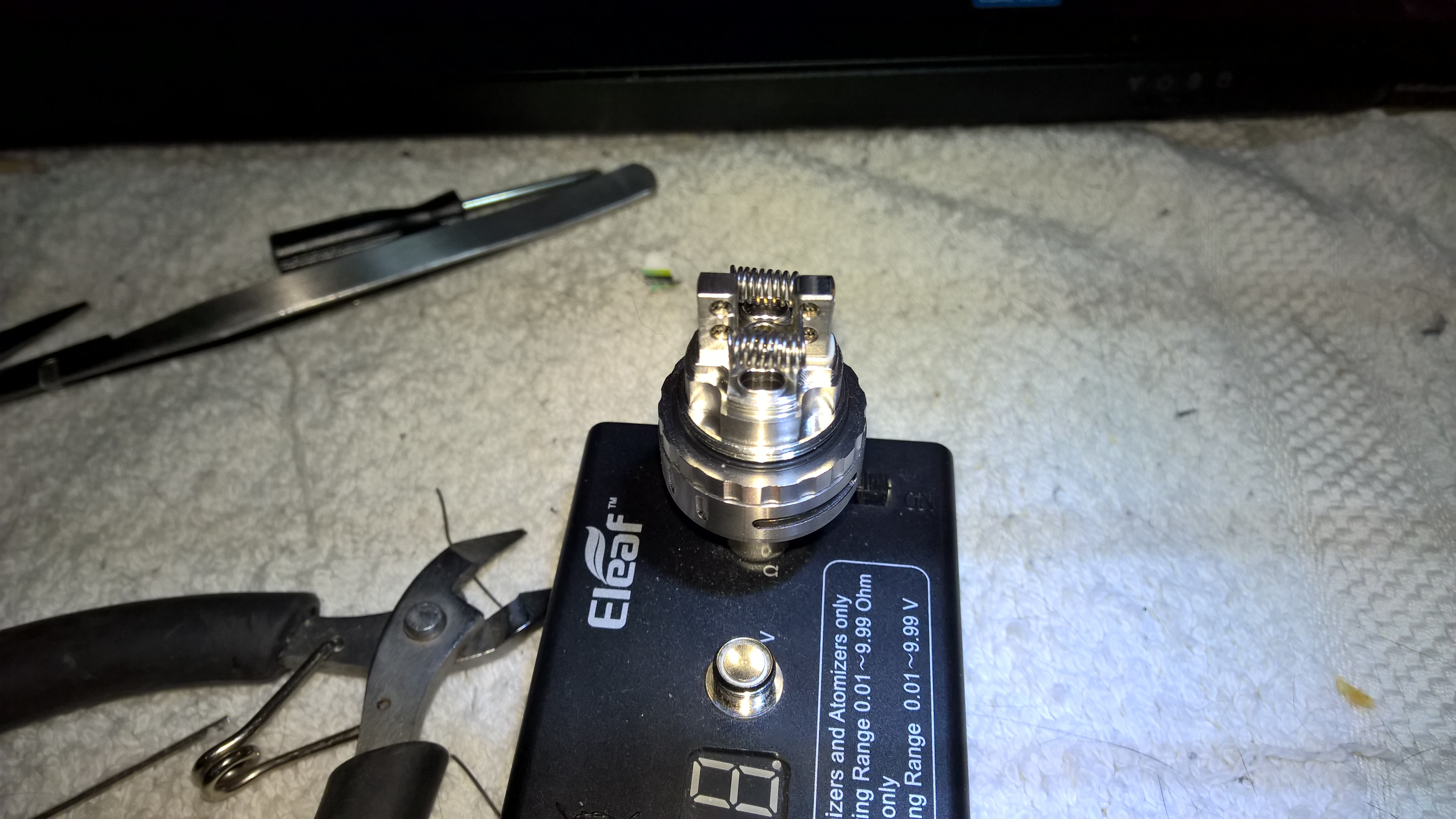

iteevision Posted January 17, 2016 Report Posted January 17, 2016 I did it today on 'the griffin'9 wraps 2.5mm dual SS430/awg24@0.15ohm and vaping@205°C@50WattMOD hcigar VT200 with csv for SS430 from Steam.pre-head setting 1, 1 and 0Vaping beautifully with stable vape en excellent taste
ckay1989 Posted January 18, 2016 Author Report Posted January 18, 2016 Hell yeah build looks good man! Can't wait to get my 430 wire!
