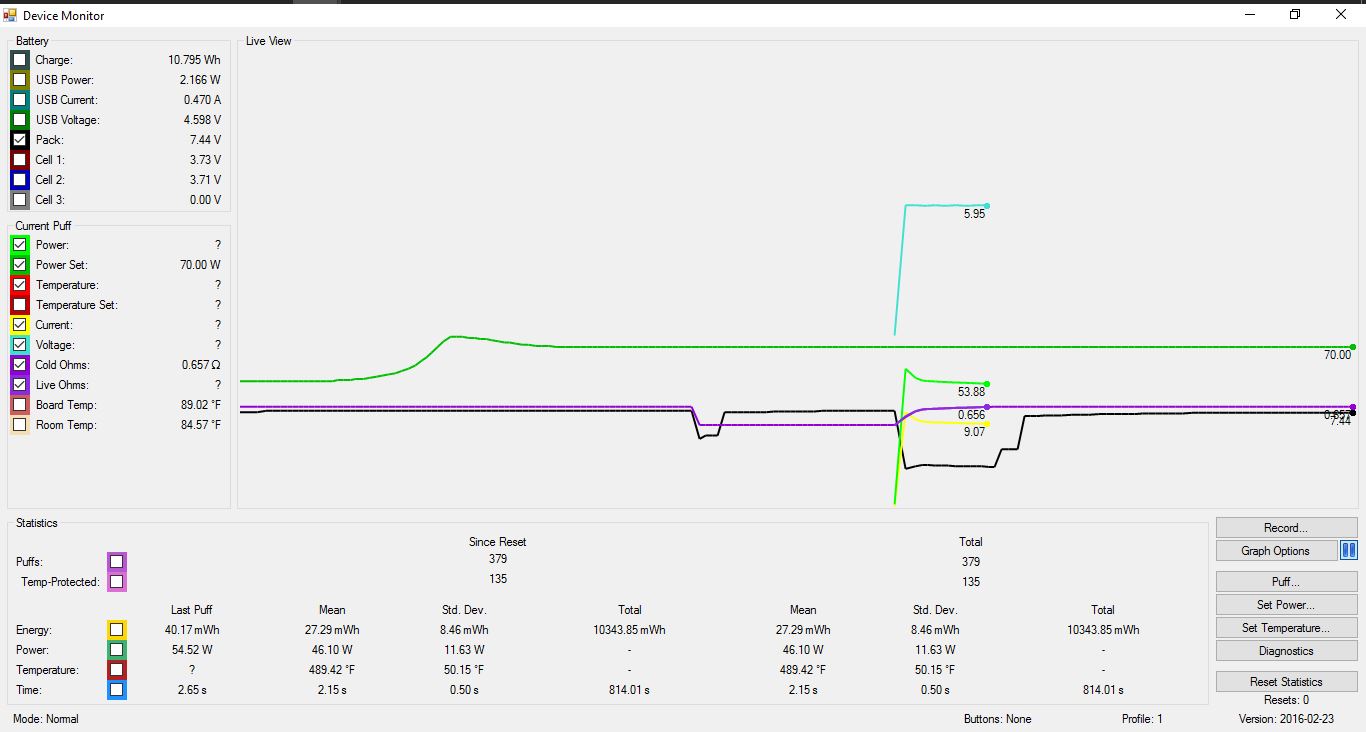

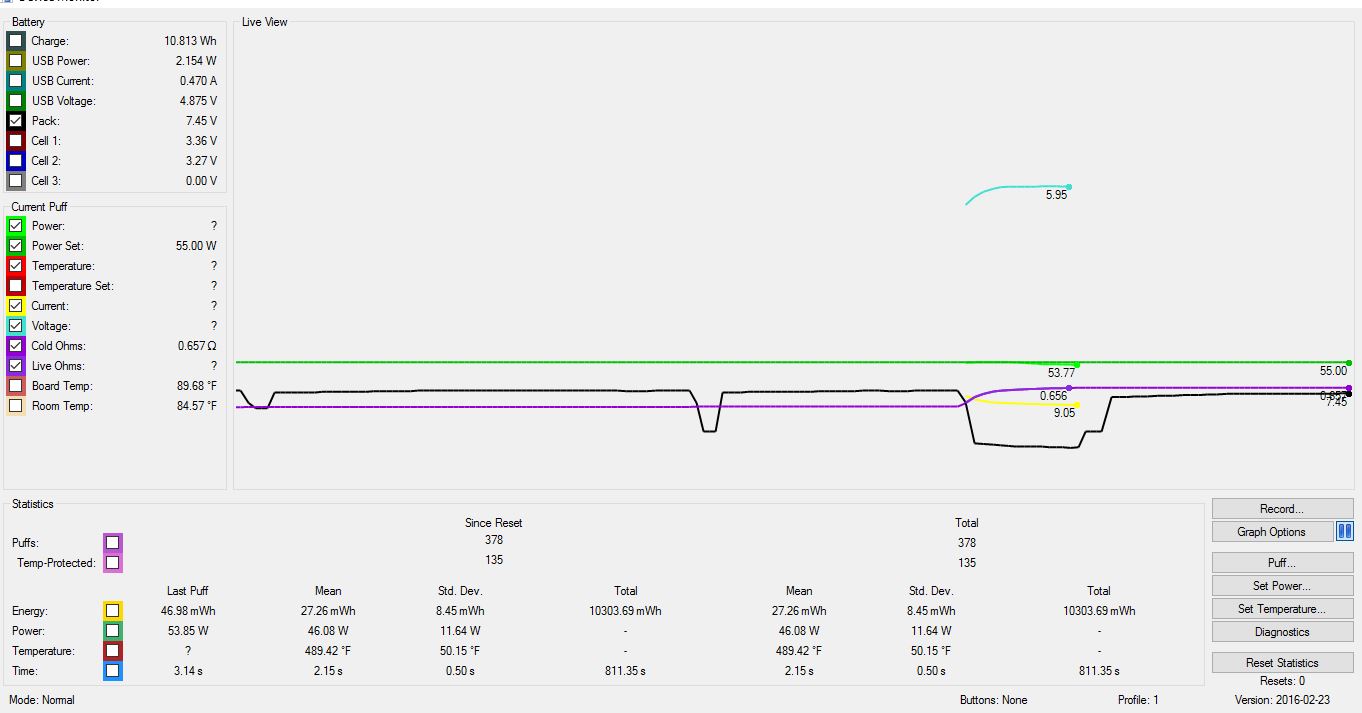

VapingBad Posted April 18, 2016 Report Posted April 18, 2016 It is probably because the 2 cell variants are limited to 6 V output, 0.5 ? should be OK up to about 65 W, but running in power mode the warm res will be a bit higher. You need a lower res coil really.https://forum.evolvapor.com/topic/67167-topic/?do=findComment&comment=904626

VapingBad Posted April 18, 2016 Report Posted April 18, 2016 kj said: Hey mate, Didn't mean to ignore you just saw your reply. on the move at the moment, what you said went straight over my head, will sit down have a second read of the link you provided once I get back home and update you. But I don't think that's the case will provide you with my battery settings as soon as I'm back. Thank youNo probs, but I think that is what you're problem is. When the board was designed it was just for 3 cells and had a max output voltage of 9 V. Then after requests on this forum Evolv modified the firmware to allow it to run from 2 cells up to 133 W and the max output voltage also reduced to 6 V. So the max resistance you can run at a give wattage is also reduced. It is easy to see if you attach to device monitor and the voltage is at 6 V you are on that voltage limit and you need to have a lower resistance to get more power.
kj Posted April 18, 2016 Author Report Posted April 18, 2016 VapingBad said:No probs, but I think that is what you're problem is. When the board was designed it was just for 3 cells and had a max output voltage of 9 V. Then after requests on this forum Evolv modified the firmware to allow it to run from 2 cells up to 133 W and the max output voltage also reduced to 6 V. So the max resistance you can run at a give wattage is also reduced. It is easy to see if you attach to device monitor and the voltage is at 6 V you are on that voltage limit and you need to have a lower resistance to get more power.On a non related topic, could you kindly explain to me how the resistance locks in the DNA am I right to understand that it automatically locks unless there is a variance of 25% it then resets it to the new reading. reason I ask is notice the resistance in the charts it spike to 65 ohms and not sure if its normal.I've attached the charts one @ 55w the other @70w. I see it hits the 5.95 limit however shouldn't my batteries be able to withstand the higher needs (2x LG HG2 3000mAh 20A 3.7v). would t be accurate to say as long as I use the 18650s I wont be able to vape with high wattage unless I attached a higher rated ohm coil? or can I tweak the battery settings safely to allow for the higher draw.Another thing I don't get and id probably get shot for this comparison but how come my cuboid 200 allowed this but the DNA doesn't.

VapingBad Posted April 18, 2016 Report Posted April 18, 2016 Yep, 0.65 ohm is too high to get more than about 55 W from 2 batteries because of the 6 V max output voltage, you need to build below 0.27 to get full wattage range, but even 0.4 ohm should get you up to 90 W. See the table in my thread I linked to. It is not the batteries, the board only converts voltage downward and 6 V is the max for 2 cells regardless of how good your batteries are, it is not really an issue with 3 cells or rebuildable atties, but is just a bit restrictive for 2 cell versions using pre-made coils heads.

kj Posted April 19, 2016 Author Report Posted April 19, 2016 VapingBad said:Yep, 0.65 ohm is too high to get more than about 55 W from 2 batteries because of the 6 V max output voltage, you need to build below 0.27 to get full wattage range, but even 0.4 ohm should get you up to 90 W. See the table in my thread I linked to. It is not the batteries, the board only converts voltage downward and 6 V is the max for 2 cells regardless of how good your batteries are, it is not really an issue with 3 cells or rebuildable atties, but is just a bit restrictive for 2 cell versions using pre-made coils heads.hello everyone,great participation, really appreciate all your help. ok so question, why is it changing to .65 ohms when im vaping a 0.5ohm coil that initially reads 0.51 ohms cold. based on the ohms calculator it seems the limitation kicks in only due to this rise in ohm reading which based on my understanding that it should not change and be set on the device be it in power mode of TC mode.i get what your saying now though. I just wish i hadnt just bought 2 sets of these 0.5 ohm coils. luckly ive got a pair of .25s that i can test out.
